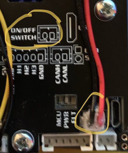

Anyone know the wiring off the top of their head for one of the halo led switches that people use for their esc?
Ive got a cheap FOCer with a power switch port, and I’m unsure how to wire it correctly for it to light up while the esc is on.
I’ve seen guys with the plug in switches, but those typically have 3 wires,
My switch has 5 wires (primary ones being n/c, n/o, and c) with the other two being power.
it depends on if its latching or mom switch, but both type can wire to NO and C, what esc is that
Esc:
Oh ok, so if I wire to n/c and c it will act as a proper switch.
Would I need to get separate power source to the switch for it to glow, or can I wire it to a 5v on the esc to power it?
It’s a latching led bulgin switch… :man_shrugging:

i don’t exactly know, but it looks like latching is the type used. and for the led, i would suggest u test while the esc is on state (BE VERY CAREFUL NOT TO SHORT ANYTHING), as the off state will be automactically trigger by the switch going to open state

It’s not even an actual switch to shut down power to the motor?? It just shuts down the drv

the switch is just there to cut power to the drv 5v rail, i don’t think it will be in the “off” state, its more like standby with 1.5mA draw
I’ll probably just go with a xt90s then.

Shutting down the DRV shuts down the 5V buck which shuts down the 3.3V supply which shuts down the MCU
