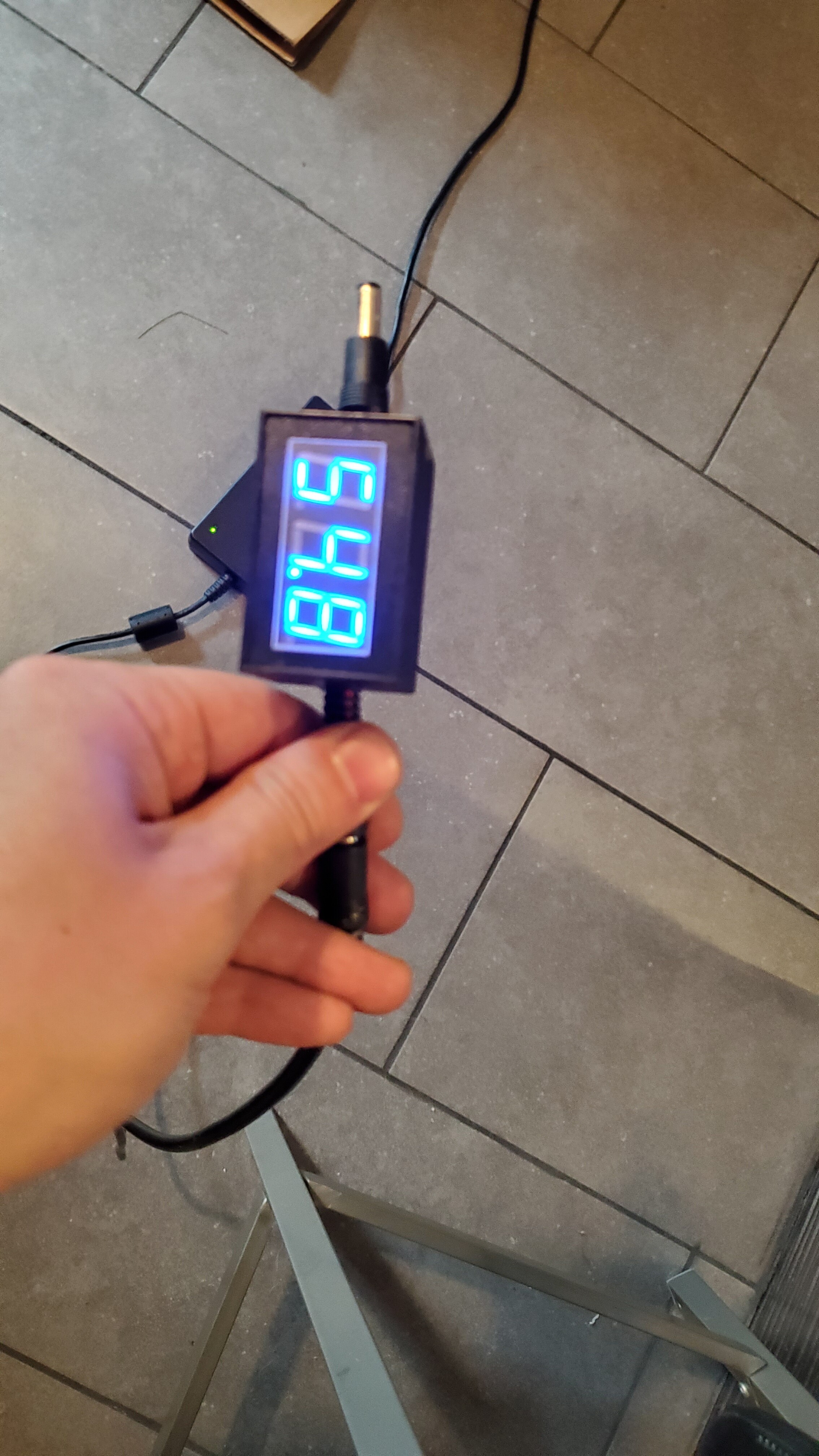

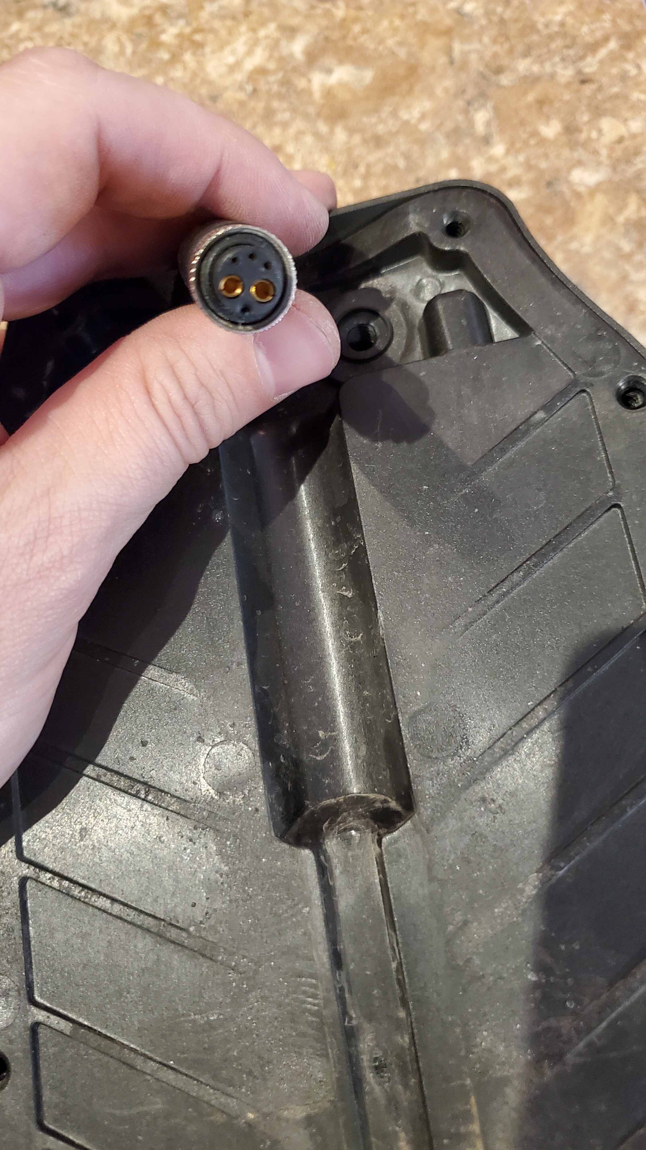

What’s weird is that the charge port is giving me 0.0V.
I took it apart a bit and measured across the 2 larger pins and still 0.0V :thinking:
Charger is good at least
BMS broke?

Trying to crack my way in there carefully. They glued the sucker shut and I had to run errands but we will see.
