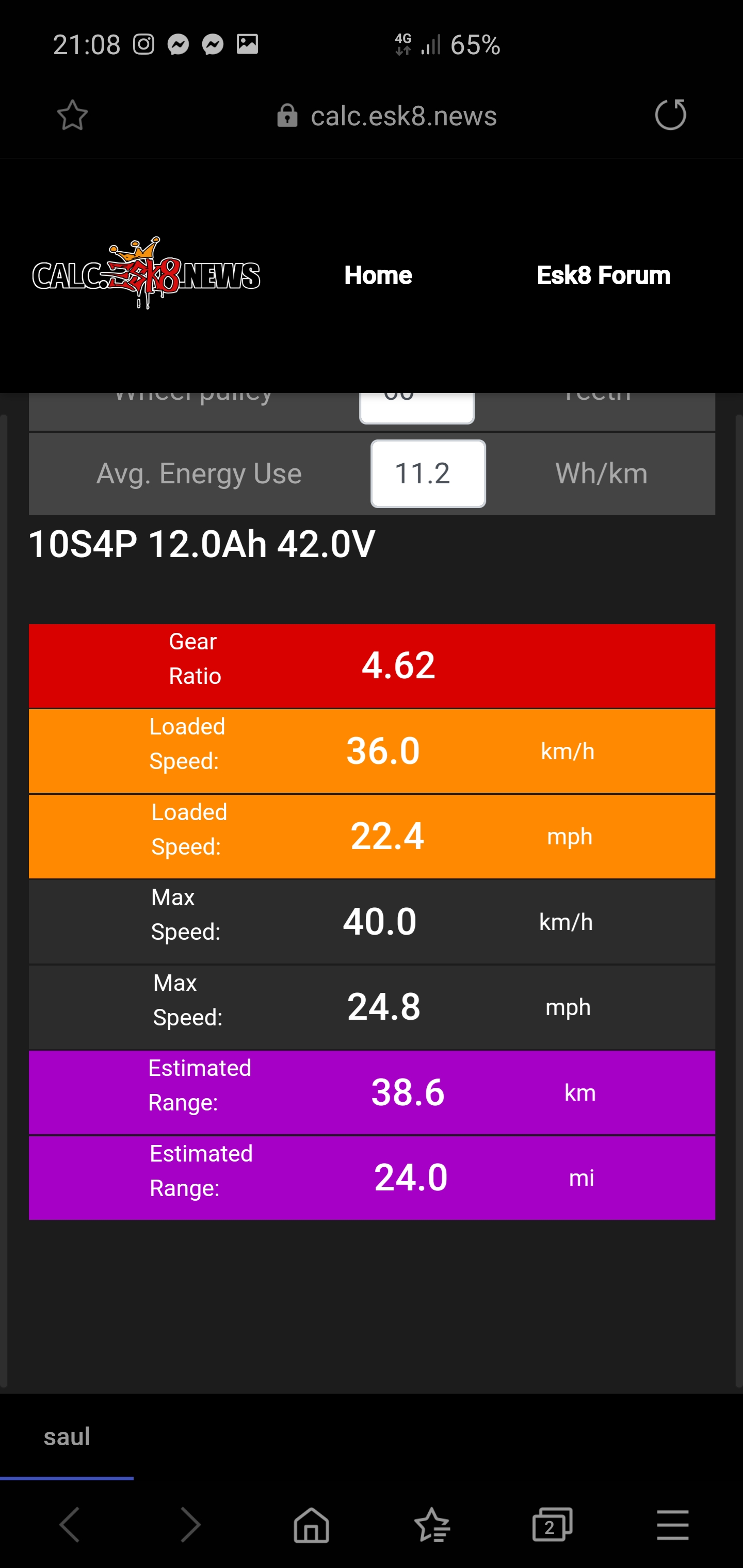

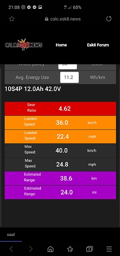

I think the part with the case is meant for the motor pulley.
A easy to source setup (for 110mm urethane wheels!) Would be 15t motor pulleys, 36t wheel pulleys (easiest to find, really) and leaving everything else as it is.
This will get you close to 47km/hr or 29mph at a decent acceleration.
Edit: i think using 18T pulleys would mean taking the covers out
Are these the specs of your board currently?
The realistic numbers are the loaded speed ones
Putting a 18T motor pulley will do you 30mph, at the cost of around -20~30% of the acceleration you were getting before

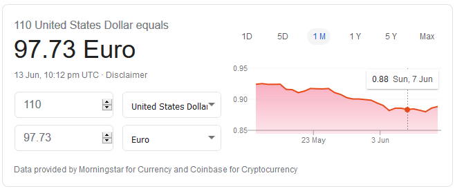

Brand new TB110 are 100eur new right?
eur
Yes but technically more like 150-170 with shipping and tax/duty fees.
Right I forget you guys get fucked on import.
