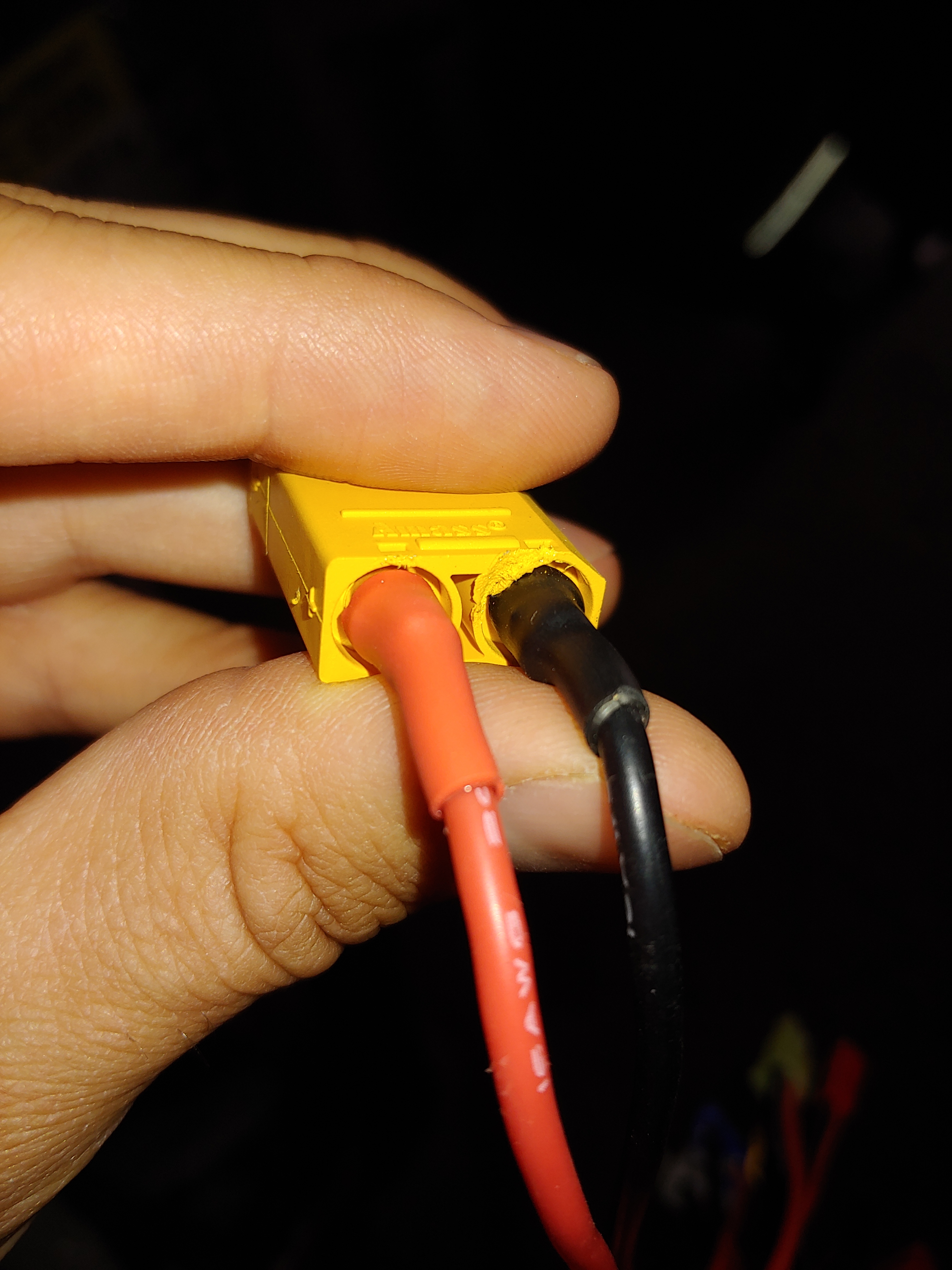

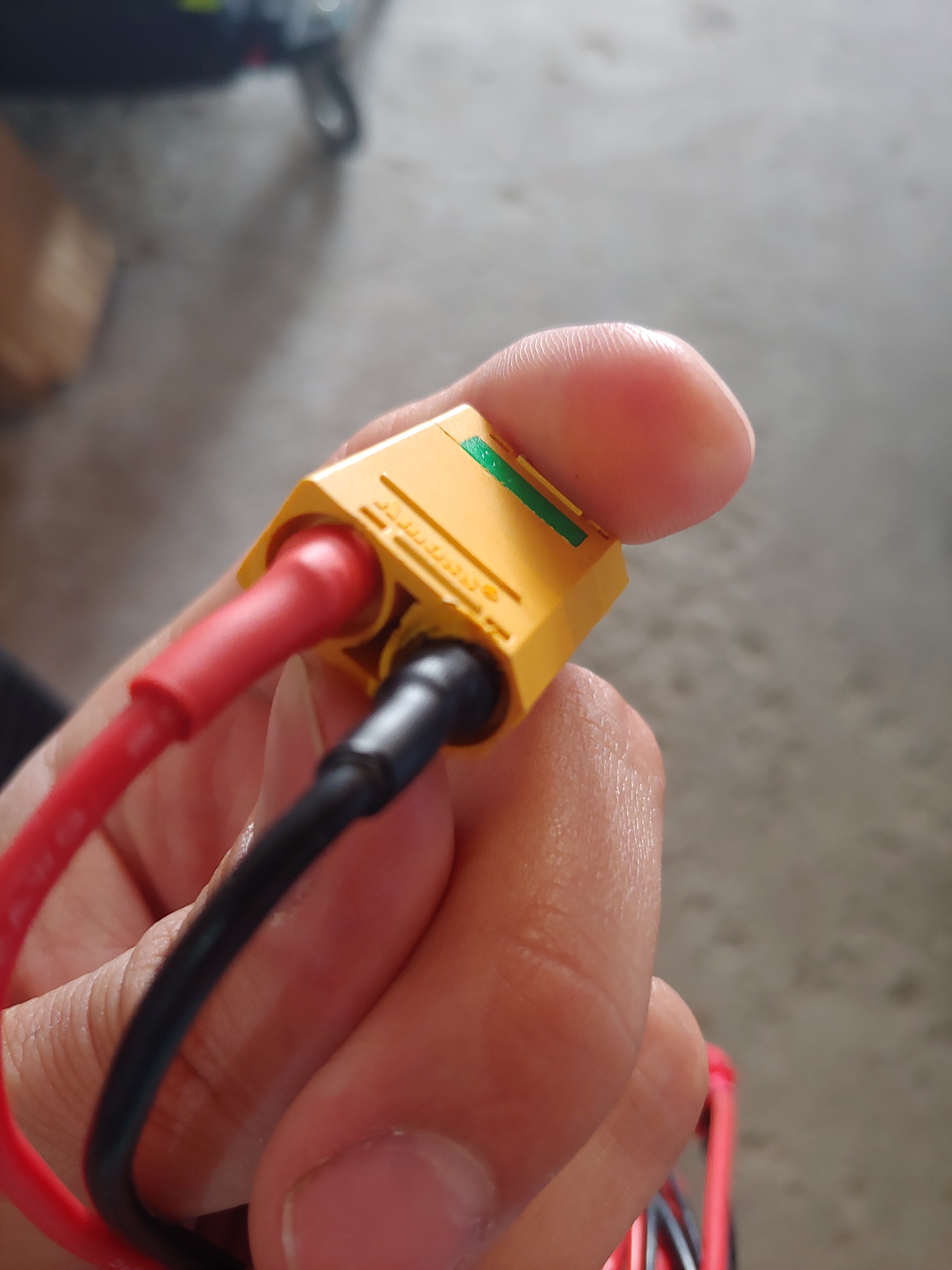

Hey all I seem to have melted a small part of the housing of an xt90 that I was soldering as my wife was rushing me (that’s my story mmkay?). I think it’s pretty minor and I’ve got shrink between it and the connections. Joints are good. Should I solder another on or can I just go with this one?

I’d run it brother. But honestly it’s just a couple minutes to swap it if you’re nervous.

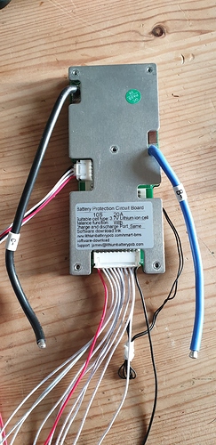

I’m having a proper brain fart, could you clarify what I need to connect to wire this charge only?
I get the balance wire bit, and C- to charge socket negative, but do I need to connect B- if B- is already connected to the balance connector point?

If you’re running it charge only, and
If it has a B0 balance wire (not all do), and
If you’ve double-checked with a multimeter 0.0Ω conductivity between B0 and B-, and
If the JST connecter is rated for your max charge current, and
If the balance wire AWG is rated for your max charge current, then
you can safely not connect the B- wire at all.
And don’t forget to fuse your charge port.
It’s really handy to only have the balance connector and one small charge negative wire connected to the BMS, but not always possible. Frequently, one of those requirements will not be met. Usually the 3A rating on the JST connector excludes all 4A charging setups.
Ya Imma run it. I knew it was pretty minor but better safe than sorry. Cheers and thx homie :facepunch:

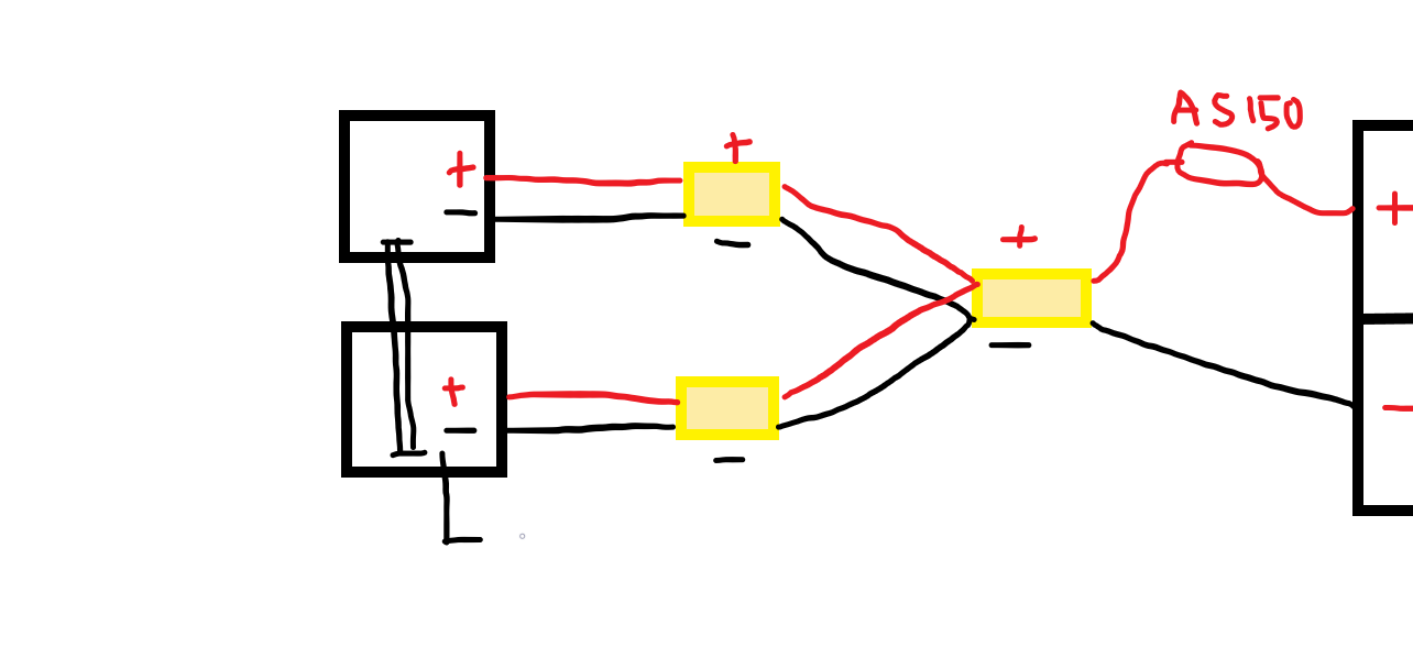

If space wouldn’t be the limiting factor it probably work really good.
I think going back to xt60 probably solves some of them… I’m never able to pull 90A anyways. I just like to have a buffer.
I abandoned XT90 (and 10AWG wire) a long time ago except where I need antispark feature, like on the loopkey.
XT60 is fiiiiiiine for all but the most extreme racing/offroad setup

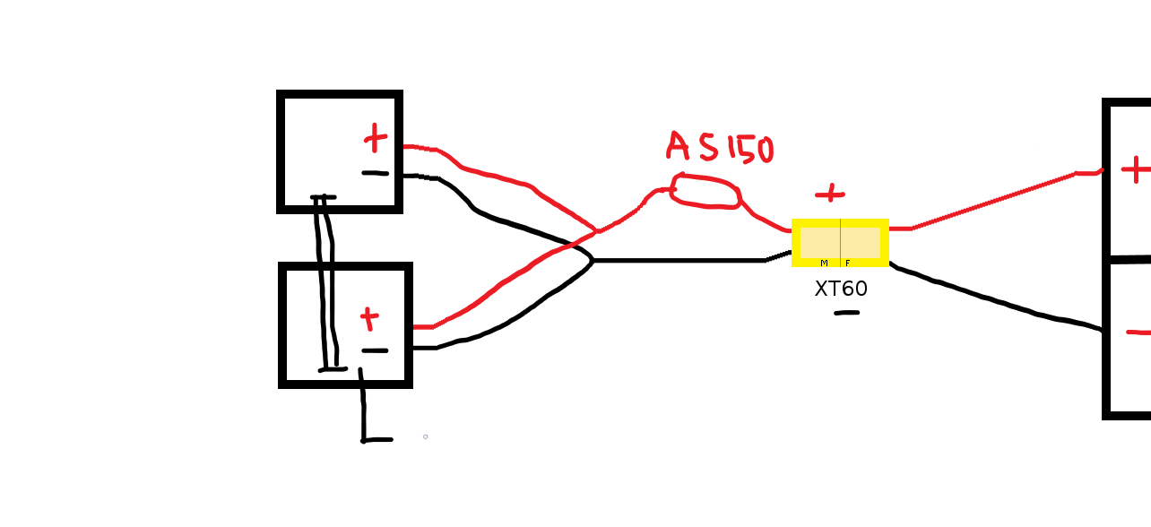

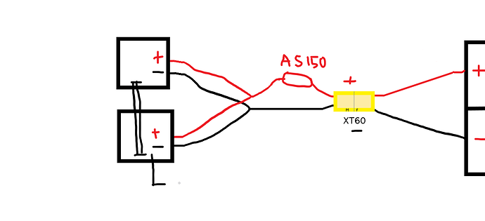

I would have more solder joints and only one XT connector, which is secured together with cable ties so it doesn’t vibrate apart. The female side of the XT60 is on the battery and the one with prongs is on the other side.
