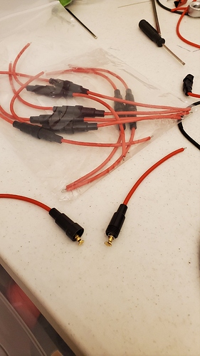

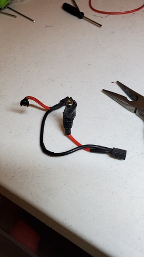

Why did this happen? Clearly something got too hot to keep working correctly… Would running a higher rated fuse keep it running cooler @MysticalDork or @b264?
I fused my charge port like a good boy using this fuse holder and 18ga wire.
The fuse was rated for 10A and didn’t blow… It’s still continuous. Just noticed my charger wasn’t charging my board.
Looks like the holder didnt allow as much heat/current as the wires connected to it and started melting
Yeah that part is apparent but why. It comes in a kit with several higher rated amperage fuses and should be able to handle more amps.
Really just focused on if using a higher amp rated fuse would affect heat at all.
@Venom121212
If the fuse itself has not blown, but the fuse holder melted, it indicates that the fuse holder was making poor contact with the fuse. Loose connections are common with poor quality fuse holders. Because they don’t make adequate contact with the fuse, they can allow dirt and dust to get in between the contact points - resulting in voltage drop.
Heating in an electrical circuit is always caused by current flowing through a resistance. If there is significant resistance in the contact between fuse and fuse holder, a current well below the fuse rating can cause enough heat to melt an inline fuse holder.
Note, this heating of the electrical fuse may not always be immediate. Whilst the initial resistance may be lower and the initial heating may not be enough to reach the fuse melting point, the heating can cause oxidation of the metal connections, leading to increased contact resistance.
This accelerates the heating effect until there is an “avalanche” of rapidly increasing heating/increasing resistance, leading to what may appear to be a sudden failure even some time after the installation.
TLDR: if the fuse holder melted, it is due to a lost connection

I have a shiiiit ton of these guys laying around so I’m going to try and fix them in place better with heat shrink to keep them from untwisting. Maybe even solder it to one spring and glue in place?
Yeah yeah blade fuses and epoxy I know…
@Venom121212 yes, I agree with @Flasher.
I have always soldered fuses into the circuit, typically automotive blade type fuses.
Maybe try one of these
Or I might just try soldering that glass fuse into the circuit, but be really quick about soldering to it. You don’t want to hold the iron on it, as it can melt the element inside. I’ve soldered to glass fuses before, just be quick about it, and pre-tin the wire, and touch and go.
LoL yes of course this :rofl:
But in your case I’d just solder that glass one in
I had the same thing happen on my bike, with the same type of holder.
I suspect that the holder itself got hot due to poor connections inside.
I replaced the holder, and before installing a fuse I took it apart and went over the crimps inside with some solder and flux, to make sure they’re solid.
I haven’t had an issue since.
tldr, probably not the fuse, but the holder.
