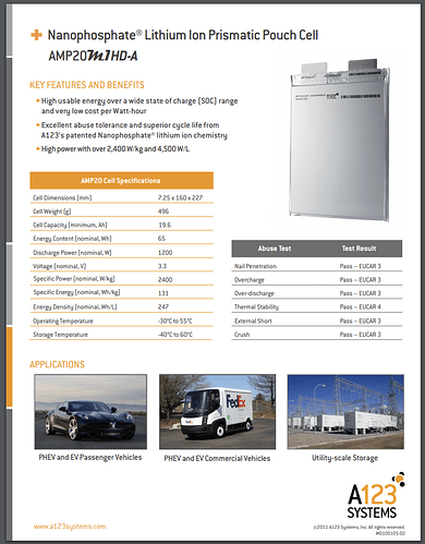

I was checking out some of the A123 offerings in their pouch cells, And it says 1200w nominal discharge, now does that mean that this cell can do (1200w/3.3v = 363a) ?
Or am I doing that wrong?
Sounds right to me. I don’t know if we should consider 363A to be a true continuous current rating but I’d be pretty confident that it can be pulsed that high…carefully…with the inevitable hit to its cycle life if done a lot.

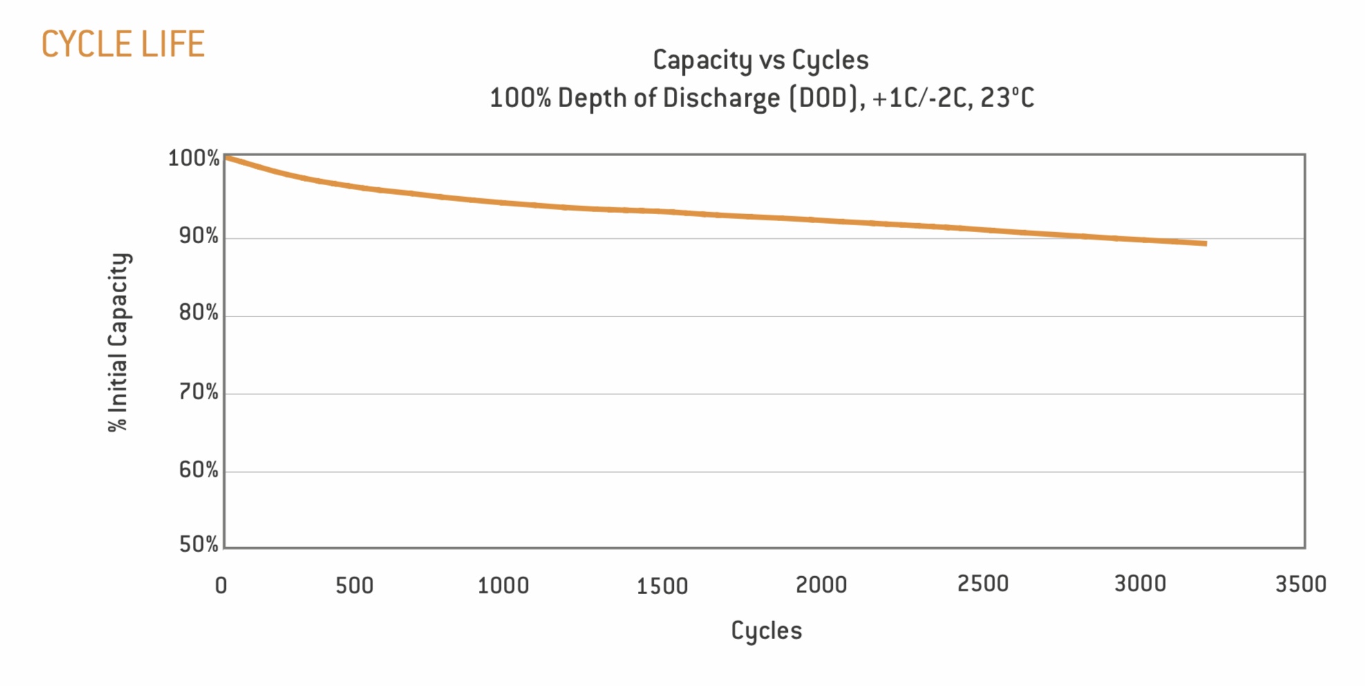

even so, They show 3000 cycles before it hits 90% of initial capacity… they just refuse to die! (Granted, they don’t show the discharge at which they tested that, but still)

20A charge, 40A discharge for their cycle life spec.
Oh yeah, “+1C/-2C”
good eye!
This is typical of LiFePO4 and my experience with other LiFePO4 cells are that they indeed seem to not die. Definitely it is noticeable compared to 4.2V cells.
