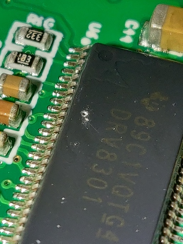

Something is up with my master vesc after it spat out an abs_ocercurrent fault.
It happened right after changing my battery from 10s to 12s and dropping my remote that was turned off.
I turned the board back on, tested the throttle and got the error. After checking some things i checked my connections and saw a bullet not 100% connected (was maybe 2mm away from being fully connected)
Pc via usb won’t connect and metr won’t either
Before it connected it blinked red 5 times slow and 5 times fast.
nothing burned or blown *visibly
Slave now is fucked too.
Metr worked, connecting to pc worked.
Motor detection via metr did not.
connected to pc all good.
Reflashed firmware - all good.
Restarted - all good.
connected to pc, started detection, motor just jittered until pc disconnected and then it: connects, disconnects, connects, disconnects and so on automatically. Now metr wont connect either
blinks red once every 5 seconds. DRV? No way to check faults.
No idea if this was present before ↓. Could be dirt when i applied the conformal coating? (looks a bit worse wince i tried to scrape it away)
Apart from that both vescs look normal. No interruptions in the conformal coating (checked with blacklight)
