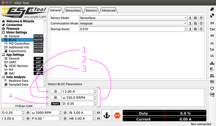

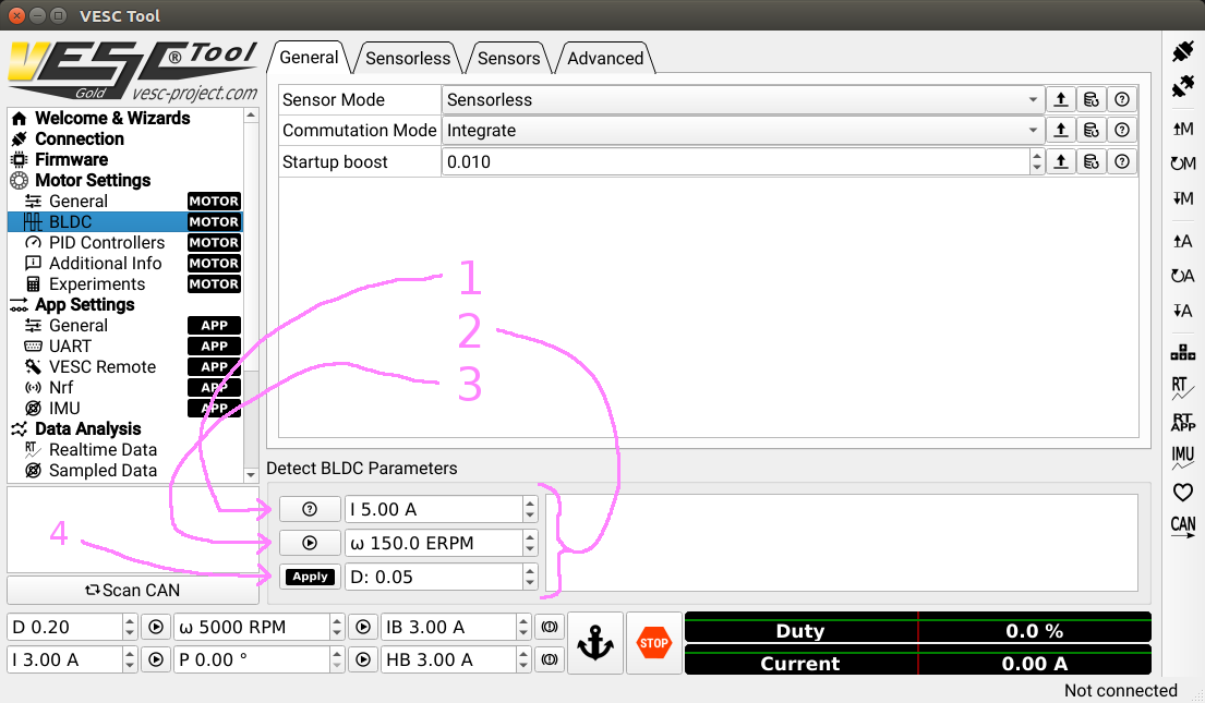

Jumping in with a new question. Is there a “For dummies” guide for running sensorless on a Unity? I’d really like to eliminate sensor based failure modes from the list of things that can throw me on my ass at speed.
I’m using the Unity app and don’t see any options for sensorless operation. I’m sure it will set itself to sensorless if I run motor detection w/ the sensors unplugged, but I’d like to leave them hooked up for troubleshooting and general data collection.
Are there commands I can enter via the terminal to make this happen? Do I need to use VESC Tool instead of the Unity app?
Yes the latest has full unity support with sensorless.
Cool. Do I have to do the whole HFI calibration thing or is there some sort of auto-config or wizard for that now?
Yes, you can run detection in BLDC mode, just go here
Do step 1 (important) then step 3, 2, 3, 4
Usually step 3 fails the first time. I typically have to increase I to 8A and ω to 300 and D to 0.12 to get a successful detection on a large motor (6374)

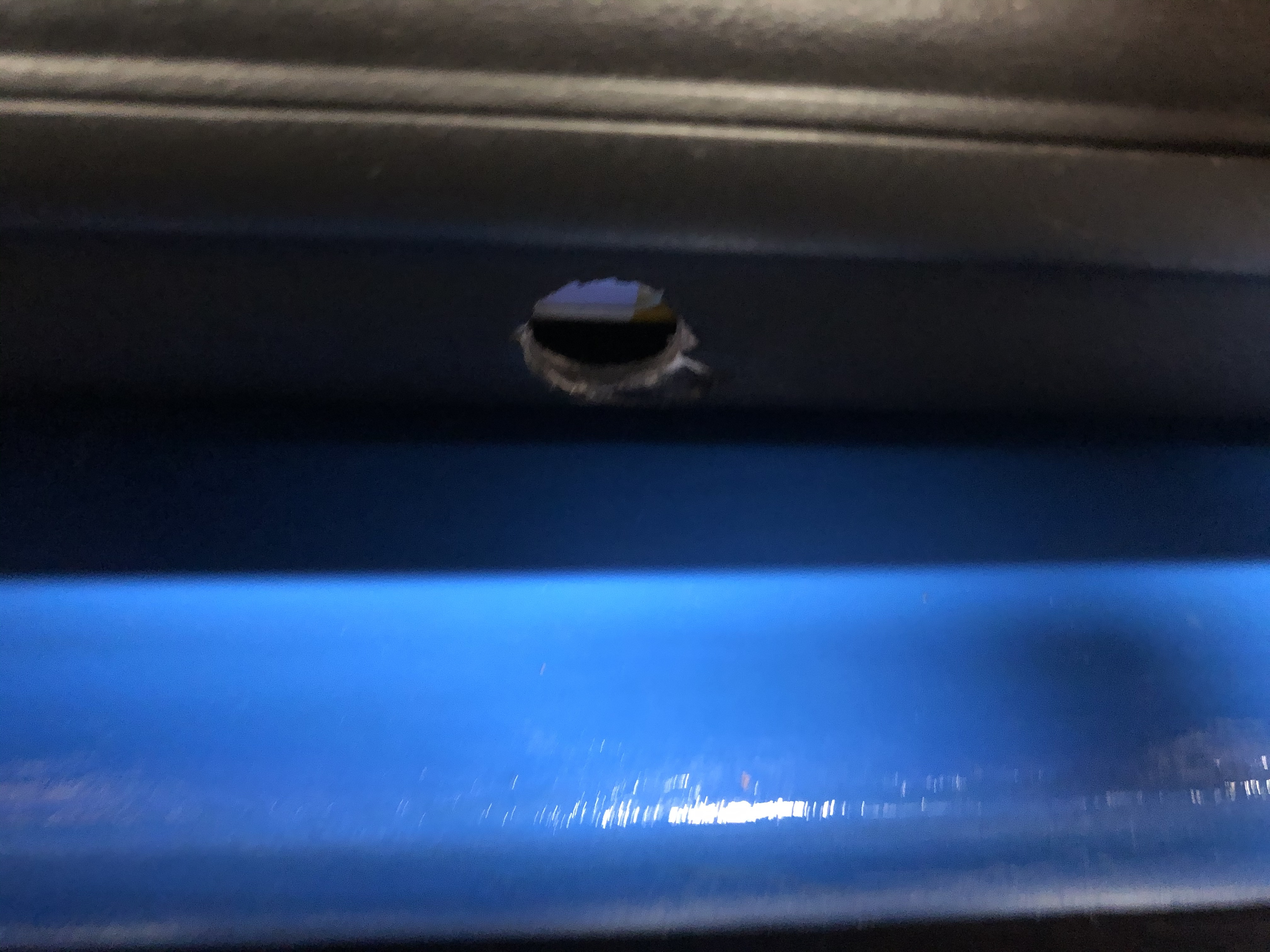

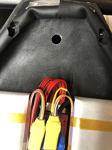

Any creative ways of covering up holes in the enclosure that I drilled but don’t use anymore? Is there like a cool little aluminum circle emblem that I can put on one of the holes in the center of my enclosure?
Like these?
What’s the enclosure made of?
Its the eboosted enclosure so i think fiberglass. These r some pics of the holes
