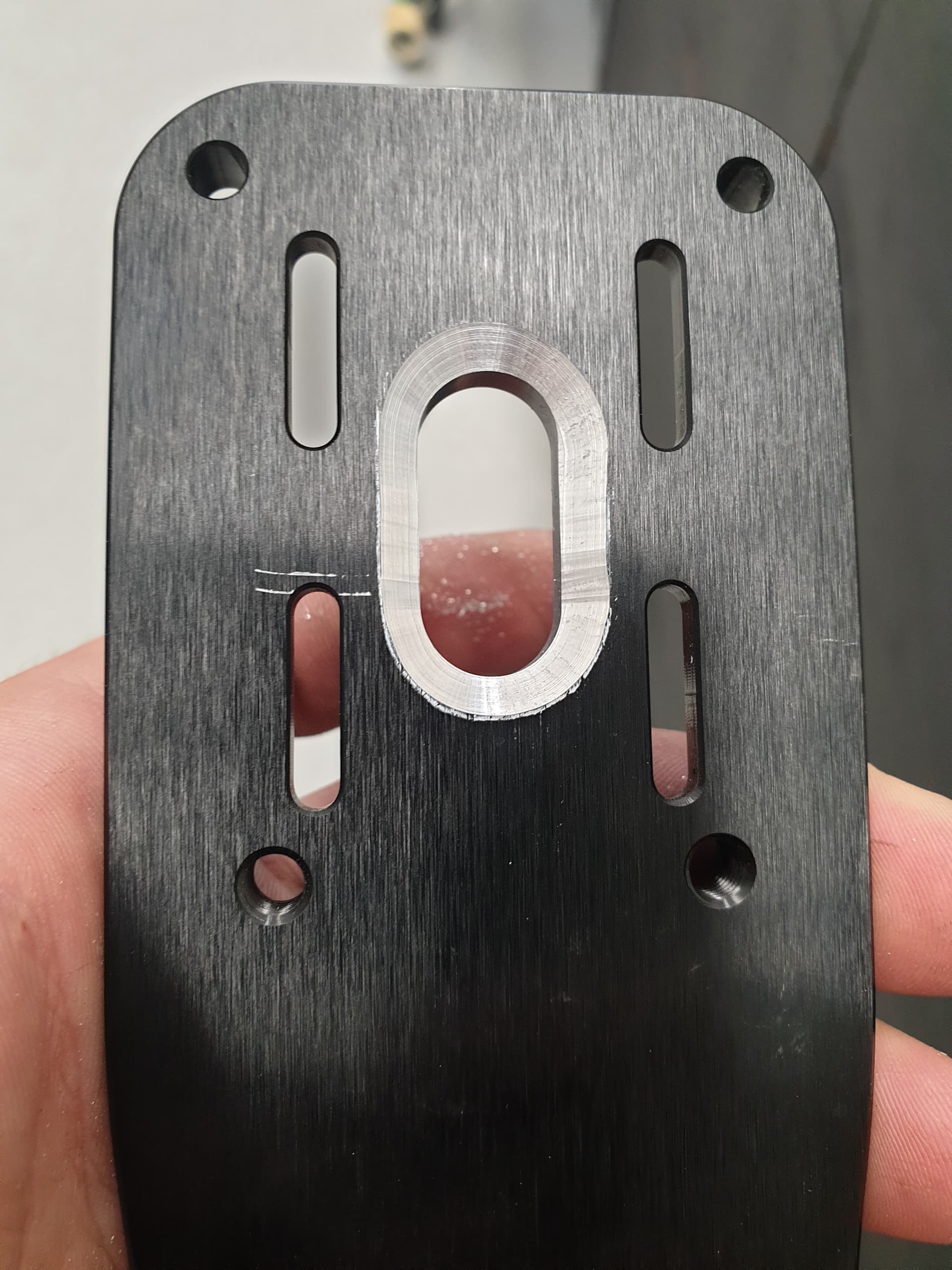

I thought my motor bearings needed oil - odd since they’re brand new.
Turns out the “whirring” noise is the motor c clip making contact with the boardnamics xl mount plate.
I see 3 options
  1. File down c clip (making it super difficult to service motor in future)
  2. Washers between motor and mount plate (eww)
  3. Dremel out a bit of the inside surface of xl mount plate.
I’m leaning toward the dremel option but I need some second opinions.
i would use washer to space it out, but im the lazy type :man_shrugging:t2:
File the mount away where the circlip touches it
Thanks Brian. It’s such a small amount of aluminum to remove, it will be a quick job with a dremel.
I recommend a cutting tool like a carbide burr, or a disposable abrasive like a sanding drum, rather than a mounted stone for grinding aluminum. The soft aluminum has a nasty tendency to gum up the spaces between abrasive particles on stones, and cause them to clog up, overheat, and in some extreme cases, crack and explode under the stress of high speed.
Not too big of a deal for a ten-gram dremel stone, but I’ve heard stories of that happening to bench grinders too.

Yeah, dremel’s carbide bits are definitely the way to go. I’ve had the same experience with their so called “grinding wheels”…
TBF aluminum will have that effect on most grinding wheels or cutting disks. You need to get specialized wheels for aluminum and other nonferrous metals.
I use the carbide burrs for nickel removal and its great, they don’t even wear out at all

I use a router with a chamfer bit on it
Good to know I’m not the only one. Your router job looks super clean. nicely done Al
I feel like @Boardnamics could help us out on future revisions of this product
