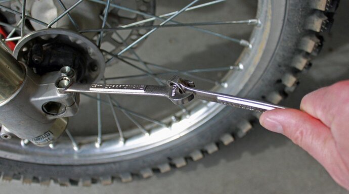

Tighten it down more. If it already is maxed out, are you sure that the mounts are compatible with your trucks?
Loctite 243 is good to secure screws.
They are maxed and they are compatible.
Not maxed yet. Still have a gap, so still a ways to go.
Use a pipe over the ratchet or two wrenches if you can’t turn it anymore.
Ok thanks I’ll try it.
