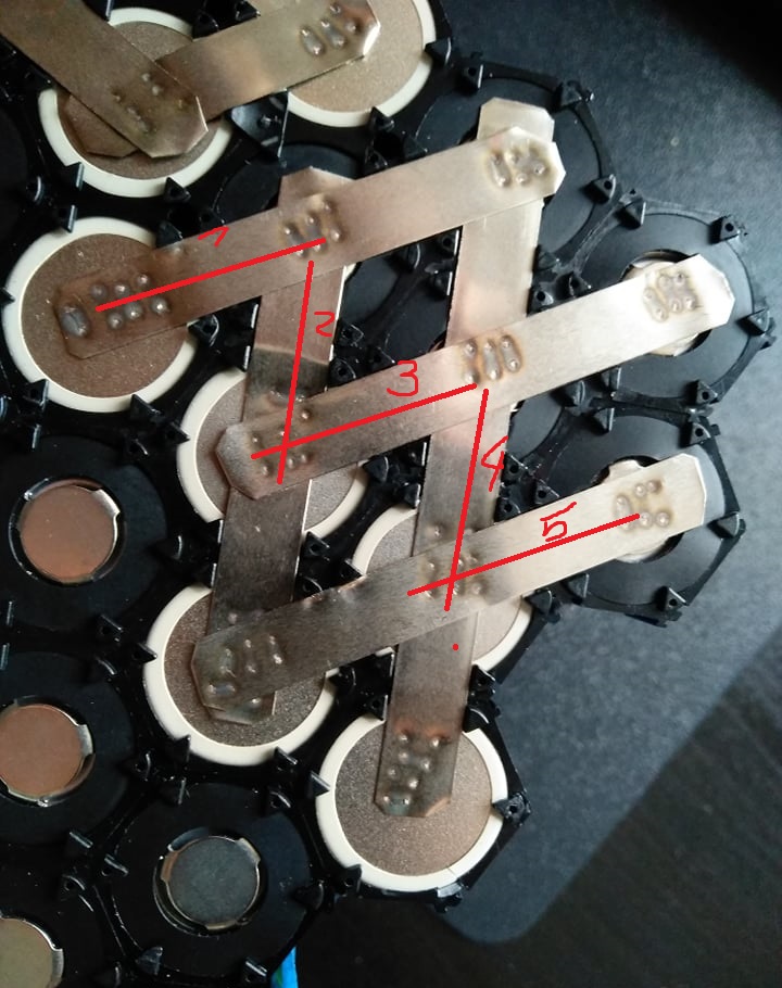

I tried to find answer but with no luck.
should it be counting as 5 nickel strips per 1 series?
its 0.2mm x 0.8mm = ~14A and multiplied by 5 = 70Amps?
Correct
I appreciate your help wise man :pray:

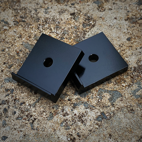

What’s the durometer of MBS matrix 2 shock blocks?
In particular what are the yellow and orange ones?
