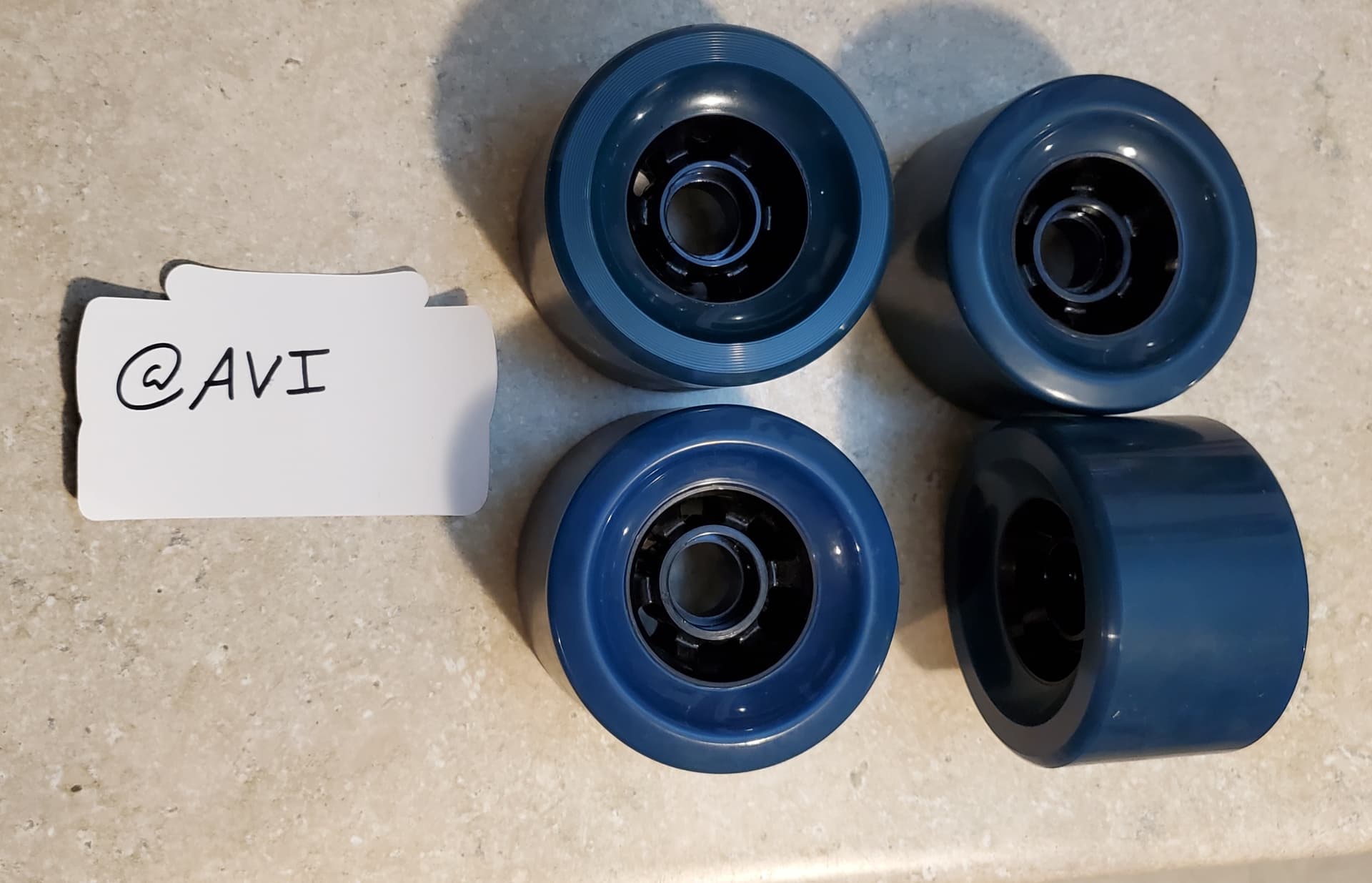

I’ve got a set of those ABEC clones of you want them. 83mm never used. $20 shipped.
I’m going to try sand paper first.
