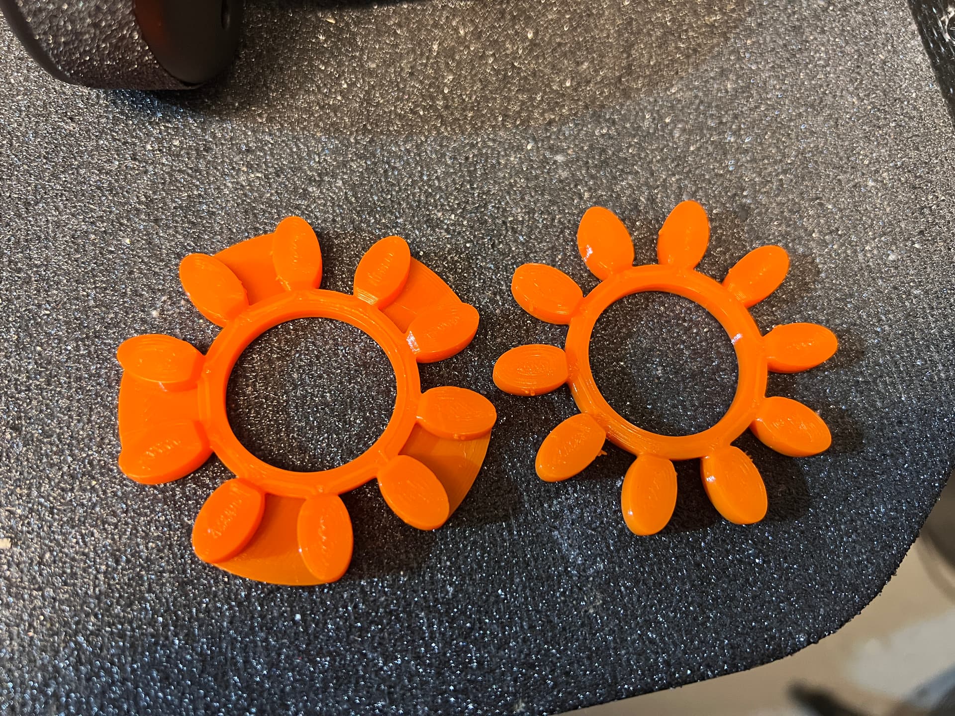

You can, you can replace it with ABS or PLA pad, make it as rigid. But yeah…more stress to the gear.
I will be taking my board with TPU printed shock pads for a ride this weekend- will report back how it goes. Upon comparison to the stock ones they feel basically the same. I printed one set at 100% infill and another at 80%.
Put 23 miles on my TPU printed pads and they held up without any issue :+1:t2: I had one “standard” one and one “flower” type design I did (just to fill in some of the gap)

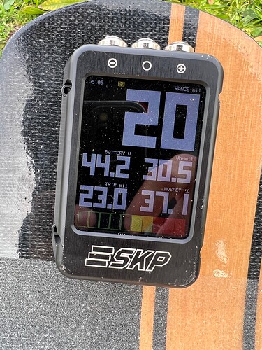

Just wondering to know before using the 4GS, whats you average consumption on your pervious set up? Because me and @2xbass are getting super low consumption with 4GS on
I don’t have anything else to compare to unfortunately. This is a brand new build with this setup. This ride was about 23 miles with not a ton of regenerative braking, pretty flat with a couple uphill spots. I’m about 215-220lb riding weight. It was also super windy with a lot of headwind which I would not be surprised if that made the board work a bit harder. My last ride that was a bit slower speed cruising (15-20) I got around 17-18wh/mi.

Actually I think especially given your weight, those numbers are very good. As an example I weigh about 140 lb and did a recent 70 km ride which was more cruising with an average speed of 30 km/h any my consumption was 10.6 km/h (same on Metr) on 9” tires. Your 17 Wh/mi is 10.57 Wh/km.

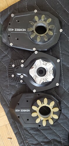

If anyone is curious about gear drive sizes, here are the Newbee 3.45 and 5.0 drives with the Apex Jump Drive in between. The Jump Drive is 5.5 but I believe the 4.0 is the same size.
Is 10mm keyway not possible?
It’s worth mentioning that the Newbee are pretty slim too, they look pretty small on the board
Also it’s worth mentioning, it’s 5.0 ratio not 5.5
Yes thanks for that. I corrected my post. I was getting confused with the Jump Drive which is 5.5.
