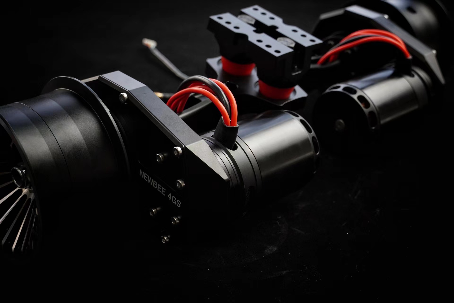

After a year of testing and 3 iterations, we’re proud to announce our final 4GS drive!

The NB Helical 4GS is a next-level gear drive for EMTB. They’re a novel design that maintains compatability with most hubs and trucks on the market. Unlike standard gear drives, the NB 4GS will provide you with the most smooth gear drive experiences on the market. It’s so smooth and quiet it’s hard to tell that you’re riding on gear drives!
Why 4 Gears?
  • Our 4 gear design can extend the lifespan of the gears since it improved the gear contacts and split the transfer power between the two slave gears!
  • 4 gears will give you a super quiet riding experience. Most of the noise you hear during the ride is from the motors!
  • 4 gears can provide you with a smoother riding experience than traditional 2 gear setups.
  • The 4GS drive gear position is fixed, so all the gears mesh perfectly. This keeps the gears healthy and reduces the chances of incorrectly setting them up.
  • During an efficiency test of the new 4GS, we were getting an average energy consumption as low as 10Wh/Km!(6384, 8-inch tire, rider weighted 75kg)

Looks gorgeous! Love that you’re using AC bearings everywhere too.

What guarantees the tooth mesh distance is right? I suppose these are fixed ratios?
Whatever instrument machines the gear box and also machines the gears must be extremely precise for fixed position gears to get the gear mesh right every time , if this works well it will be pretty impressive
These are fixed gear ratio, 55t and 38t is in the different housing. Gear mesh is all calculated perfectly in the design.

The product photos make it hard to see everything clearly with the black product against a black background. Might want to update the store page to include images where the product is extremely easy to see so that people can see it properly. Even more so for anyone with less than perfect vision or even just for people with displays that don’t handle all that black very well.
