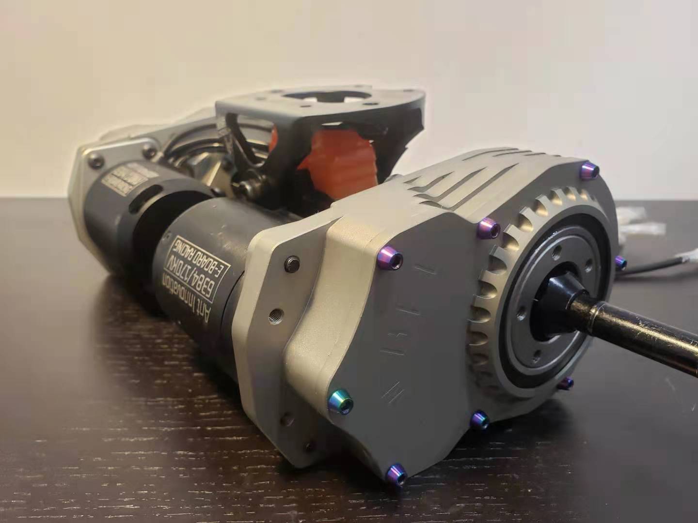

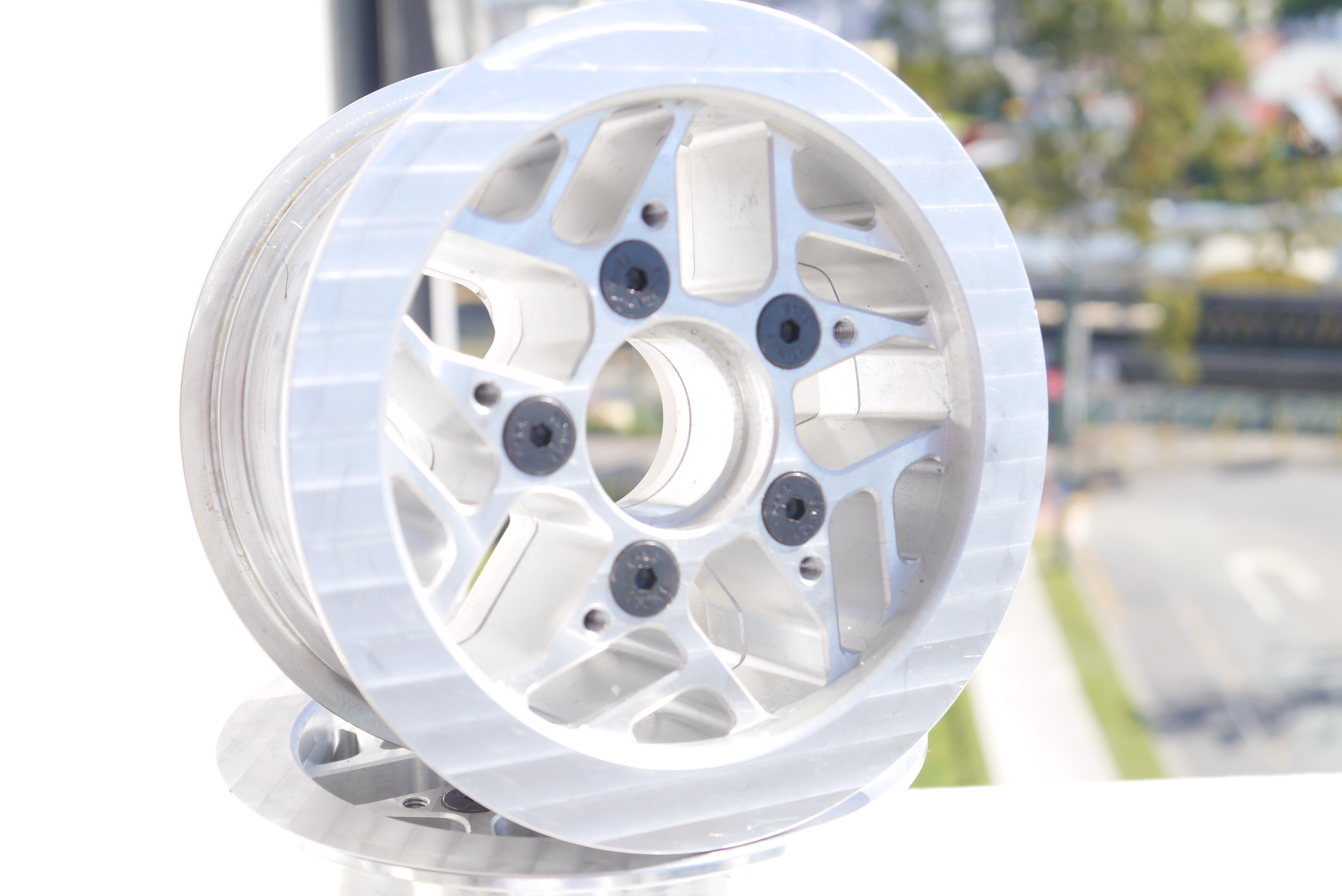

Hey, everyone.
(We invented a completely new gear system for esk8, I call it 4GS)
We applied this structure to MBS matrix 2 gear drive(currently it just prototype). Will open for sale after improved it.
We are looking for ideas and thoughts, please comment below
so here is the look like.
here more details:

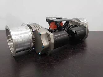

  • Whole gear drive housing is CNCed by Al6061 t6 & hard anodized
  • There 4 small angular contact bearings for slave gears.
  • 1 small angular contact bearing for motor gear
  • 1 big angular contact bearing & sealant bearing for wheel gear
  • Motor gear/ Wheel gear made by steel (will use pom wheel gear next version)
  • salve gear made by POM
  • Helical, 20mm widths gear
Feature design:

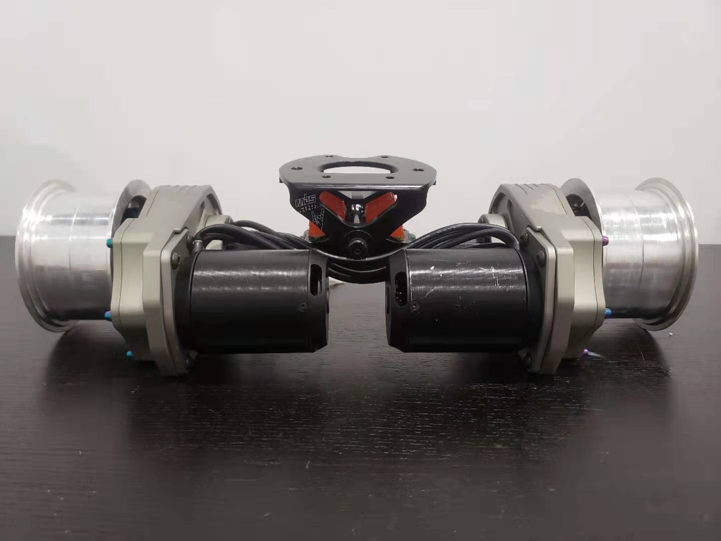

*Claw coupling for connecting gear drive and hubs, reduces the impact for gears when it running and it can quick release the hubs. (housing CNCed by al6061t6, padding printed by tpu)
*4 Gears can extend the gear use life, due it increased the gear contacts and divided the transfer power into two slave gears.
*Angular contact bearings for all the gears, made the gear drive running more precision
Pro of 4GS:
1: increased gear contacts
2: More durable
3. Running smooth and quiet
Cons:
Energy consumption increased a little bit, Around 2-3 Wh/KM probably.
Only compatible our pentagram hubs at this moment,

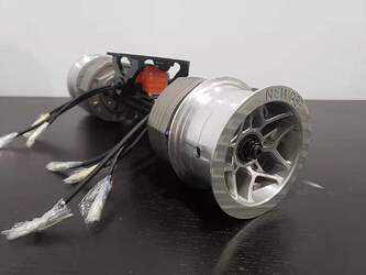

Pentagram hub is CNCed by al6061t6, 6-9 inch compatible
here the energy consumption test : May 7, 2021 - metr.at | 0fovy
test rider weight 60kg.
Test ride video: https://www.instagram.com/p/COkq--RBSWY/?igshid=1xhews5is1yq

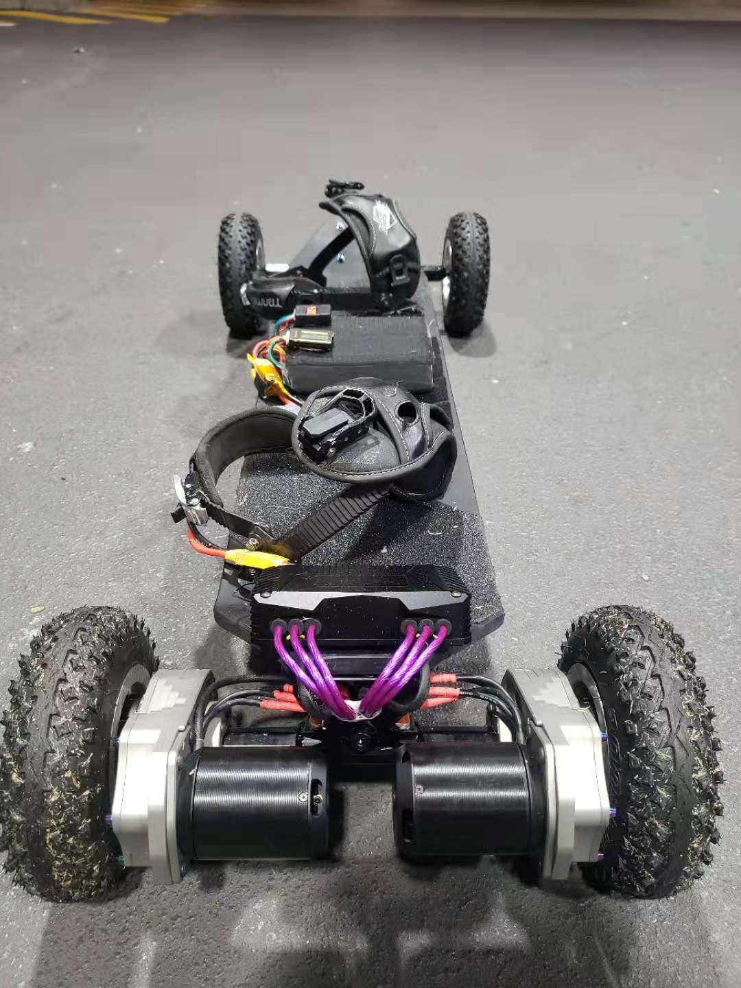

here the look on board:

Why would you downgrade the wheel gear to plastic if it’s steel now?
Are all the gears steel?
I love the aesthetics of these drives. I just worry about things getting caught in between my tires and my gear drives. I’d prefer flat screw heads slightly recessed. Though, this does look very nice.

I expected a 4-gear drive to have double the reduction, interesting to see a design like this! Having the motor further from the hanger would definitely be beneficial on RKP trucks / urethane drives. Not sure why that was needed for Matrix 2, but cool!
How do you make sure both middle gears are engaged instead of just one?

There are a number of reasons why Acetal plastics are a great choice in wheel gear at this scale of application.
Not really accurate to call it a downgrade, just a specific material choice that brings certain pros/cons vs steel on steel (which has it’s own pros/cons).
@Ean.esk8 this design looks great! Super excited to see how this works out, and always fun to see new ideas in the mix.
@Ean.esk8 does that mbs bolt pattern match the etoxx v3 hub pattern? 5bolt, 40mm pitch?
