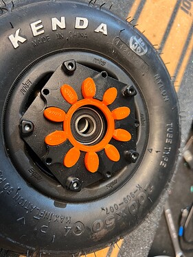

I love how my 55/11 rides. I did somehow nuke a shock absorbing pad… I only have around 20 miles on my new board. Newbee helped me out and I was able to print a new TPU pad and get going again.
@Ean.esk8 what do you anticipate would happen if this compliant star thing was removed and replaced with something rigid? would the gears die in a situation like whatever happened to @AlexB ?
Is there a particular reason you would want to alter the design like that?
I don’t think anything good could possibly come out of that, personally. If it doesn’t break something it for sure makes it less resilient
i would assume that star piece is supposed to absorb the shock load the wheel put into the drive to minimize the chance of breaking. having something rigid in place could potientially increase the chance of gear breaking.
my 2c
They absorb pad is mean for absorb amount of torque that happening in instant, also it can fix amount of tolerance when people assemble the drives to the truck, especially not all trucks are CNC’d…so overall make it as an soft pad can extend the gear dirve use-life.
For the reason why the polyurethane pad would break…i already explained to the @AlexB.
This is the hand moulded pad, which the quality might get effect by temperatures, proportion of the furmula etc…i will include some spares for the new orders.

Yeah, I understand the general purpose of the star things. My apologies, I think I phrased my question poorly.
What I meant to ask is:
How close to the limit of the gear’s strength are the “absorbing stars” designed to fail? Significantly earlier, or just slightly earlier?
I imagine it could be hard to get it really close given the inherent inconsistencies of FDM printed plastic.
So no one has totally broken one of these yet?
Those “star thing” is made for wear out, so if the star thing broke, doesn’t mean it is close to break the gear…the absorb pad is an additional protection.
What causes the “wear”? Cyclical loading fatigue?
I believe what causes the wear is the cyclical Impact Loading. As you know the coupling design is sort of soft connection, if the power that transmit in instant…the absorb pad will get deform, you can consider it as a squeeze in between the wheel & gear drive. And it happens every time when you brake hard or accelerate hard.
Would it be fine to ride without it? I would assume it means more stress on the parts?
