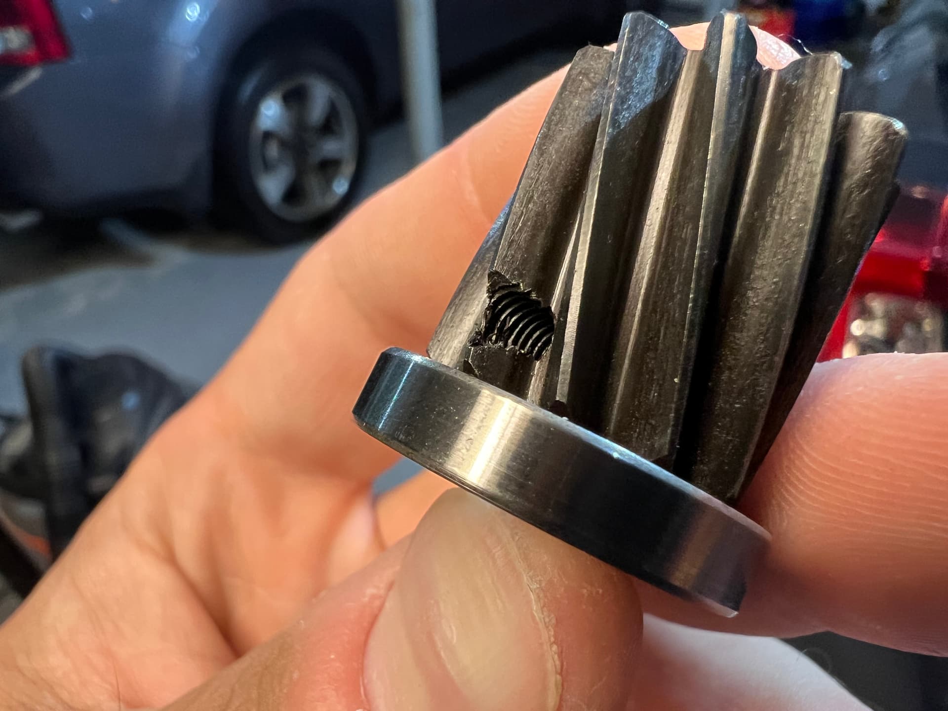

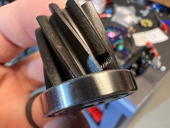

These fkn motor gear grub screws are going to be the death of me. I managed to get one set in one gear ok, but this second gear is very challenging. The threaded hole goes through half of a gear tooth so one side of it is wide open. Horrendous to try and thread one of the grub screws into without mashing it up. I managed to drop one on my garage floor (RIP) so I have 3 left. One of these is already looking not so great. Not optimistic about my chances :sweat_smile:

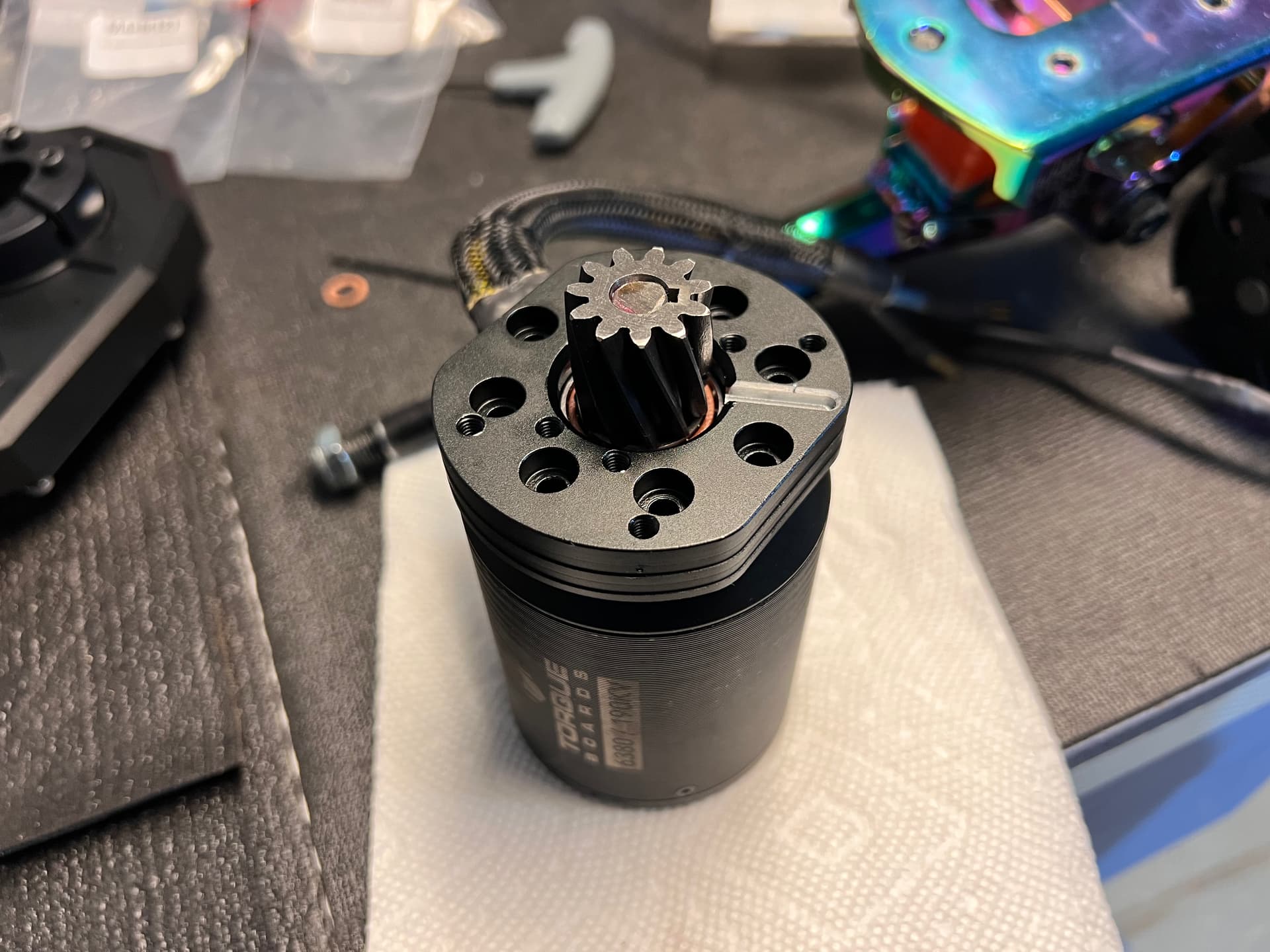

Is there some sort of bearing seat the gearing gets pressed into?
Dear god I actually got it. I had a spare M4x20 screw kicking around here that I “practiced” with. It helped clean out the threads once I got it in and made it way easier to thread the grub screws in.

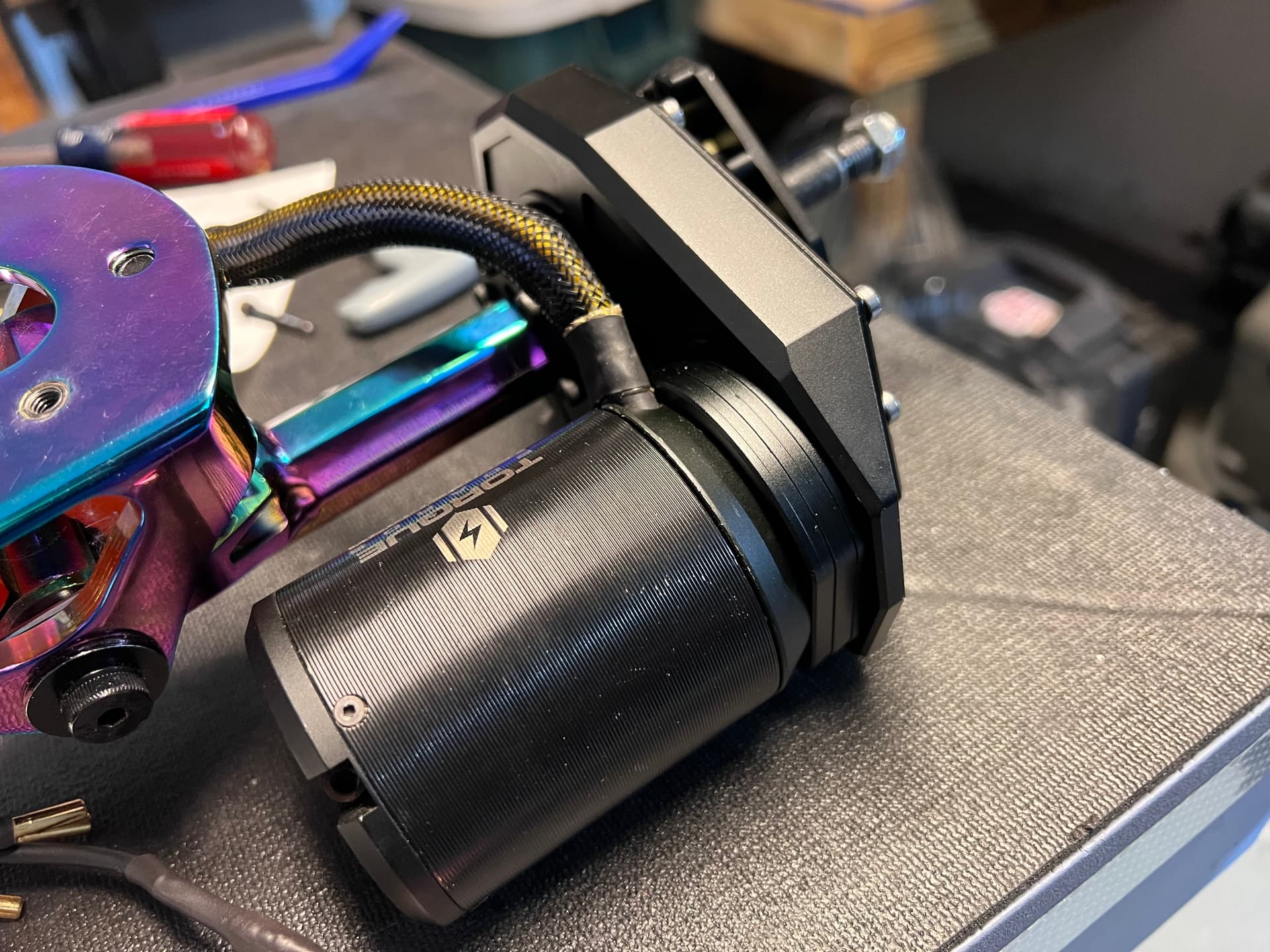

@Skyart the gear and bearing sits in a motor mount plate that gets bolted to the main drive.

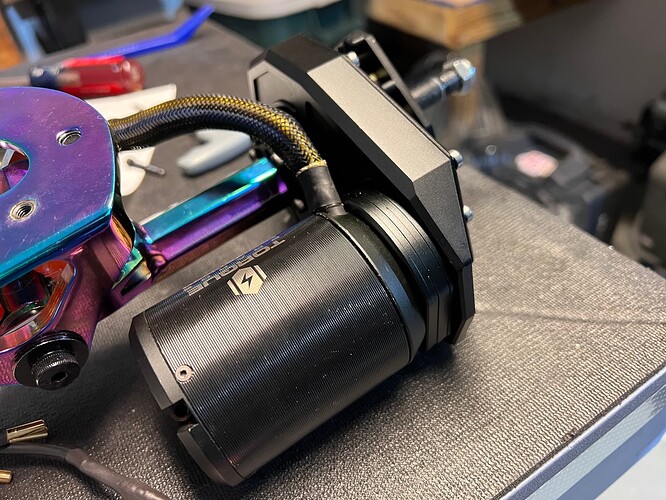

All dressed up and nowhere to go
Ya this was horrible lol

On the screws or motor shaft? Using a longer M4 screw to get the right angle etc was a big help for me.
On the motor shaft, I left off the setscrews on mine

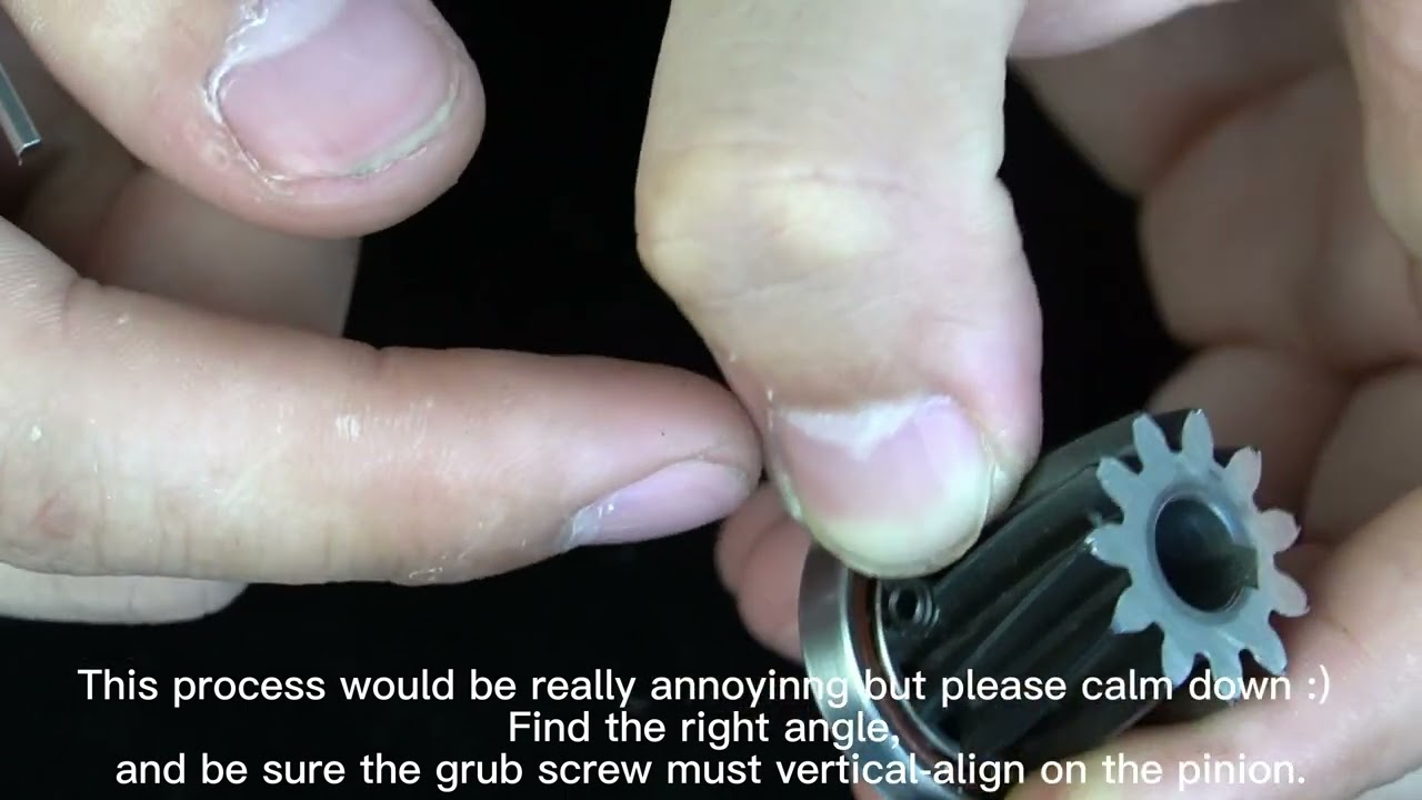

Hope this video would help, use you thumb against to the grub screw, make sure it won’t move…then it all about align it straight.
Yeah I definitely tried this. It worked on one of the screws on the first gear but the second gear had holes that were much more open on one side and the thumb didn’t really cut it. I had to use a utility knife and put the blade between the teeth next to the hole to give the screw a much more rigid surface to push against and eventually it worked. Not easy that’s for sure, but got them eventually.
I think the long bolt idea is excellent. Gives a good visual representation of the axis of the thread
