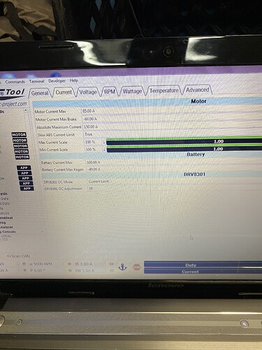

My settings are usually as follows(I added a picture as well)
-0.0 Second positive ramp time(I like it snappy, could this cause issues? Even if I keep default settings it will still cut out when riding on hard acceleration)
-85A Motor Current Max (I know its high, typically I ride on a softer setting, only kicking it up for some short hard accelerations)
-100A Battery Current Max (10P 30Q should handle it especially since I only do short bursts and probably never reach that in battery amps)
My problem is that the board cuts out on hard acceleration when in the high setting. Placing it in lower settings such as medium or low (75% and 50% motor max) work without any issues. I added a video that shows the before and after. You can see in the first clip with my original chip, the board is very snappy and immediately hits top speed when flicking the throttle. Then in the next clip you can see the board working fine on a low setting and then cutting out on the higher setting. I can be in the high setting and slowly move it up to speed, but trying to go full throttle if not already moving fast will usually kill it for a second. Lastly, a video of the chip itself working fine in low settings and then cutting out in high settings. Sometimes one vesc will cut out and the other will run, this is a bit more rare though.
It’s weird as I believe I have all the same old settings. If you know any that may cause this, please let me know. I can climb hills and drive all around perfectly fine on low motor amp settings, but its really killing me to not be able to blast up a hill or take off on smooth streets. Any ideas on how to get back my high power?
tl;dr: - Board cuts out on high amp settings despite working on such settings in the past without issue. I believe my amp settings should be high enough to not overcurrent fault. (85A Motor:100A Battery)

What you can do if it’s really caused by ABS overcurrent is to set the Absolute max current value up. Try something between 180-220A.

Even at ABS current set to 1000 on no limit firmware, it still happens. I set ABS current to something very low like 10A and the lights and motor symptoms are all the same. It cuts out the same way but even on low settings. Seems odd that even 1000A ABS current doesn’t fix it, but setting it to 10A ABS produces the symptoms as before.

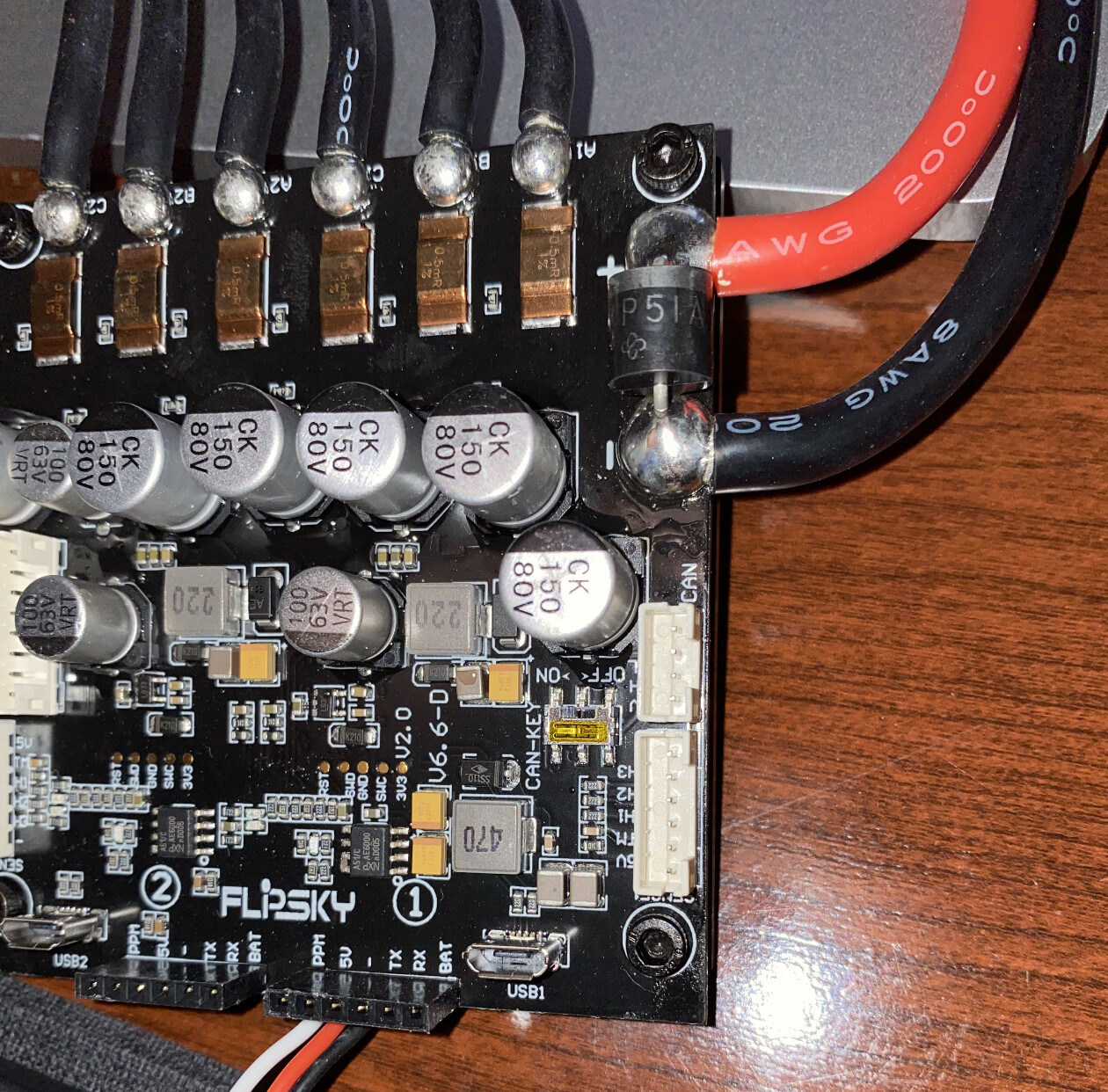

Here’s a picture of one of my buddies who actually had the diode I was talking about versus one of mine. You don’t think it will solve the issue?
I’m also wondering if it could be the xt90 connectors, I thought it was okay to use them as they were pretty much the same as using any 4.5mm bullet connector but in a different connector shape (basically). They are anti spark but I don’t think that should cause any issues, right?

The diode on the input has no effect.
