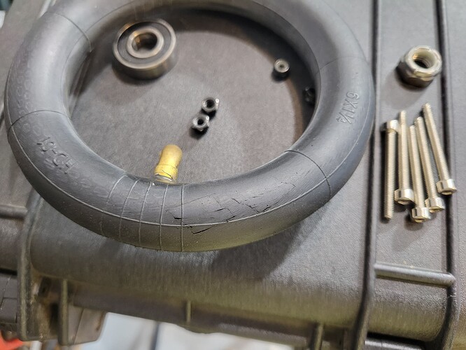

Has anyone tried these tires with bigger tubes? Maybe 6x2 or anything else bigger than the stock 6x1 1/4
Stock tubes seem great
I was just curious if beefier tubes could be helpful. I got two flats today (front right and back left) while on a short ride. I’ve put about 40 miles on the wheels total. I investigated the flats and saw that they weren’t caused by a puncture from an object. The tires were fine. Maybe lateral stress during deep carves?
What PSI are you running at? How fast were you going? And how much do you weigh?
40 psi. Carving around 20mph. Weight 200lbs. Mounted on MBS fivestar hubs
I’ve never had good luck with esk8 tires under 45mph, seem to always get flats, I’ve been riding at 50 psi on all my AT tires for the last 1.5 years and yet to get a flat
I love 40psi for the BKB tires and I am about 185lbs with my gear.
