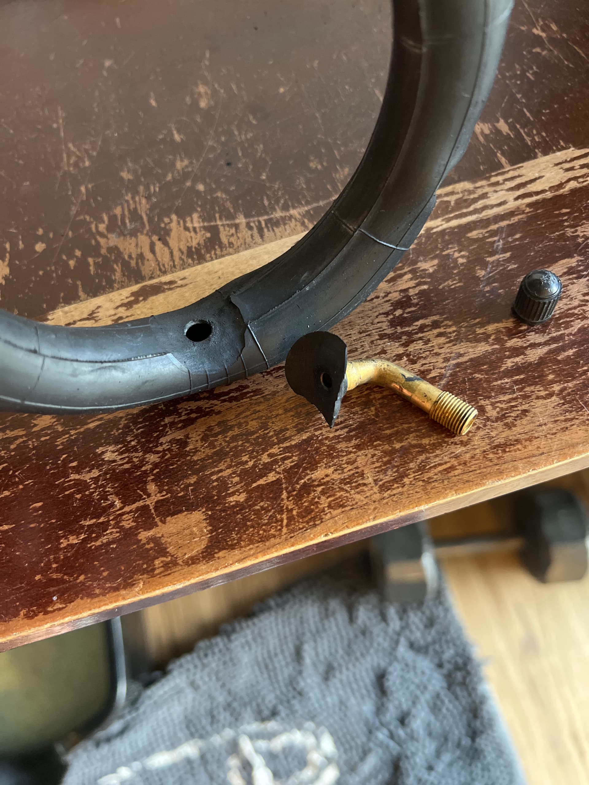

Are the inside of your tires completely clean and free from debris? Every time I buy new tires I wash out the insides really well. There is usually some crumbs and crap left over from manufacturing/shipping/etc that wind up inside the tire. Those crumbs will wear against the tube throughout your riding, eventually causing flats with no apparent cause.
Low PSI can also be an issue if you are pushing a lot of torque. For example, @JoeyZ5 got two flats at CarvePDX from running his tires at low pressure. His build was a 20s eMTB monster and he was cranking a shitload of torque, so eventually the tires spun on the rims enough to tear the valve stem out of the tube. I doubt that’s what’s happening to yours at 40PSI, but something to consider.

Just got back from a ride tonight same thing happened to me, haven’t pulled out the tube to inspect it yet. But I was also carving aggressively at 40 psi and now have a flat, was one of the rears. Interestingly I didn’t really notice it via feelings underfoot, but more when I was looking down and noticed the bead was sliding inwards too much. I also received one tire where there was already a hole in the tube. So I too am questioning the quality of the tubes, but maybe we’re outliers. Going to swap in an Evolve 6 inch tube and see how it goes.
Well that’ll certainly cause a flat
Actually I may have torn the valve stem myself, I found a separate hole on the tube. Guessing again from the carving.
