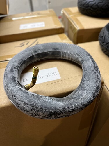

I had a similar in one of the tubes on one of my BKB’s. I swapped the tube for a Hota tube which is noticeably beefier feeling. I’ll probably swap the rest of them over to be safe.
Same just swapped in a Hota tube and agree it feels much beefier. Annnnnnnnnd just came home to the other side also being flat, other rear tire.
What size are your hota tubes?
They’re 150mm I believe, meant for 6 inch pneumies. Going to need to order more to switch over all my BKB tubes
I think they just say 150x50 on them. The BKB’s say 6 x 1-1/4” I believe

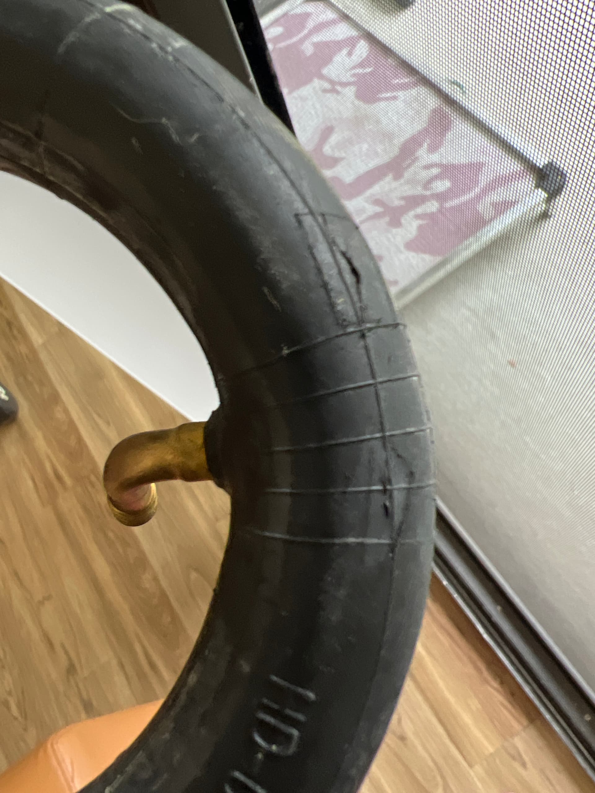

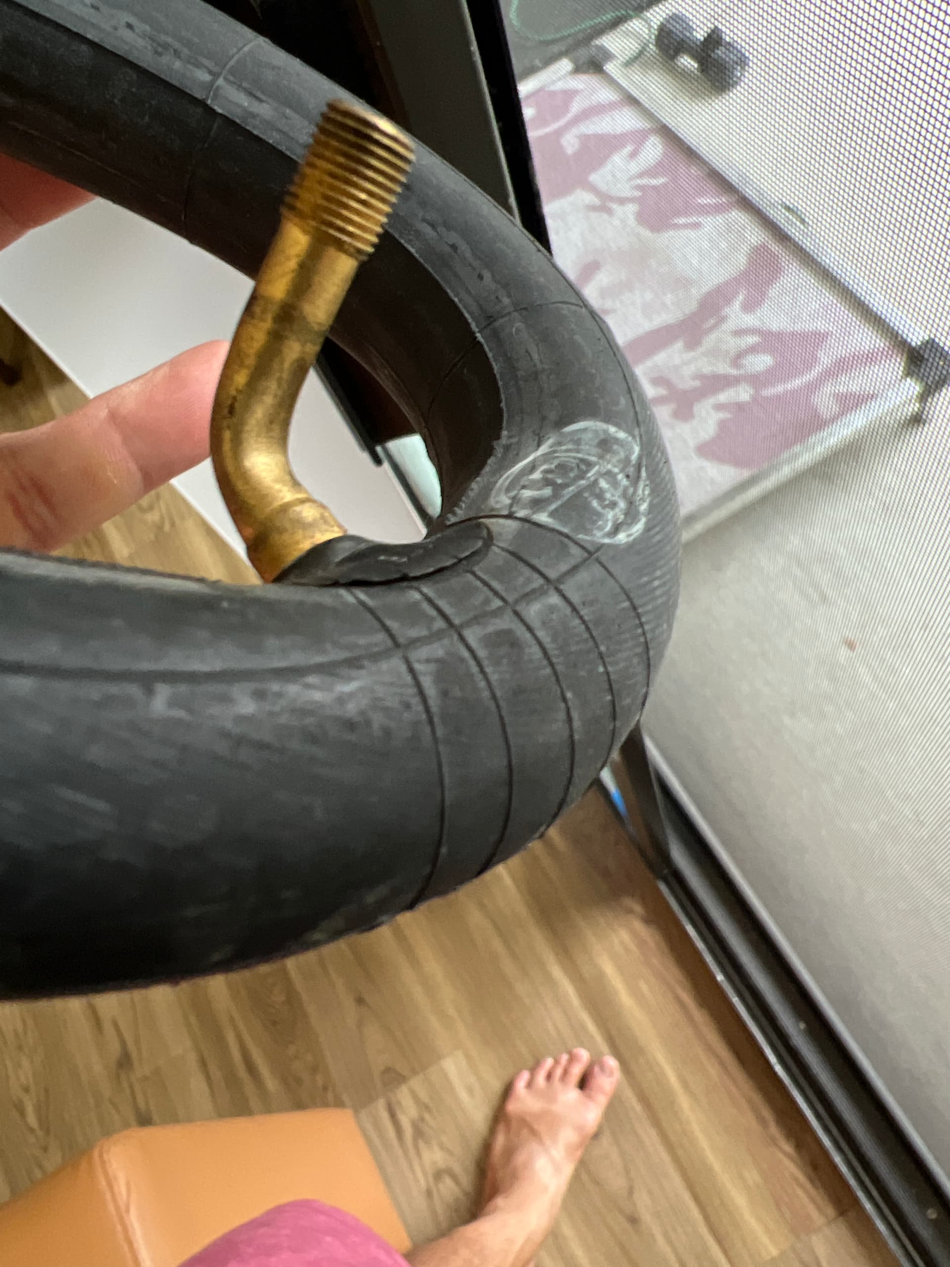

Ok in the second flat after last nights sesh I found again a tiny hole due to stress on the tube. Annnd looks like the valve stem is starting to peel.
So it seems like a good idea to just get Hota tube or some other 6 inch tube. Let’s see how long the Hota tubes last in these tires (hopefully more than 18 miles :grimacing:).

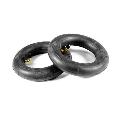

I buy tubes off aliexpress. If you aren’t in a rush, it’s usually the cheapest place to get them. If you want them quicker, backfire sells sets of 4, 150x50 tubes for pretty cheap.
meepo also sells hota tubes if anyone needs, probably not every brand sells hota tube tho
