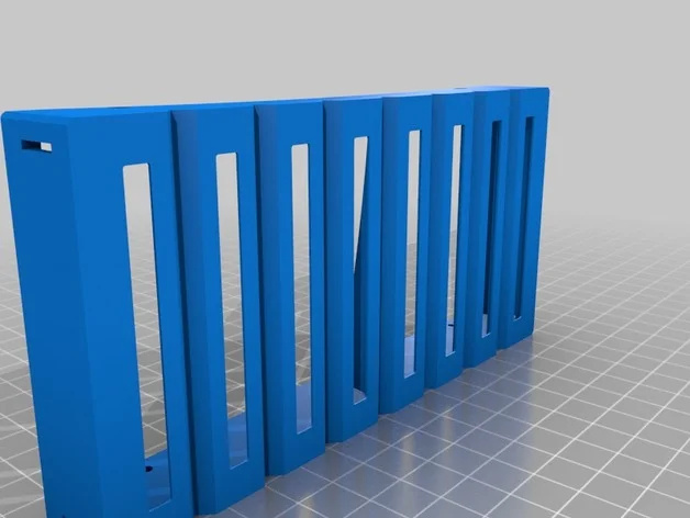

I recently opened my sealed enclosure to pair a new remote–old one got left in Uber-- and was super happy that after 1200km everything looks great. The NESE modules and the shock absorbing base have all survived.
I would have put more km on this system had I not made a second board(~400km on that one). That also has NESE, but custom boxes and without enclosure(I don’t ride it in rain). That seems to be going strong too.
If you have a 3D printer and can print in PETG or ABS, NESE is the way to go. My next project will use 21700 tabs.

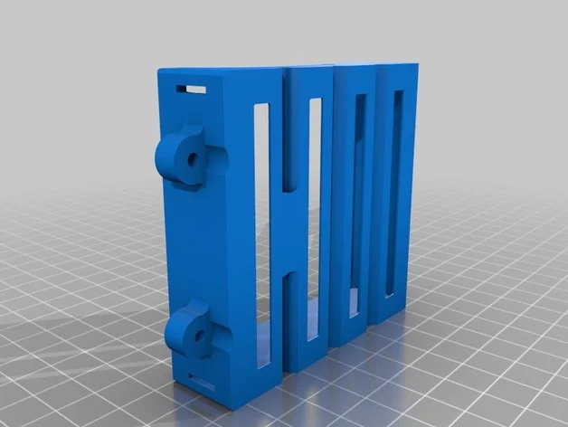

did you make the shock absorbing base? what did you use for it? i am currently putting together a 12s6p battery, but il have to double stack the nese packs and i am wondering what to use inbetween them for shock absorbing purposes.

The one with 1200km are your original modules that developed a slight crack(in the sharp corner which you have now fixed), but I had superglued it and has been fine.
The one with 400km are these ones below to be used with vibrations standoffs. I think for next time, I’ll just be using thick( or few layers) double sided tape.
