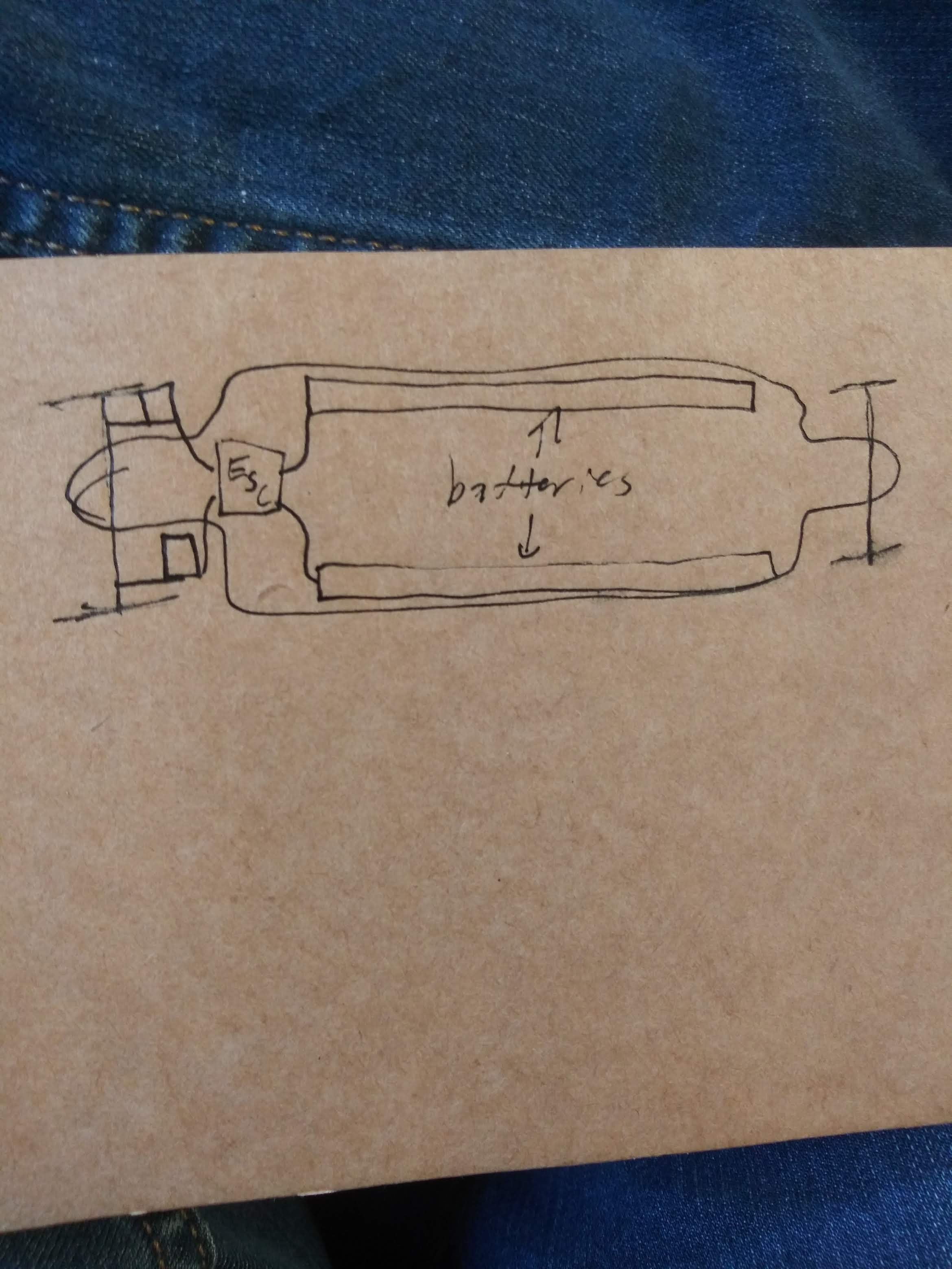

I am looking for a 10s. I don’t have a particular number for parallel but the longer the range the better. Is there a way to have them built in long vertical strips that can run down the edges of the board. Is all of this making sense?
sketch it. always better that way.
Hopefully this helps. I want to build a 2WD with 10S motors. I want to use a dropdeck because I love the feel of it but I am concerned about the size of the battery down below. I though wiring it like this would be pretty slick.
There are measurements on the page that you can look up under resources.
I must be going blind because I’m not seeing it.

Overall measurements are also on product page. Select module and under Additional information you will see dimensions. For all 18650 modules height and width is constant, H=22mm, W=74.4mm
Thanks. If you had the system in mind :slight_smile:
