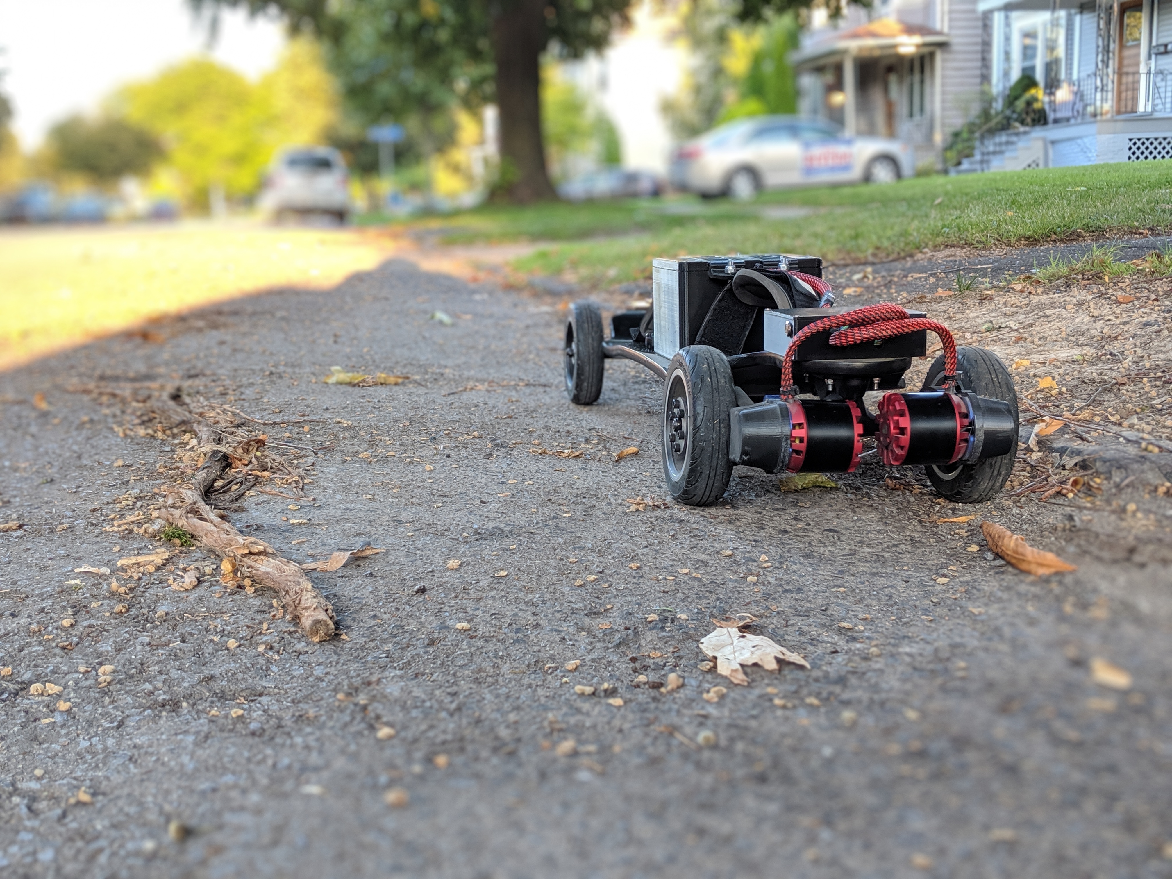

I think I’m the only one that has done the NESE in a top mount box situation so far

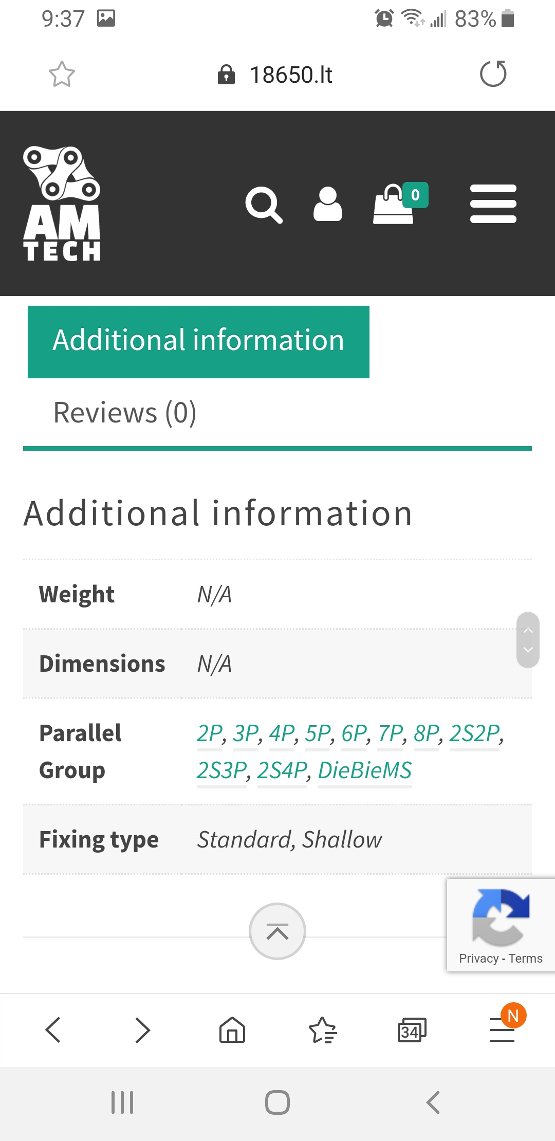

21700 how about measurments for those I couldn’t find them on site
Choose module at the shop, click on additional information:
That’s wierd doesn’t show up on mobile, thanks!
You have to pick the fixing type as well, size won’t show otherwise.

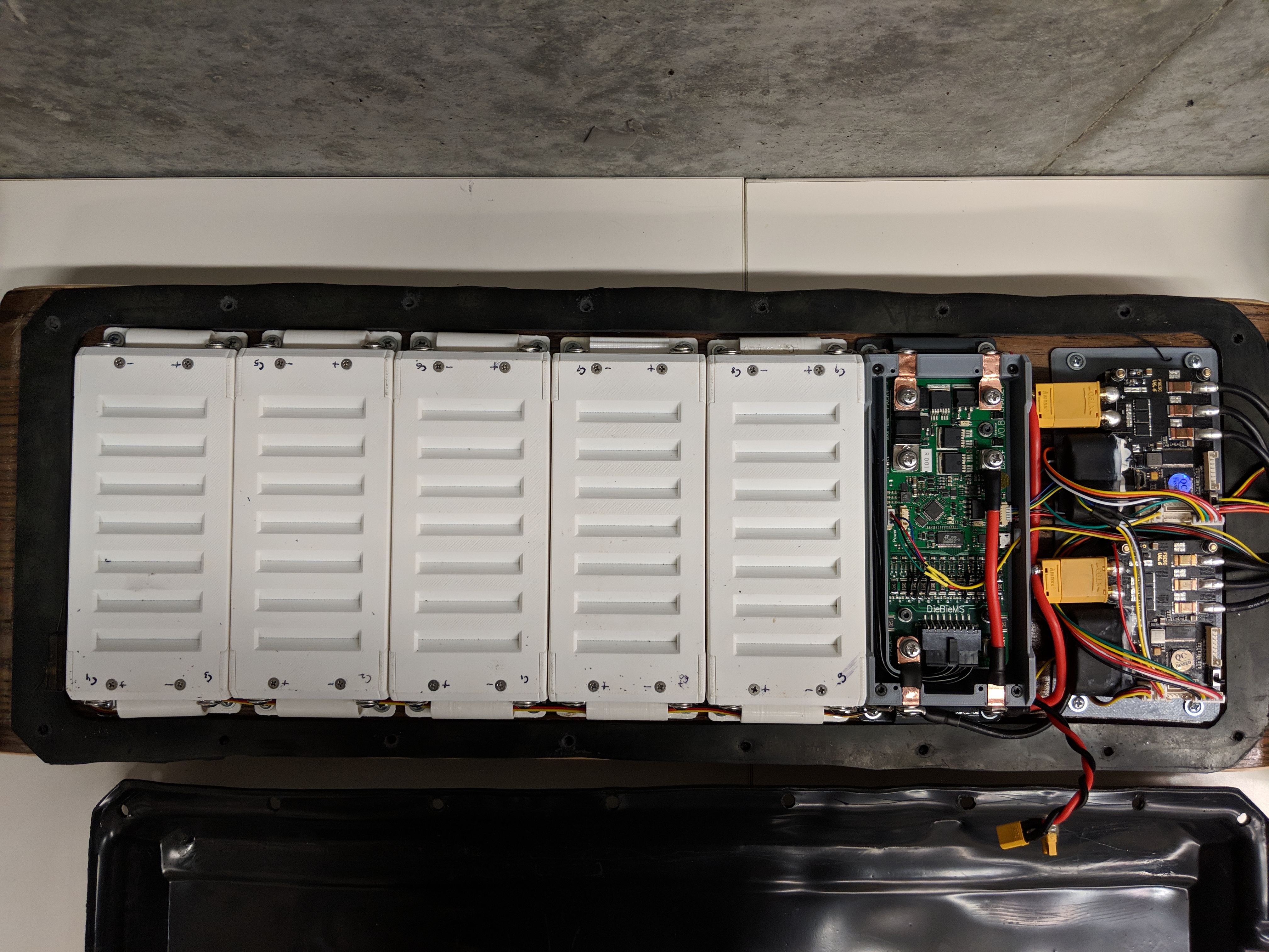

im getting confused as this shows his batteries stacked vertical in one stack. Where all other diagrams I see are 2 stacked ontop of each other.
(photo curtousy of @mishrasubhransu
I want to do a 10s3p with molicell p42a
And on the site the 21700 module’s i select 3p and it shows a 3 battery holder.
Wouldn’t it be easier to do less boxes and do them verticle?
Which boxes would i order?
Would a 6s holder be possible? Would be interesting for slim boards.
Thinking about picking up 100 VTC6’s for my MBS DWII over the winter, was planning on using the NESE system on a top mount as well. Though I do plan on using some water resistant / proof casement like a pelican or knockoff.
There are 2 types of enclosures, single P group like 3P, 4P etc and dual, 2S2P, 2S3P and 2S4P. Those were made for skateboards. It saves you some 5+mm in width over 2 x 3P modules.
In photo you have modules that are stacked side by side. On ebikes people stacking them top to bottom. Also off road skateboards use top to bottom stacking with mounting battery on top of the deck.
If you want battery pack that is same as on the photo, you need 5pcs 21700 2S3P modules.
To understand the connection, understand that top half of a box is a separate parallel group and bottom half is a separate parallel group. If you zoom into the figure you can see the boxes have been numbered. C0-, C0+,C1,C2,…C9. if you measure the voltage between C0- and C9 it should be 42V when fully charged…
I would strongly suggest to go for 5 x 2S4P modules to make a 10s4p module. If I am not mistaken price will be almost the same 2S3P modules so why not get the best bang for you buck?
If you can’t buy more 21700 cells now, you can add them later(careful though, every cell has has to be charged to same voltage first)
