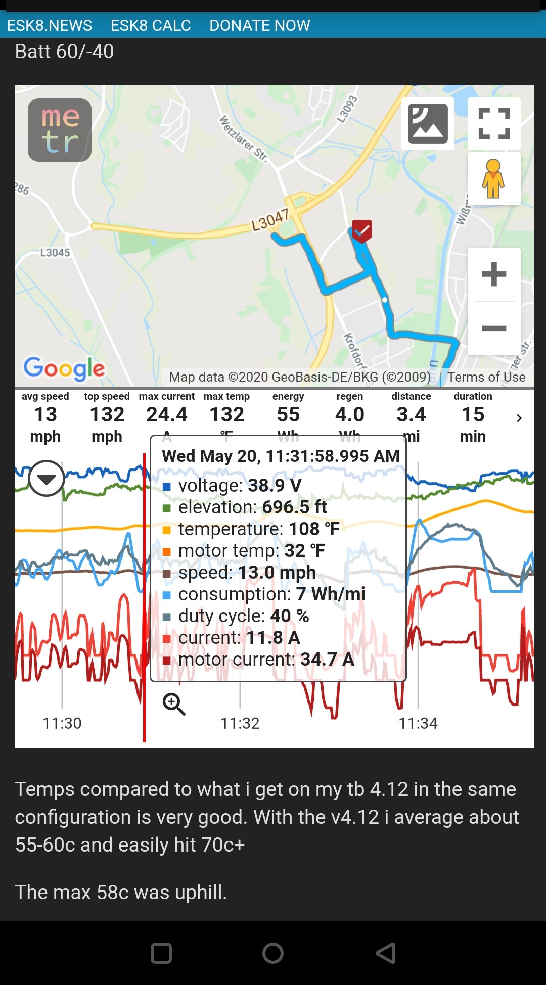

So…i just did my first ride on the Neobox.
Setup:
TB 110
Single sk3 192kv
15/36
Neobox v6
Motor 66/-60
Batt 60/-40
Temps compared to what i get on my tb 4.12 in the same configuration is very good. With the v4.12 i average about 55-60c and easily hit 70c+
The max 58c was uphill.
Definitely feels smooth and doesn’t have the typical Jolt i feel with the 4.12s
Damn son. 132mph?:zap:
Of course. Thats just cruising speed haha.
Seems like the vesc wrote bullshit data.
