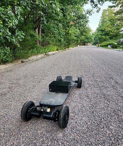

And then I took it out to my gravel road for some pictures!!!
No real riding to let the loctite cure.
But I am stoked to get it back.

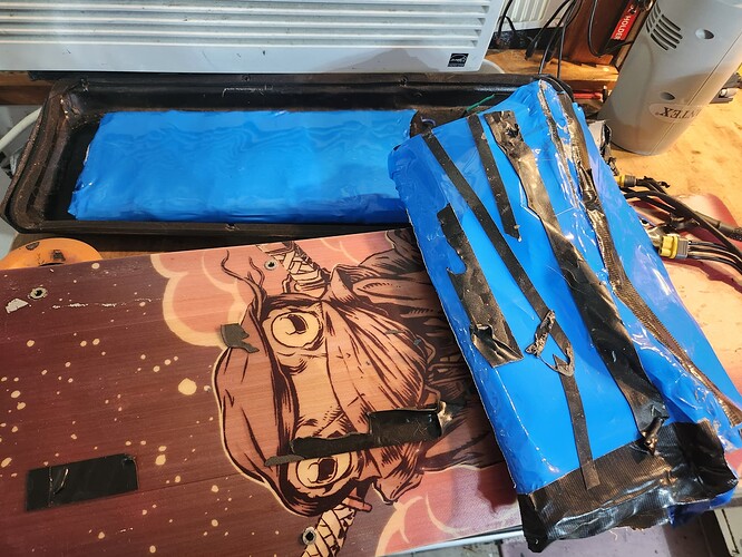

I did something pretty clever here, when I taped the battery to the deck.
I used an extra layer of heat shrink, so to unmount the pack l, I can cut the outer layer, and remove the pack easily.
And then fight with the 3m tape.
So up on the garage wall goes half the Demonseed.

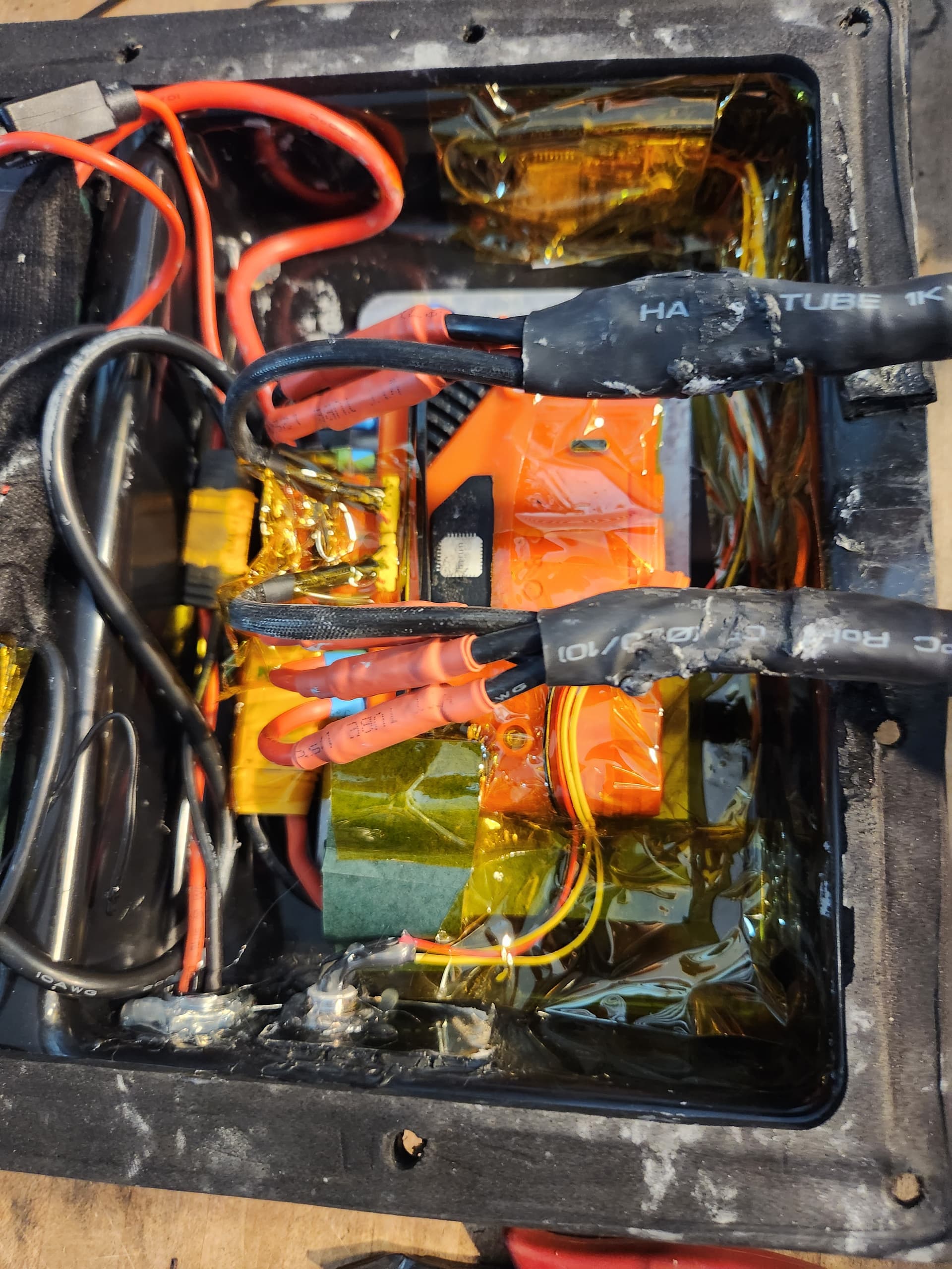

Off course the freaking connectors on the Unity were wrong and I had to get to soldering.
This was a funny moment.
I wanted to match the motors 5mm bullets, and actually did not have any… So I had to do some unsoldering to salvage a set…
Sometimes hoarding doesn’t pay…
Not overly proud of the soldering here… But it got put together anyways…

Then it’s on to the rats nest…
The Unity is held in place with thermal paste, and a zip tie on top, and a couple spots of hot glue.
I know people can make this stuff look neat and pretty, and I commend and admire them.
But I cannot…
I just try to make sure shit stays still, and doesn’t rub together…
So much tapes…
Oh, I did run detection a couple times before taping everything… Doing that in the wrong order sucks.
And using that clamp on the axle there gave me a good way to hold it all in place when the motors spun up.
