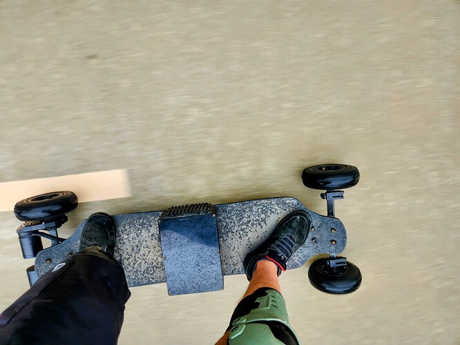

But I am totally calling this the Gravel Demonseed.
I rode around in front of the house…
Got to 1.5 miles…
It’s kind of a big deal I have a board I can tool around in front of the house again.
Being able to turn on a dime and do tight figure 8s was fun.
The 6x2s had amazing grip on the chipnseal…
I had not really spent time with Pneumatics on DKP.
So this is kind of a new world.
Looking forward to getting some new wheels on here to get a smooth drive going.
