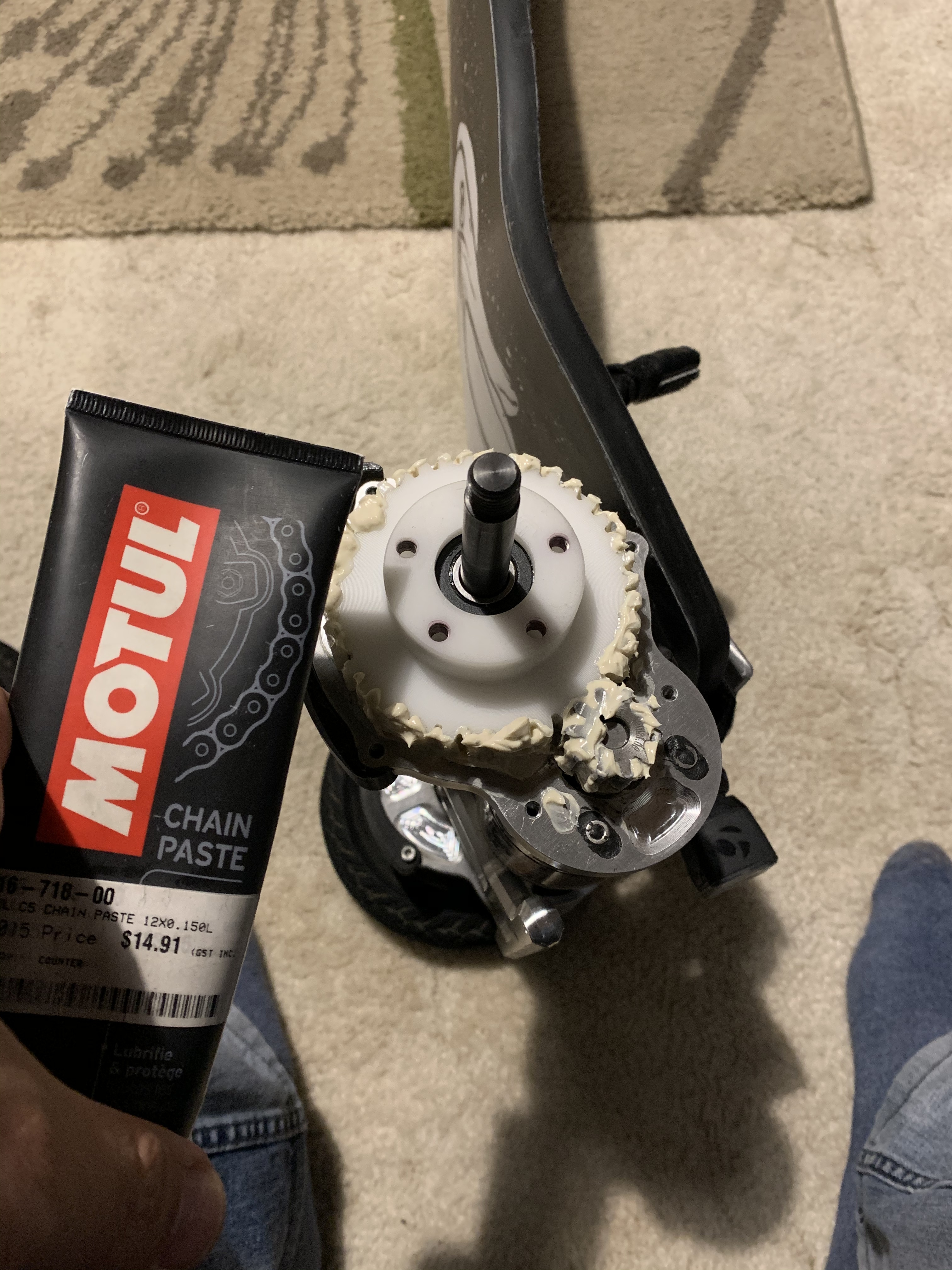

That looks too tight? I’m not a backlash expert, but I’ve messed with it a little bit, and that looks too tight to me.
It clicks when I wiggle it and rolls free, which is what should happen, because the tooth faces lose contact and when they come together again, makes a clicking sound. I’ve literally adjusted it about 1mm, maybe slightly over.
This was before, when it broke teeth off the spur gear.
This is why I will never again buy or use any gear in an esk8 unless it’s steel.
The same can and will happen with steel if the backlash isn’t set correctly. Others that did it better than I, have literally thousands of kilometres on the same gears with no visible sign of wear.

Yeah, only I had mine like the just right example and lost teeth, so…
Set the backlash not too tight, if the wheel gear can wiggle just a tinge, it should be alright. Having it too tight might cause premature wear on the wheel gear.
Mine is now somewhere in between too tight and just right according to that thread.
Also, I’d much rather have some run-in period with slightly reduced life, than broken spur teeth.
Adjusted and lubed the other tranny too (you sick fucks) with Motul, not KY.
Oooo chain paste. How does that fare compared to lithium grease, or are they similar?

IDK, but it doesn’t stuff up plastic so that helps!
