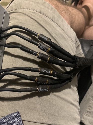

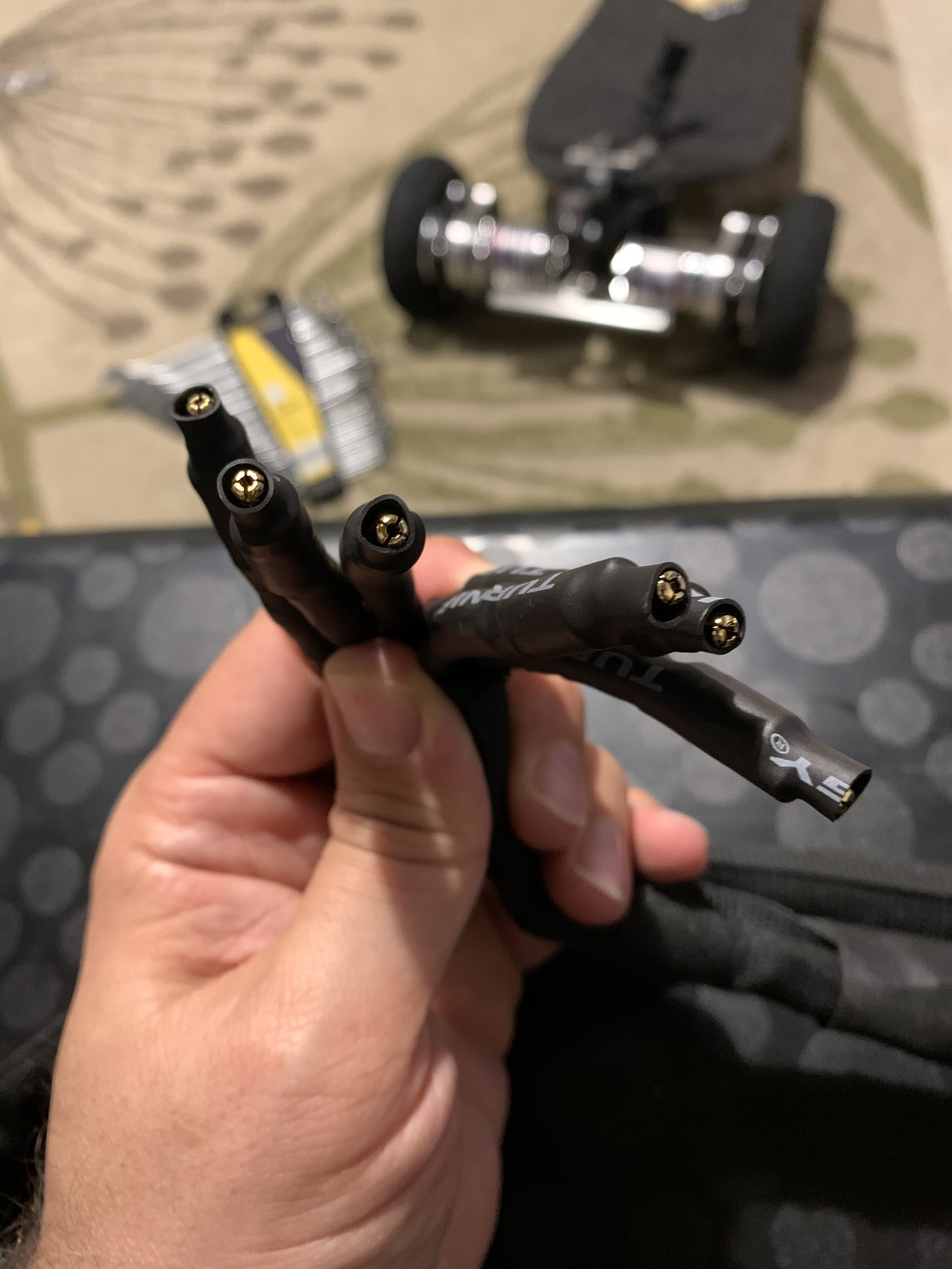

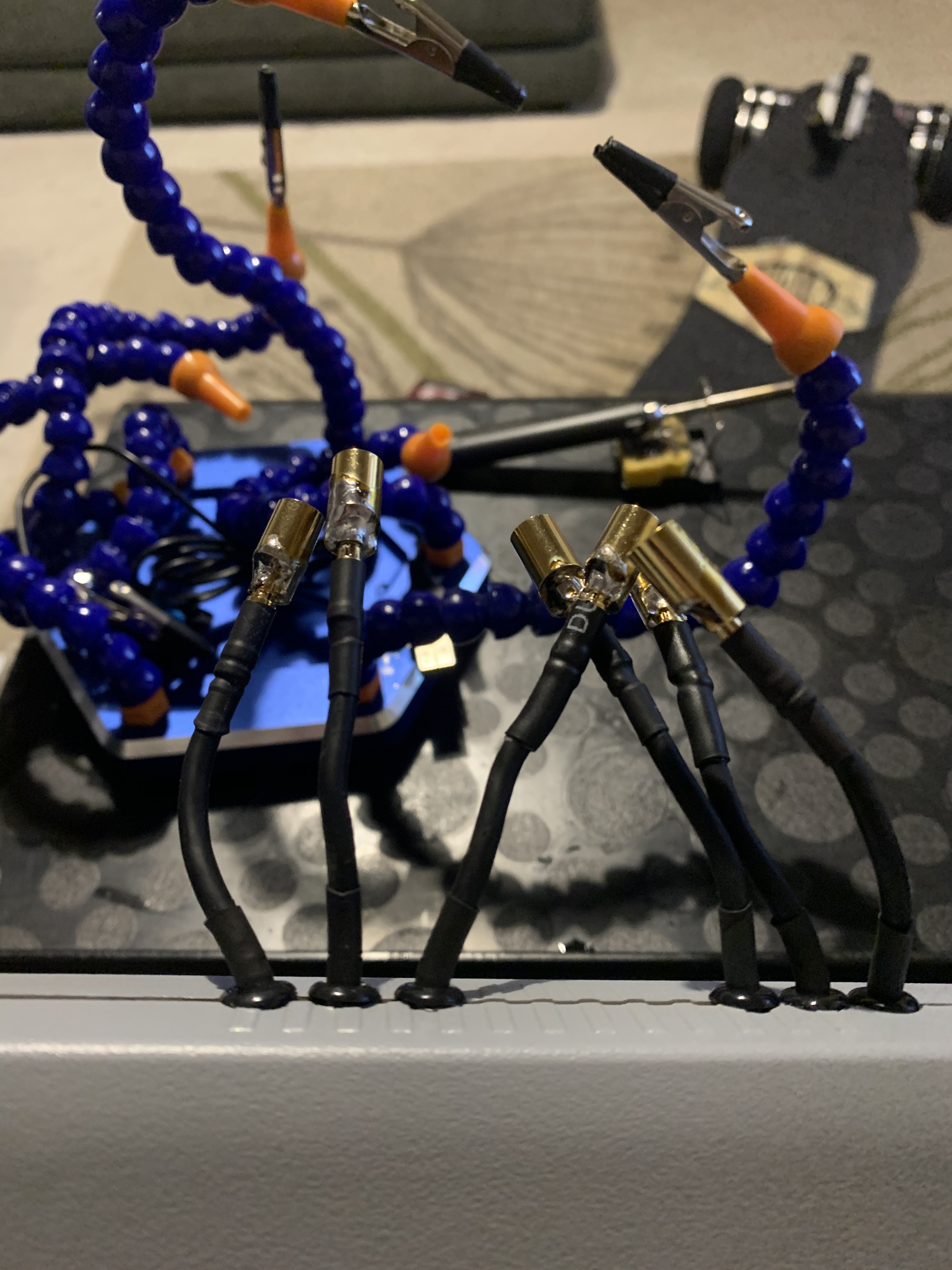

Soldering 6.5 to 3.5 adapters complete! First time from mains using a laptop PSU too, used to do it all with a 6S LiPo before.

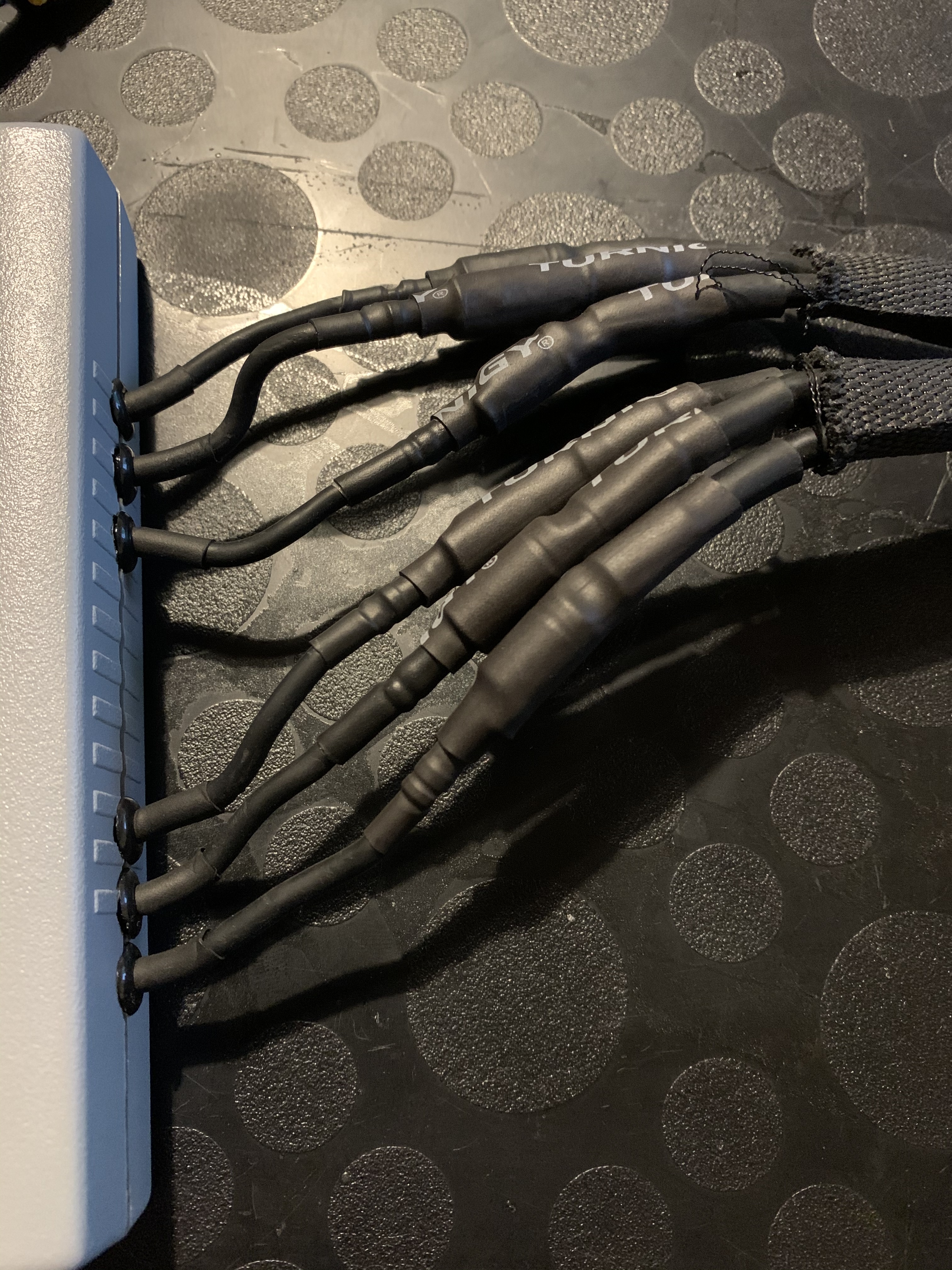

This heatsink job gives me anxiety, you should replace it so that no metal is showing underneath. No one likes a shorted phase lead…
Will do! There’s more to be done around there, but definitely something I’ll be paying attention to. Thanks!

Drilling and cutting little holes takes a while, and I thought I was finishing tonight! Finished up my phase connector isolation too, thanks @MauveMaverick!
