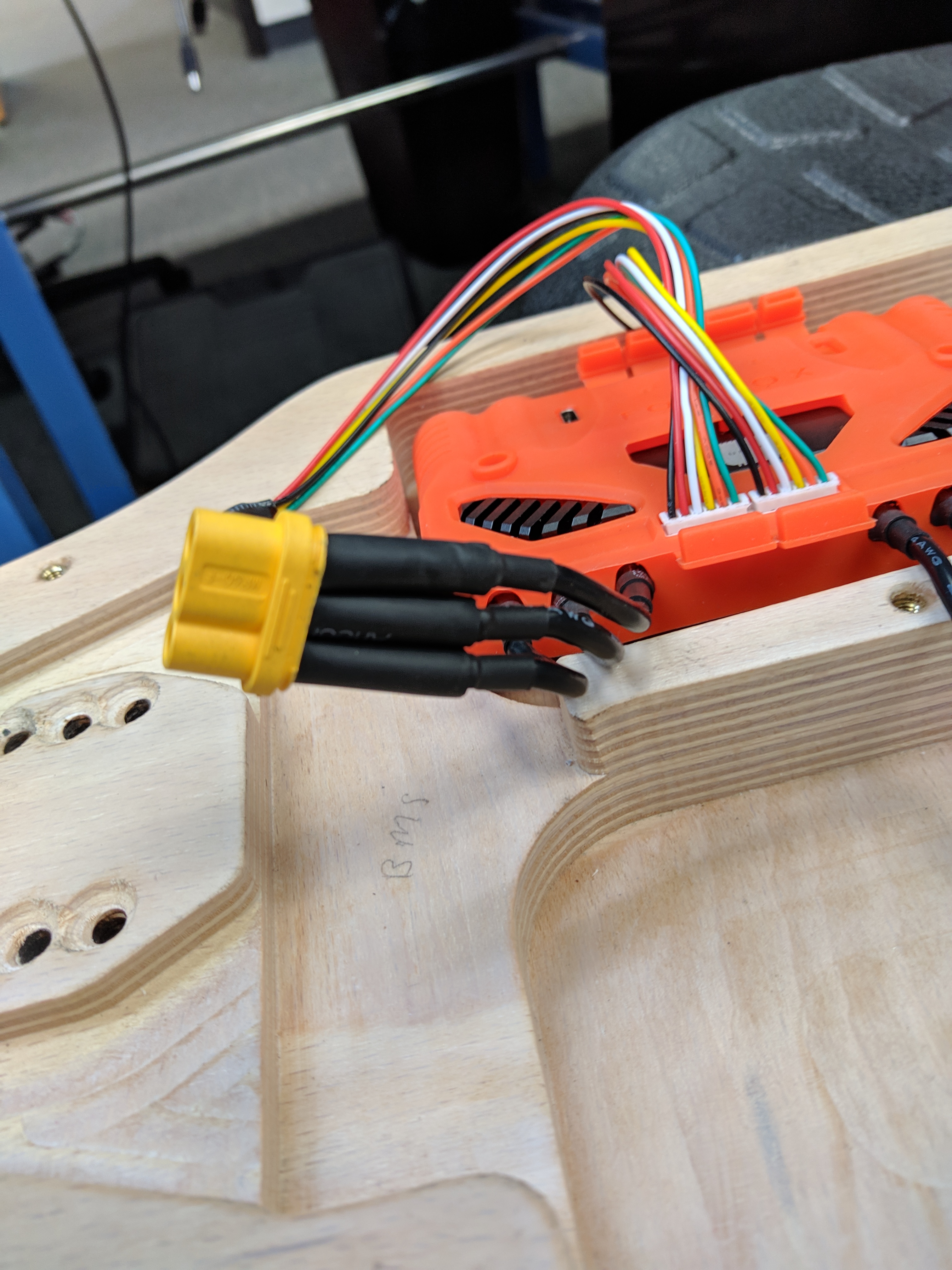

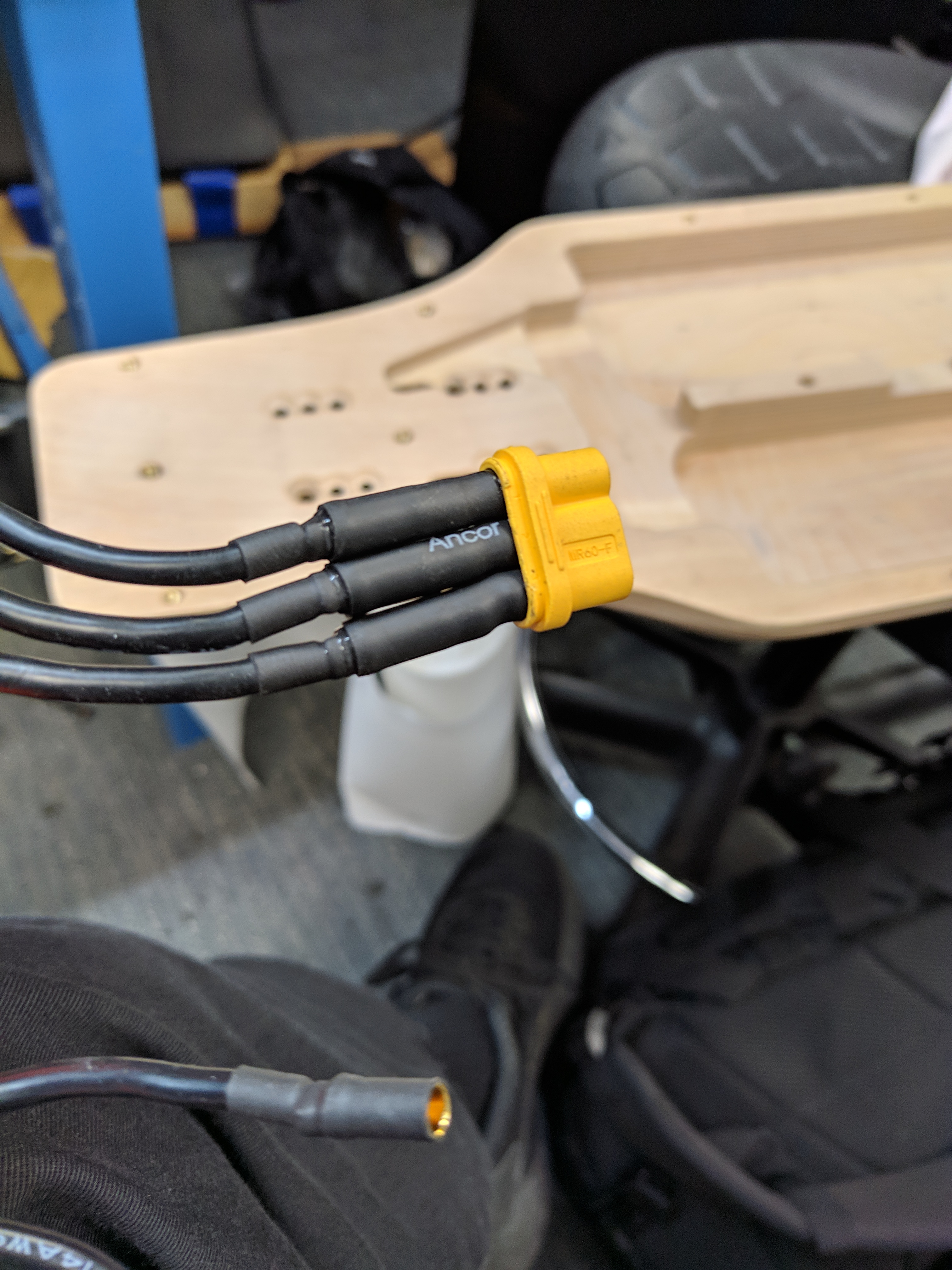

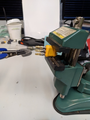

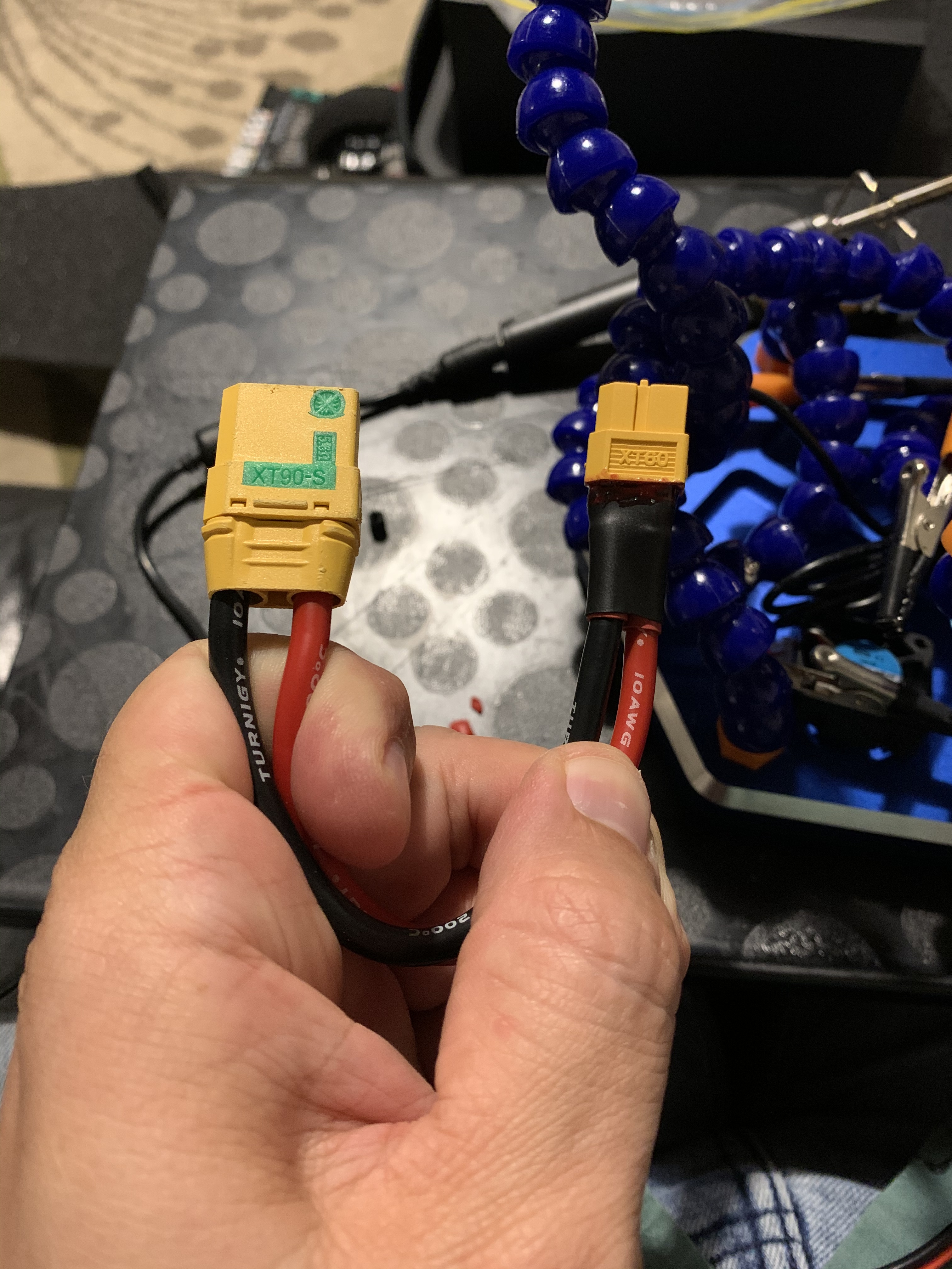

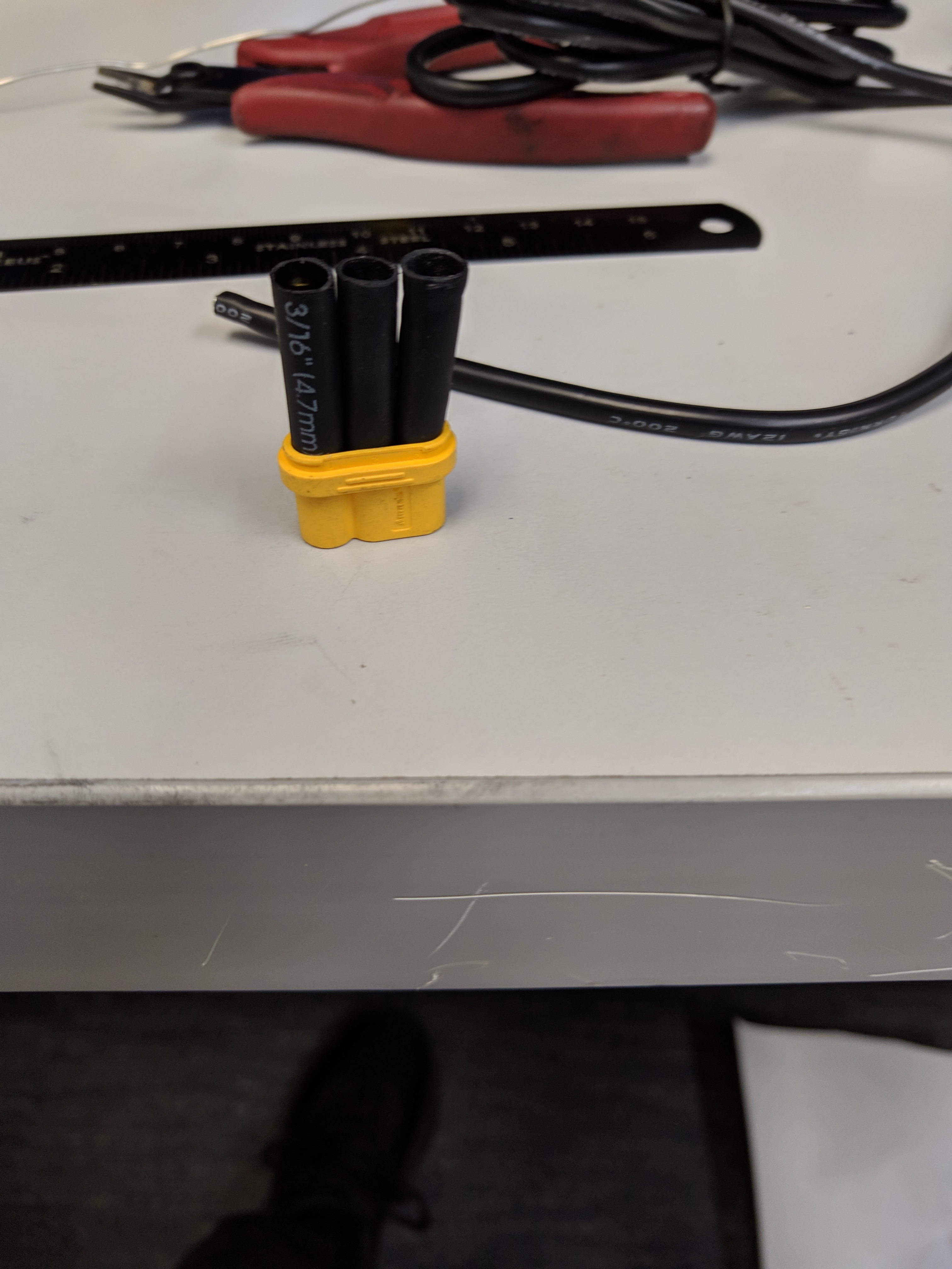

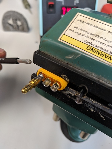

out of curiosity, why solder a bullet to another bullet and not replace the smaller bullet?

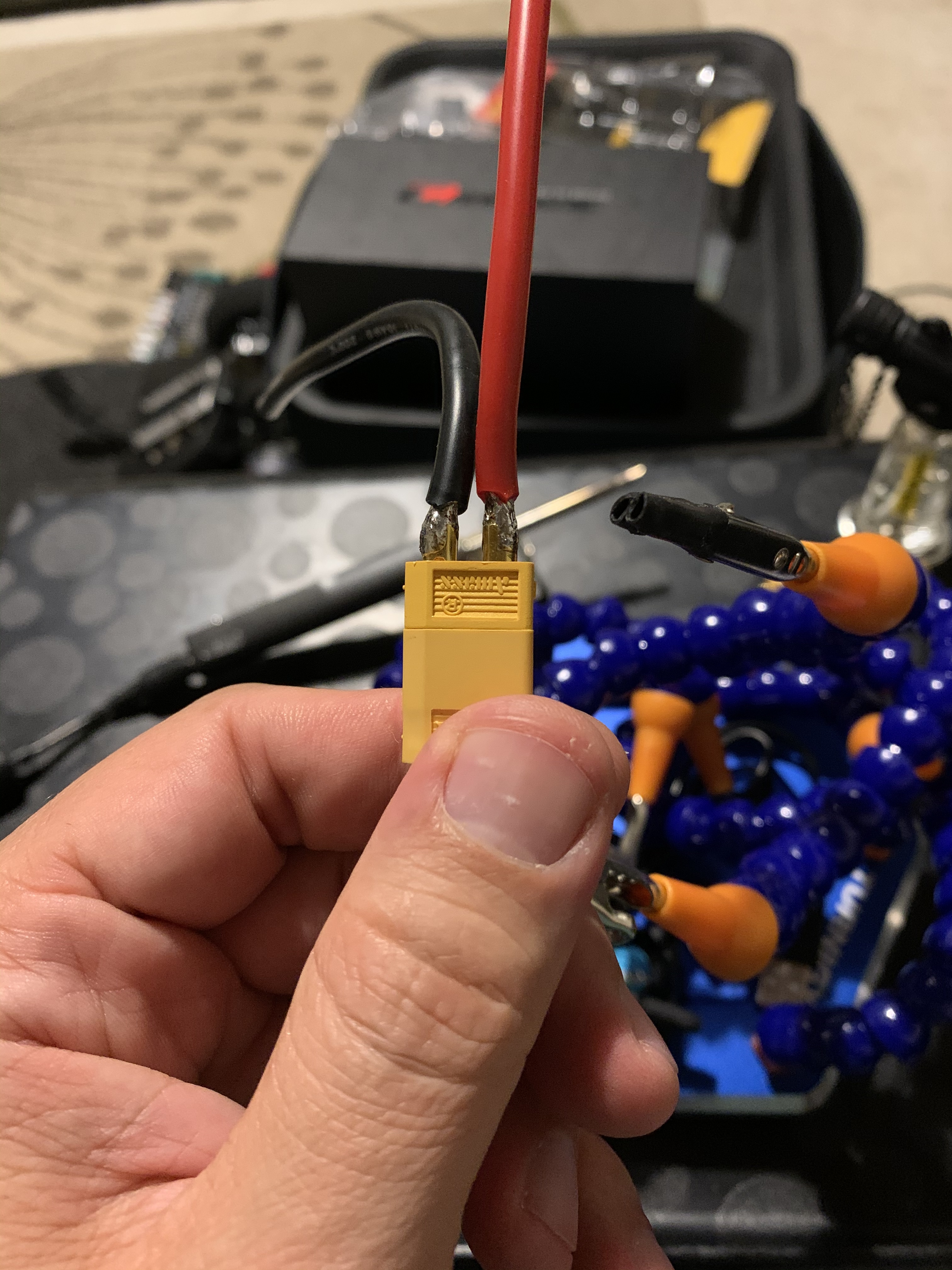

Unwillingness to alter the Unity? I’m making an XT90 female to XT60 female adapter for the same reason tonight.
well the original bullet is kinda ruined anyway if you fill it with solder, so why not replace
Didn’t fill it with solder, I created 6 adapters that go 6.5mm female to 3.5mm male, to bridge between my 1.5m phase leads and the Unity phase leads. Then I plugged the adapters into the 1.5m phase leads and put heatshrink over them, with overlap to cover the 3.5mm females on the Unity end when plugged in.

…why? There’s no such thing as a warranty for them, and if we don’t have something better and as convenient as them a year from now… community has bigger issues :man_shrugging:

I mean, I’ve been there BB. I think most with first batch unities have… and learned it was kinda just a tedious waste of time. Bulky too :open_mouth:
For something that’s still in development (my backpack platform) and subject to more changes in the near future, there’s something to be said for modularity and plug-n-play.
Plus, I get more soldering practice, which is never a bad thing.

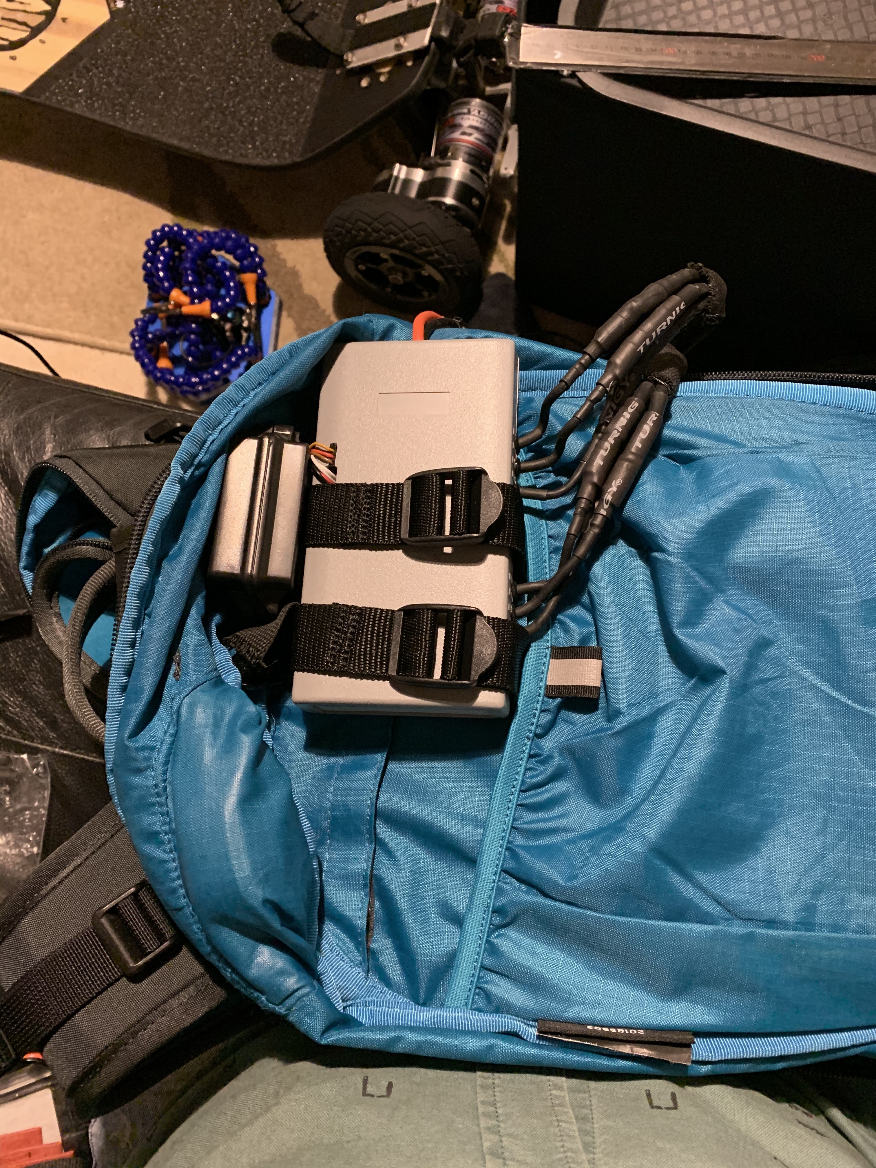

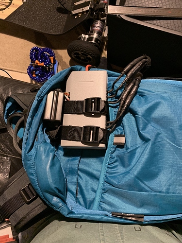

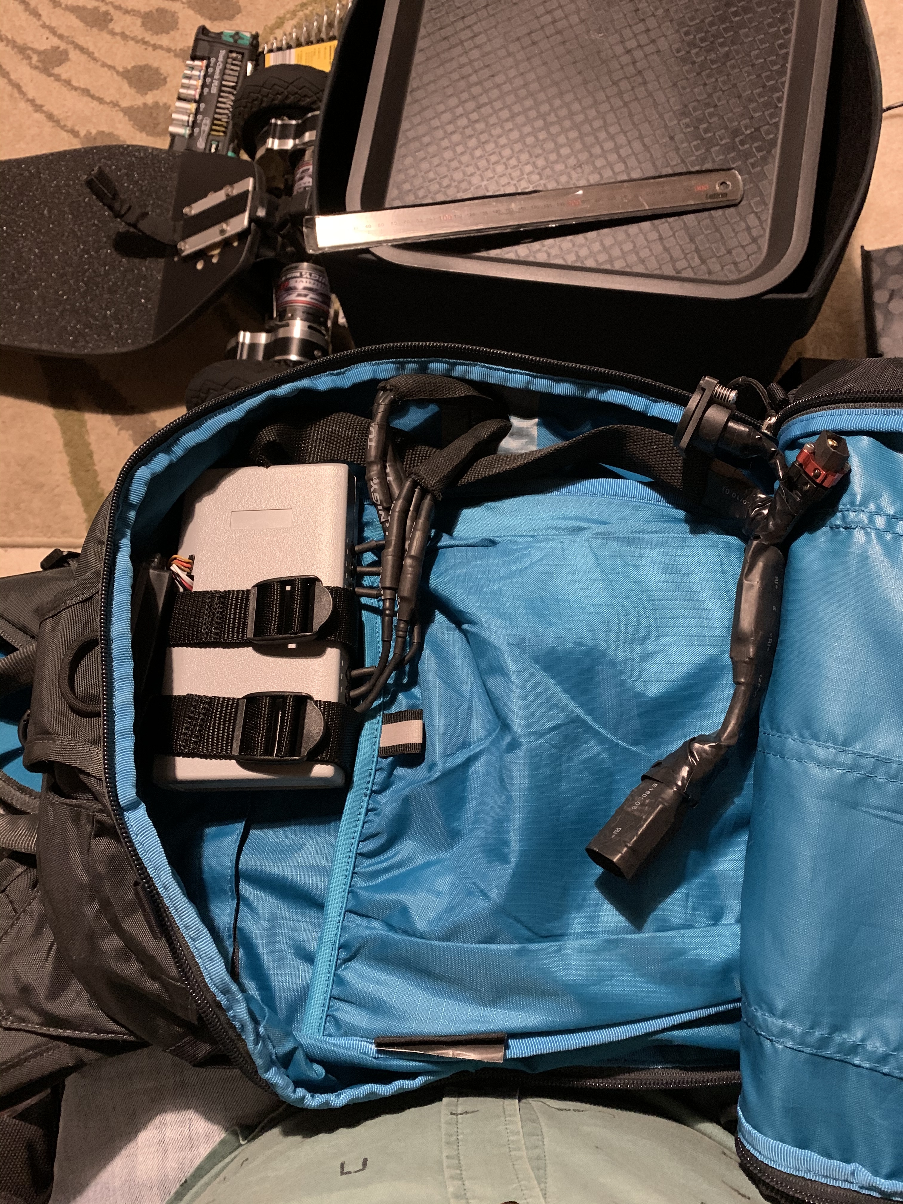

Soldered my XT90 female to XT60 female tonight, and did my backpack integration. I’ll hook it up tomorrow night after I’ve set up the Unity and metr.
