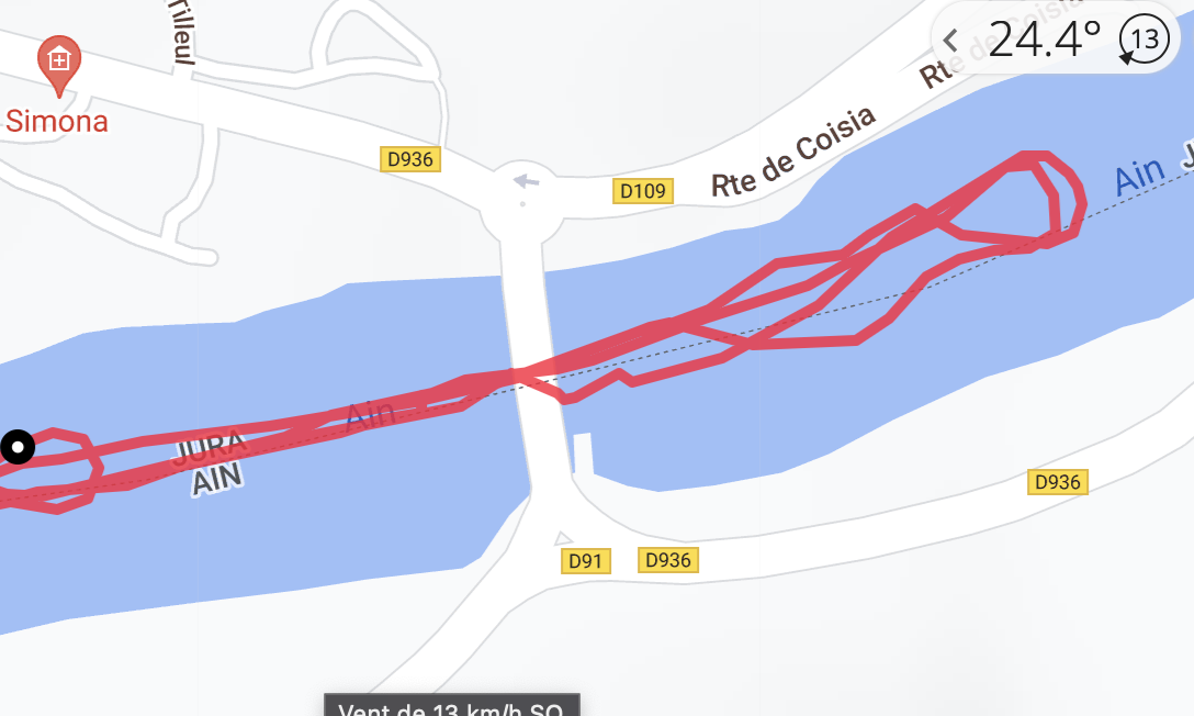

Is it possible to calibrate the GPS of the metr.pro can because I have a difference of 3 kms of total distance with my watch GARMIN phenix 3 and of 2 km/h.
GARMIN gives me 17 kms traveled against 14 kms on metr.pro.
And 34 km/h in vmax for GARMIN and 32 for metr.pro.
No, it is not possible to calibrate unfortunately. It’s a big difference though. Can you see where it differs on the map? Any pictures?
Here are the two simultaneous recordings with metr.pro and the Garmin watch.
It is not obvious to see, but the metr.pro gps track seems more random than the Garmin …
Su do you think ?
https://metr.at/r/QNRBY
And Garmin :
https://connect.garmin.com/modern/activity/8971439884
Metr (bad accuracy, going on land out of water)
Garmin
Yes, looks like accuracy is not that good for Metr GPS module. You have Garmin watch on your wrist I suppose, so it has good sky visibility. Where do you have GPS module positioned in your foil? Do you check satellite count in Metr app?
Would GPS accuracy be improved using a phone for GPS?
Yes the gps is in the waterproof case, as you can see I fix 10 satellites :

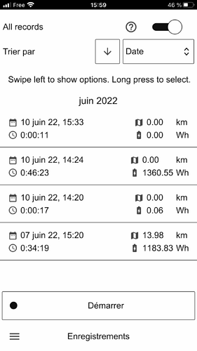

New release; new disappointment: metr.pro has not registered anything ???!!! I didn’t change any parameter since the release of 7//06/2022.
Namely that when I got into the water I had 12 satellites acquired and that I did not fall before the 13 th km…pour do I have no exploitable data?
I just have the data from my watch.
Did you enable Manual Sync as explained here Metr Pro Updates - #1946 by rpasichnyk ? If not, please do so.
I had tried before I had to reset the application because of date inconsistencies … But the problem was the same… After the reset of the app (07/06/20022) the registration had worked well without going through the “manual sync”…
I test tomorrow with the manual sync without reinitializing the application.
Thanks
