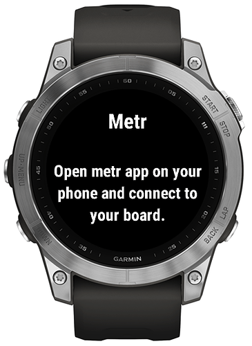

Get the watch app here:
When you launch it, it should display a welcome message and wait for connection from the mobile app:
Make sure app on your phone is updated to the latest version (v4.17.0 on iOS and v4.17.1 on Android).
Then on your phone go to metr app, Settings → Miscellaneous.
Make sure you have “Apple Watch” or “Android Wear” enabled, doesn’t matter if you don’t have those watches, this is temporary, was just easier for me to do it this way, I will make it prettier later.
Click on “Pair with Garmin”
Navigate to Realtime tab, select what data you’d like to see (click on small watch icons, you can select up to 4 values):

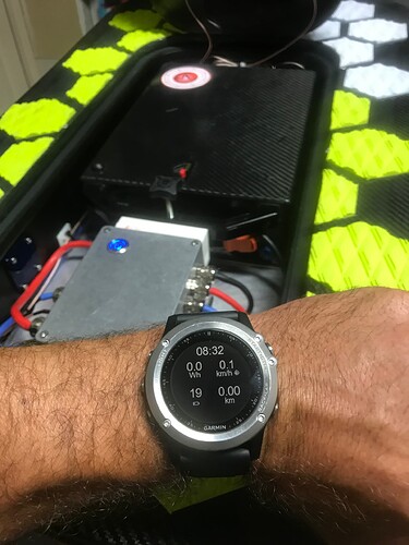

Hopefully on your watch you will see something like this:

I was so excited to test it that I went for a 30 minute ride on my lunch break today. Your setup instructions worked and it connected to my 945. It’s really cool to be able to see all that data right on my watch in real time. I changed some of the data fields it displayed and they all worked.

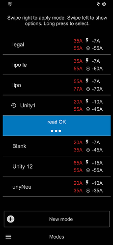

Oh and while we are at it, I’ve lately been getting some “timeouts” while applying modes.
Usually stuck at this state
Takes a while until the Red timeout banner appears. If i “cancel” it [?] By swiping in the opposite direction then no mode can be applied, after letting go the bar jumps back to the beginning. Restarting the app solves it.
I’ll see if i can get it on video.
Edit: red banner doesn’t appear. Seems like that was a different timeout.
Here’s the video.
Video 1 showing it getting stuck in this loop (continuous forever?) I recorded for 1:33 and it didn’t stop.
Video 2 shows me “canceling it” then not being able to apply a different one until i restarted the app.
https://youtu.be/SG6ptS1ImYs
latest_log_2022-06-01.7z (4.2 MB)
Just fixed “canceling” mode, will no longer be possible.
The stuck thing… I can see that something is not working properly with Metr LTE, if you remove it, the problem will most likely will go away. In the meantime I will try to understand what’s wrong.
