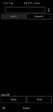

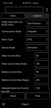

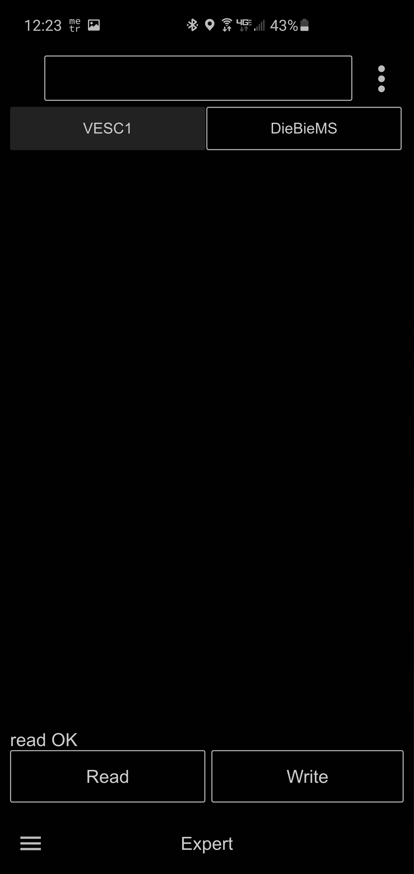

Hey, I am on version 4.5.8 on android with 5.22 on the module. (no updates on the play store)
I have a DieBieMS hooked up and when I go to view the Expert->DBMS tab, nothing shows up. I was experiencing this with the 5.21(previous one) fw version as well. I can see/read/write to the VESC fine, just not my DieBieMS. TCP bridge allows communication to both the VESC and the DBMS tho.
I tried this on my friend’s iPhone and he was able to read/write/see the BMS. I can find out and edit in what version he was on in the morning, I just figured the ios app would be delayed behind the android because of apple’s longer process.
Let me know if you need logs or any more info! Thanks!
Not quite haha. This is after the update you did on the 15th. Unless I need to go “beta” in the app store?
Same problem as before, I clicked on things for no apparent reason sometimes lol, just pay attention to the screen being split in two in when the phone is horizontal. Everything else works like a charm :grin:

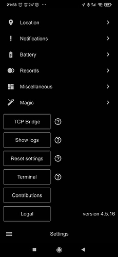

What version of the app do you have? (You can check in metr -> Settings -> Scroll down)
Hah now I get an update on playstore. Sorry about that, I literally checked 4h ago on playstore and I was up to date.
Edit/ 4.5.18 works beautifully now, thank you Roman!!! :heart:
