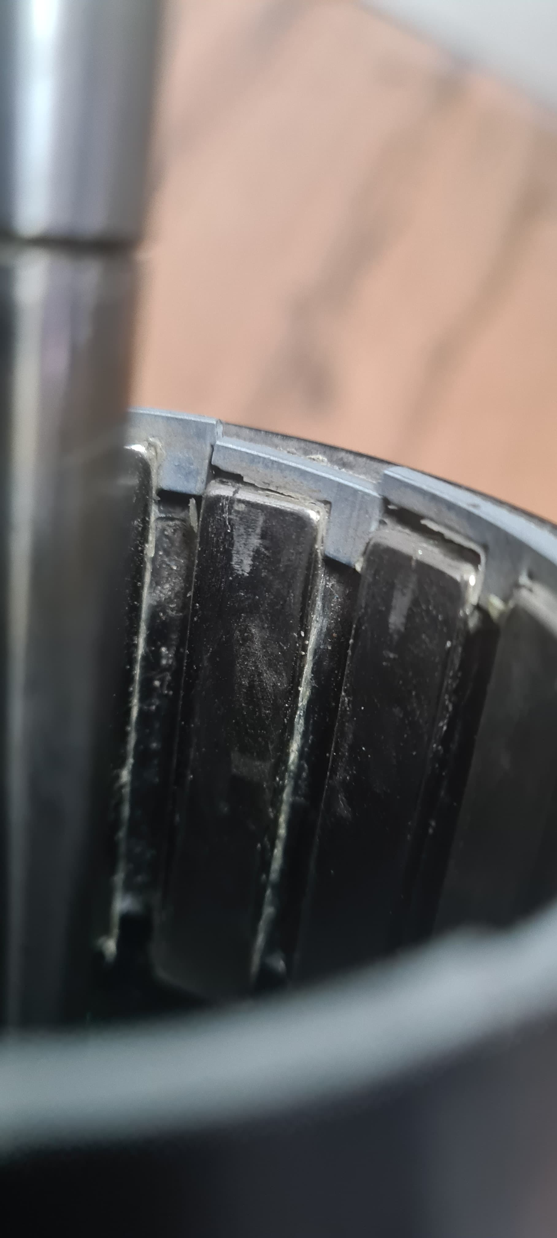

Well, I think my 100amp ESC has already gone bad. Was riding home from work and it suddenly died.
Battery is just fine. reading at 49v.
Power button fine too. Tested it on the mulitmeter. I even hooked up a new switch and the board does not turn on.
Shortly after the ESC swap, my left motor started clicking and then my right. I even had difficult with starting up from a stop. Felt like a loose belt but my belts were not loose. Timing seems suspicious. Not sure if an ESC can make motors go bad. I contacted Meepo two weeks ago about the motors. No response.
Also, the acceleration was wonky a few days prior to failure. Would only go about 5 mph. Had to let go of the throttle then it would respond normally.
Anyone else with these issues?
You should check your motor.
I had that sound and when i opened the motor the ring on top that seperates the magnet was scredded .
Old or upgraded motors? The old ones did not last very long after I installed the 100A ESC. The mentioned ring that keeps the magnets in shape was broken in several pieces. Show a video to Meepo If yours are having the same issue, took me not too long to convince them to send me new (upgraded) motors.
I opened up the motor already and cleaned it. It was surprisingly clean.
Old motors. I am getting the impression the older motors were not up to the task of handling the new ESC.
That dosen’t look right.

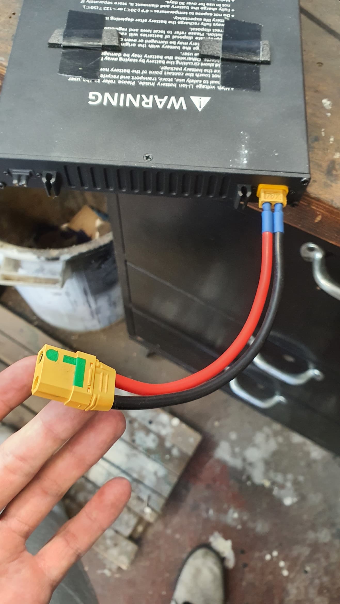

I made an adapter cable for a person that bought a heatsink from me, so he’s able to use a stock Hurricane battery and a Stormcore.
