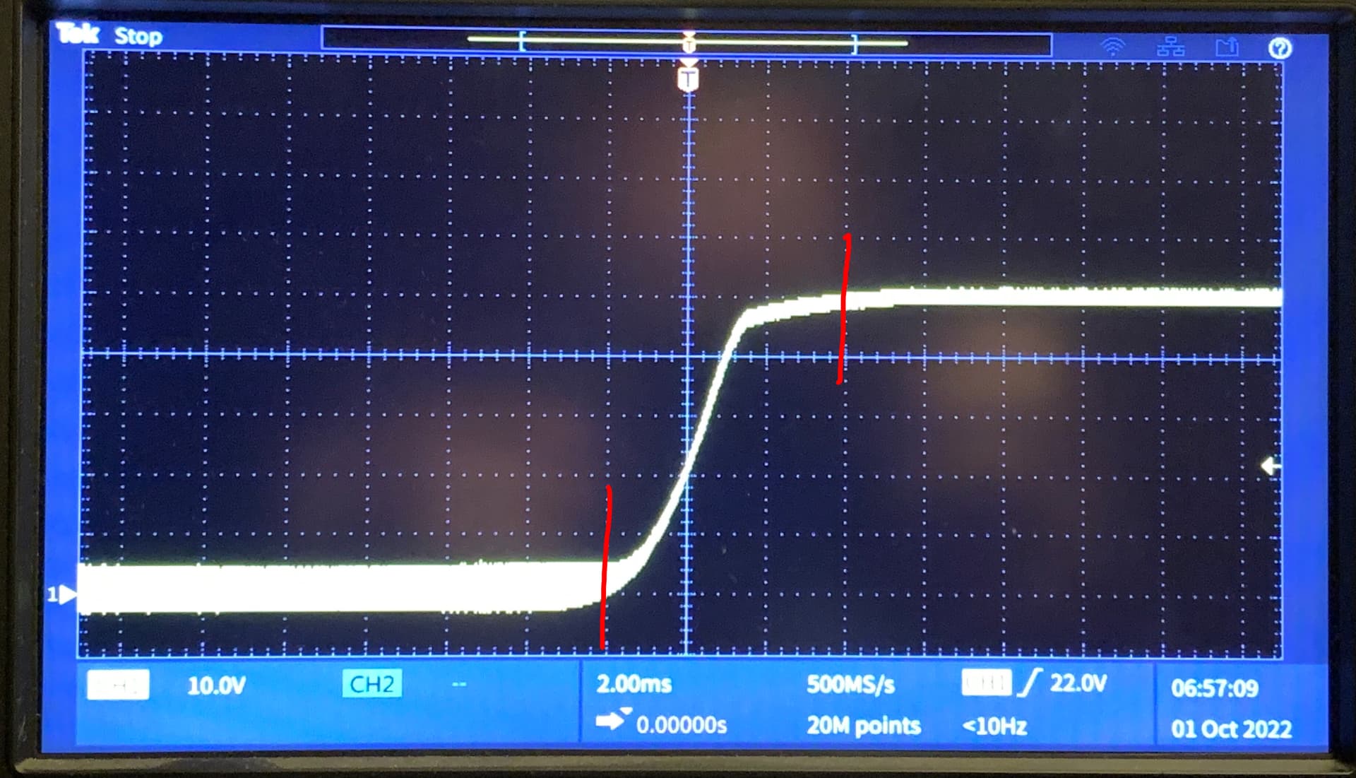

Here you can find out more about it: Battery charging Module Hurricane
My sincere apologies. I really dropped the ball on this one. @fujio001 and all, here’s what I’ve found out so far:
  • The module starts working at about 13V.
  • The output only turns on if the input’s (charger) smaller red wire is connected to charger’s POS pin.

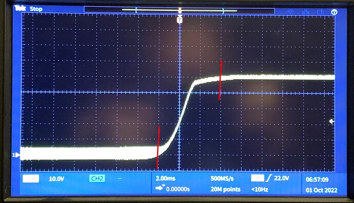

  • It takes about 4mS for the output to switch mostly on, 6mS to be on (see photo below, between the red lines). That could indicate an AS switch function or it’s just a filter capacitor charging up the FET gates slowly to keep voltage spikes to a minimum when the FETs turn on.
  • The output stays on for any charger voltage from 13V-54V (the highest voltage I went to).
  • If the module has charger overvoltage charge protection it activates at above 54V.
  • The module is protected from a reversed-polarity charger connection (main red POS wire and smaller red wire connected together).
  • There doesn’t seem to be any charge port overcurrent/short-circuit protection.
So far this module just seems like a way to make sure a three-wire charger is used and to protect the pack from a reversed charger connection. But there are more components on the pcb than are needed for this IMO.
There might be AS switch functionality but for less than 4mS and the FETs are used as the resistor load (which is a legitimate way to do this) since no resistor is present to limit the pre-charge current.
Does this module get used for packs above 12S? Could the overvoltage protection threshold just be higher than the 54V I went up to?
I’ve amended my post. The output switches on in 4mS-6mS (depending on where the fully on threshold is set). This could be an AS switch function or it could be just the FETs being turned on slowly to keep voltage spikes to a minimum.
Though, slowing things down for minimizing voltage spikes also slows down the current flowing into any “downstream” caps.

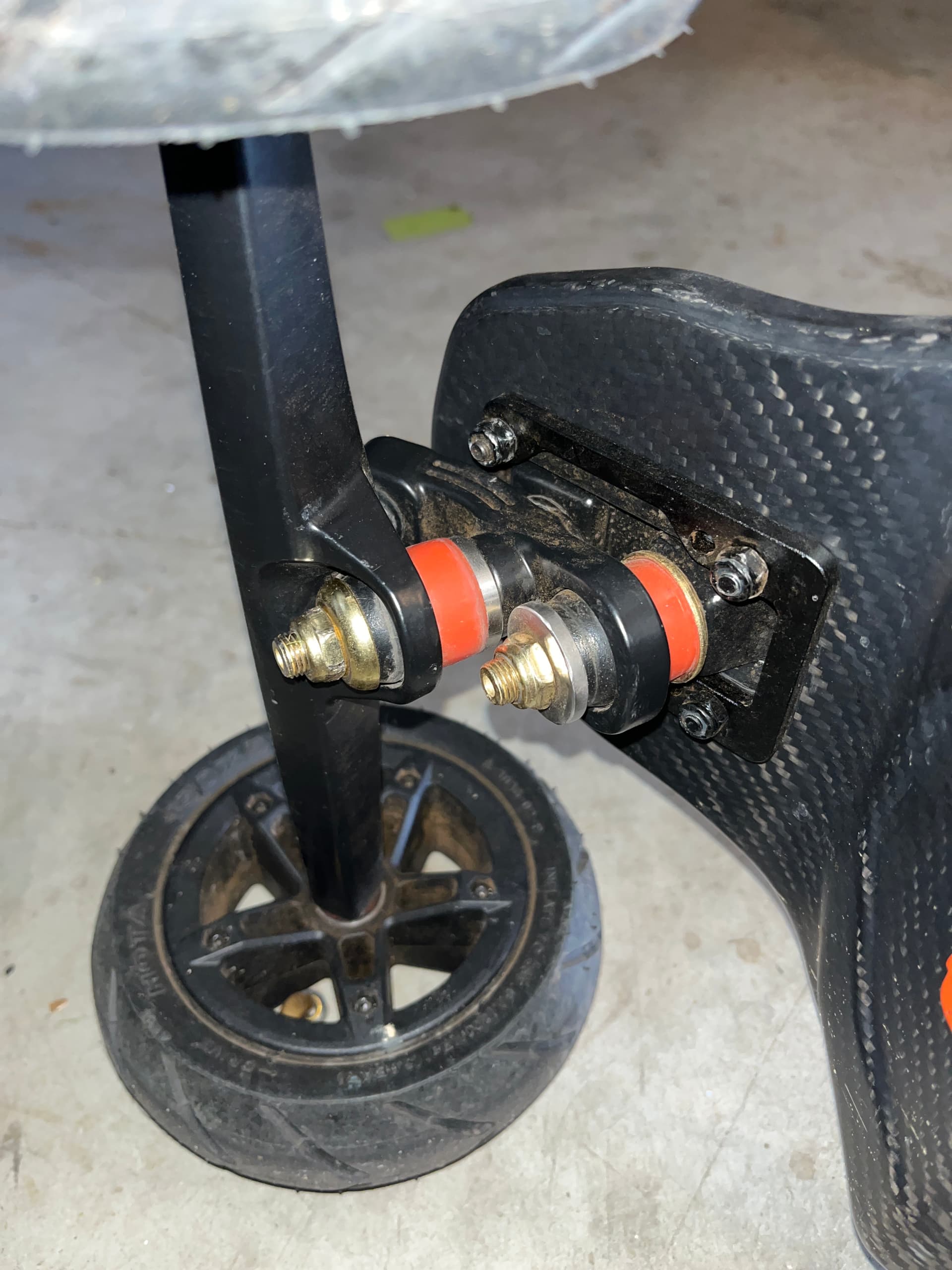

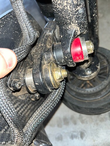

Put stainless bushing on bottom kingpin and 98a bushing. Think red bushing is 96 or 97a. Much more stable now at high speeds. Fronts are stock bottoms and top bushings are 98a cone.
doing that much work to get stable with DKP, might as well convert it into TKP or RKP :joy:
Temporary fix. :joy:
