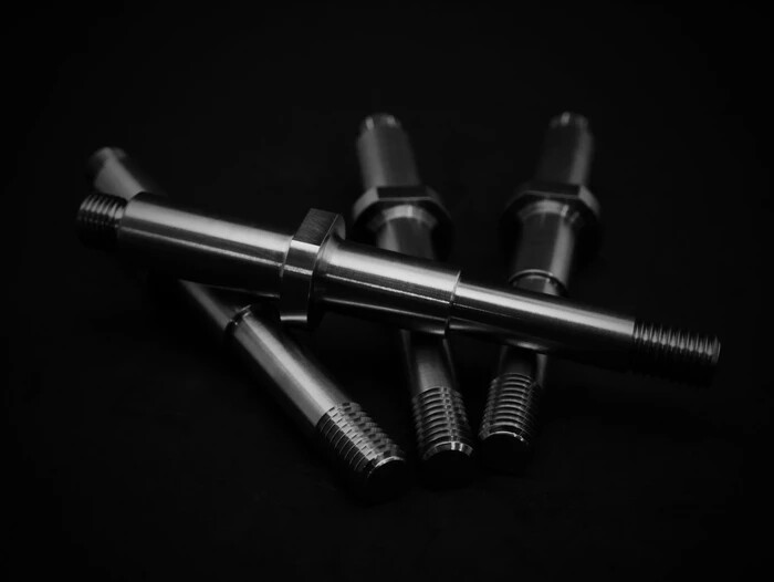

My thoughts were a 10mm axle would permit 16100 (MTB) and 6900 (PU) bearings for convenience. I guess the metric or imperial designation is a matter of preference, as long as there is minimal slop between axle and bearing. Either way, looking forward to seeing updated options!

On the subject of axles is there a consensus on preferred overall axle length (or do I need to unleash another poll)? The 20mm spacer that would be used for our hubs obviously isn’t shown.
Most eMTB trucks have removable axles dude
Seems like a good length, similar to other trucks on the market. It’s nice that you use a spacer now which is removable and offers more flexibillity with drive systems.
It’s never too early to switch to metric. 10mm is the future. Why not lead instead of lag?
I don’t think there is much 9.525mm stuff now – I know Trampa has a lot but haven’t heard of it anywhere else. Maybe there is… …sounds like maybe some old MBS stuff anyway…
But either way, metric is the future.
Totally nothing wrong with 12mm though, why do you want a smaller option?

What the faster typer said. And I’m all about metric. We just do a custom 9.5x22mm bearing that’s the same spec as a 608, but with the id bored out a bit. All else the same. The inner race is thinner but we’ve never had a problem with strength. But I’m worried if I pushed it further to 10mm we might… Anyhow, still open on this, sooo listening.

As for the smaller axle, i prefer metric but as long as theres 12mm I really dont care.

lol did you know standard rkp axles are actually imperial? The non precision ones are 5/16in (7.93mm) diameter
