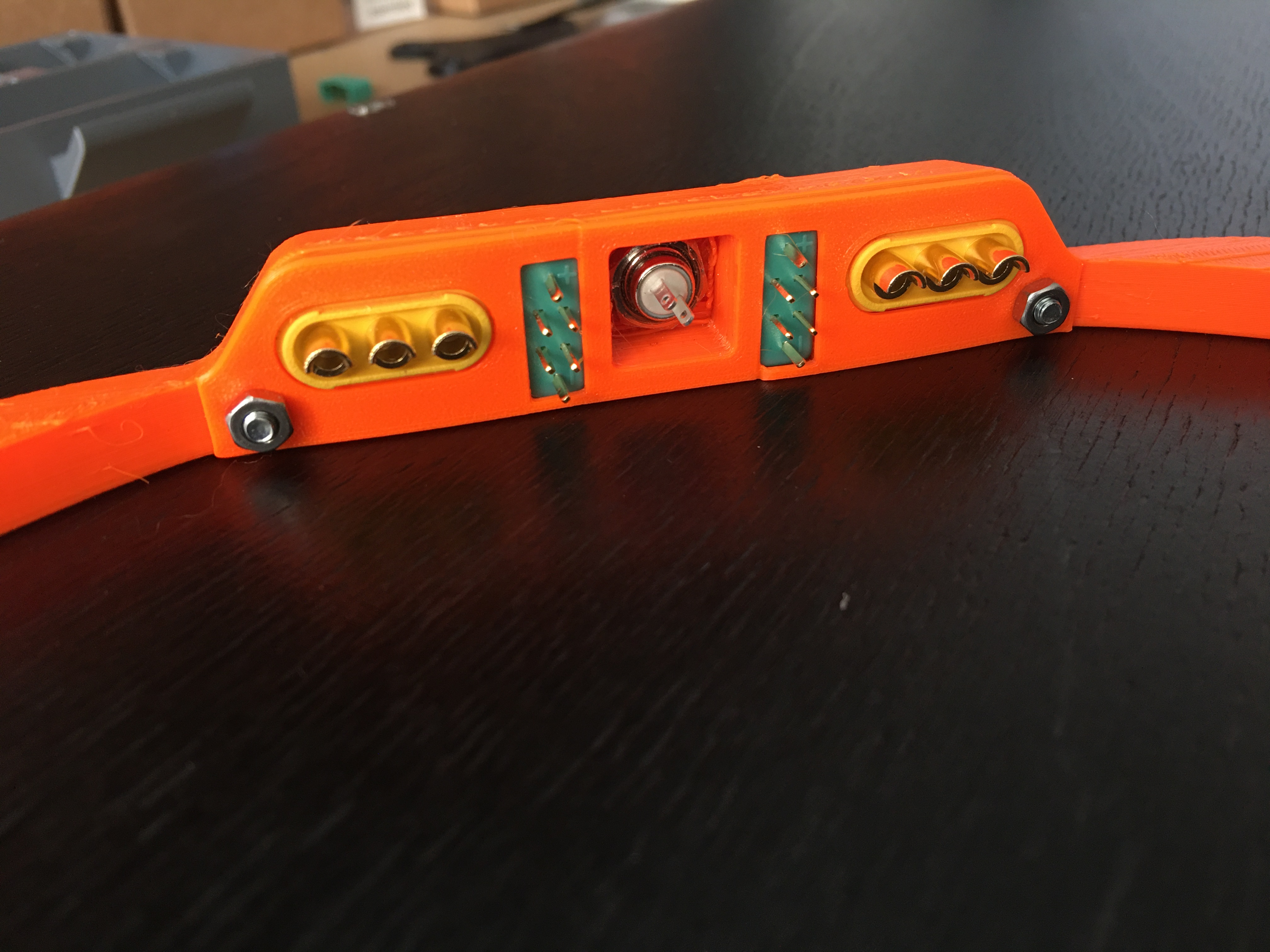

Some progress on the cable outlet. This is just a PETG test piece to check the fit before I print it from TPU. I’m going to move the connectors a little bit. I’ll also see if I can fit a start button in.

Those MPX connectors look really good for sensors, planning to use them myself.
Love the orange look !

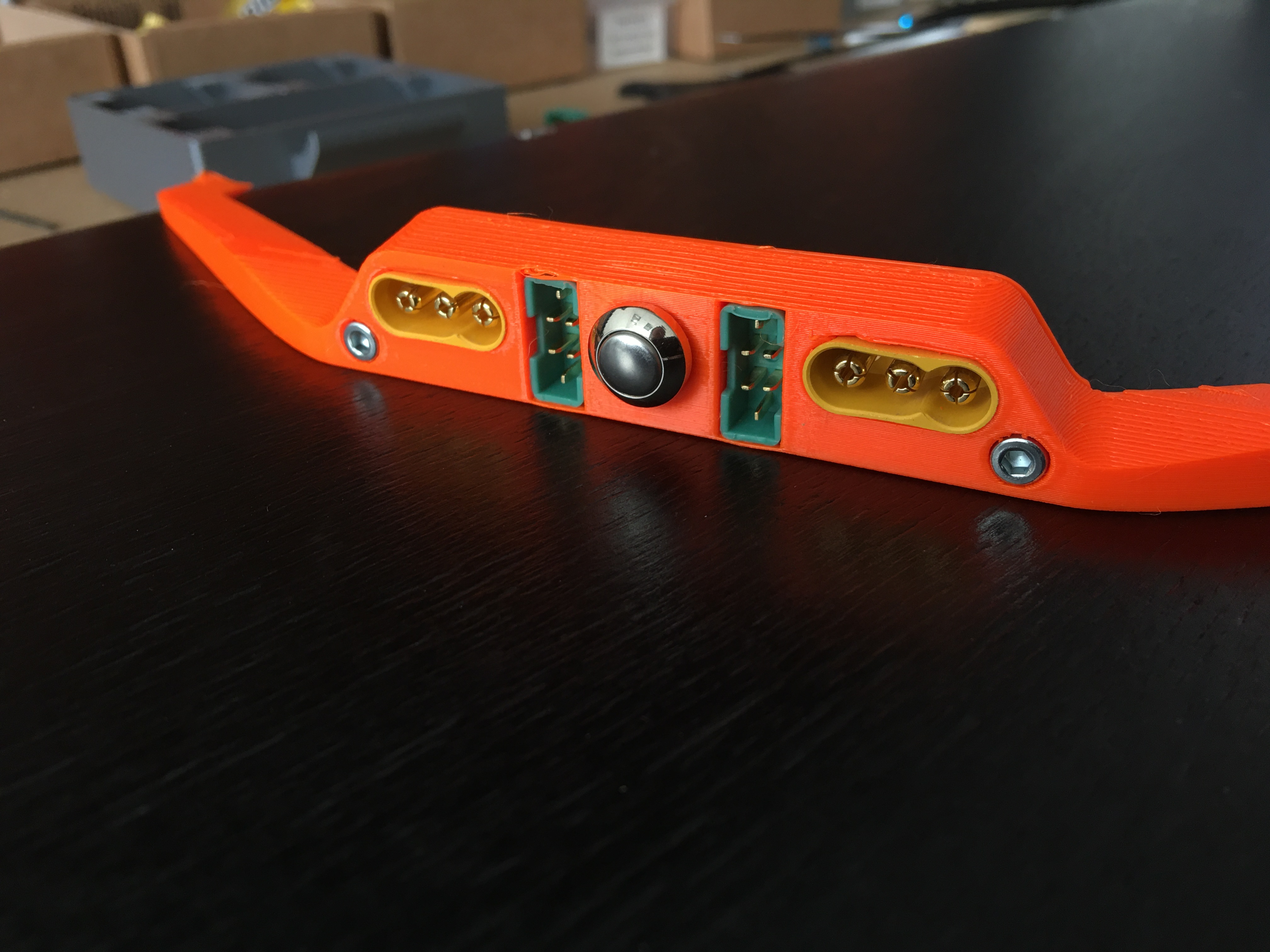

Here’s another iteration. With a start button. I only had enough space for the small DAVEGA button with no LED. It’s OK though. I’ll still have the DAVEGA for on/off indication.
And I also managed to drill the enclosure and install the threaded inserts without messing up the alignment. It’s even fairly well centered. Yay! :slight_smile:

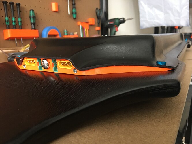

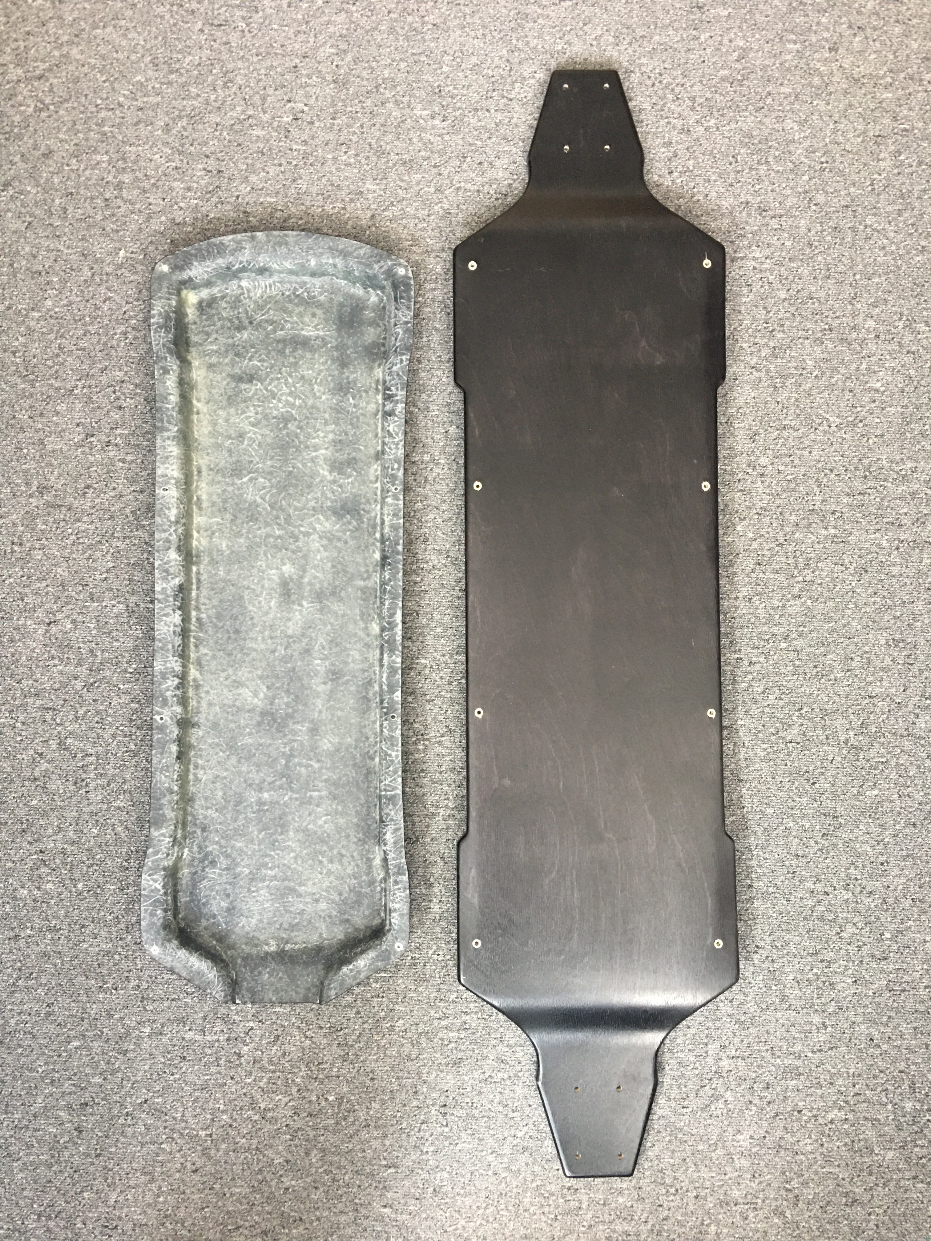

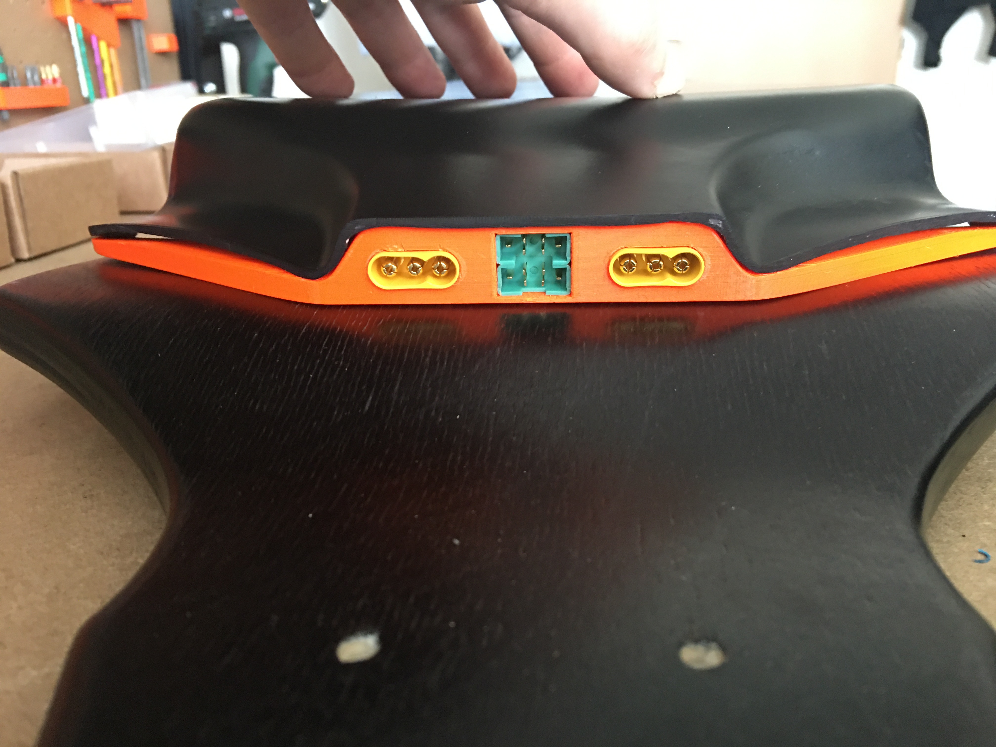

More progress! I’m pretty much done on the enclosure. The fit is good now. There are still a few small holes that I may need to seal with silicone but overall I’m happy with the current state.
The bigger notch is for the DAVEGA cable and the two small ones are for charge cable. I plan to make a thin riser for the front truck that will hold XT30 for charging.
