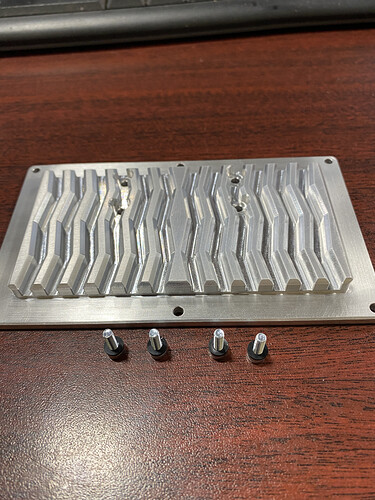

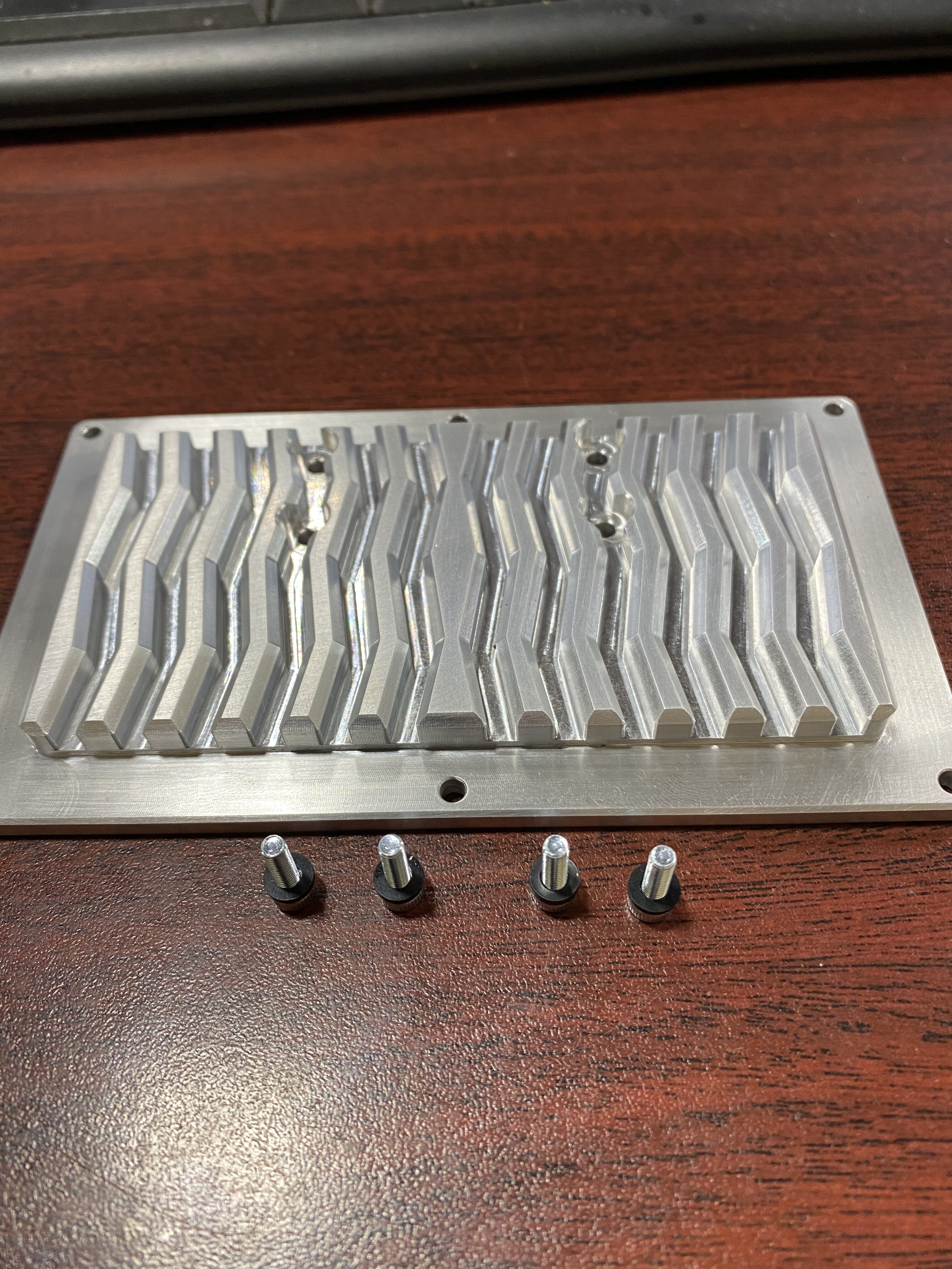

You should consider adding some of that gasket to the deck on the interior side of the threaded inserts. Right now it looks like your enclosure fasteners holes are a path for water ingress
The inserts don’t go all the way through the deck so there’s no way water could enter.
Through the enclosure holes though
Sorry, i mistyped - the enclosure screws/holes are the water ingress pt.
I put rubber o-rings between the washers and the enclosure so that’s all good.
:+1:t3:I do the same thing for my heat sinks
Yeah, those are a lifesaver. They also dampen the vibrations so the bolts don’t come loose even if you don’t loctite them (which I don’t).

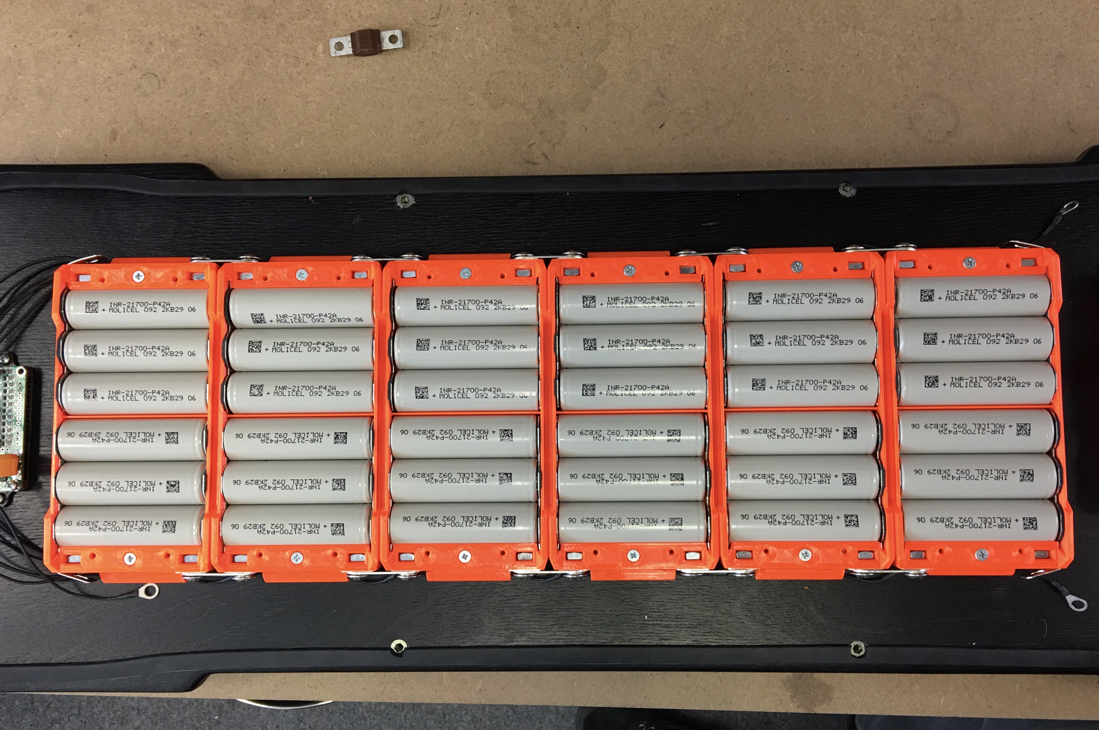

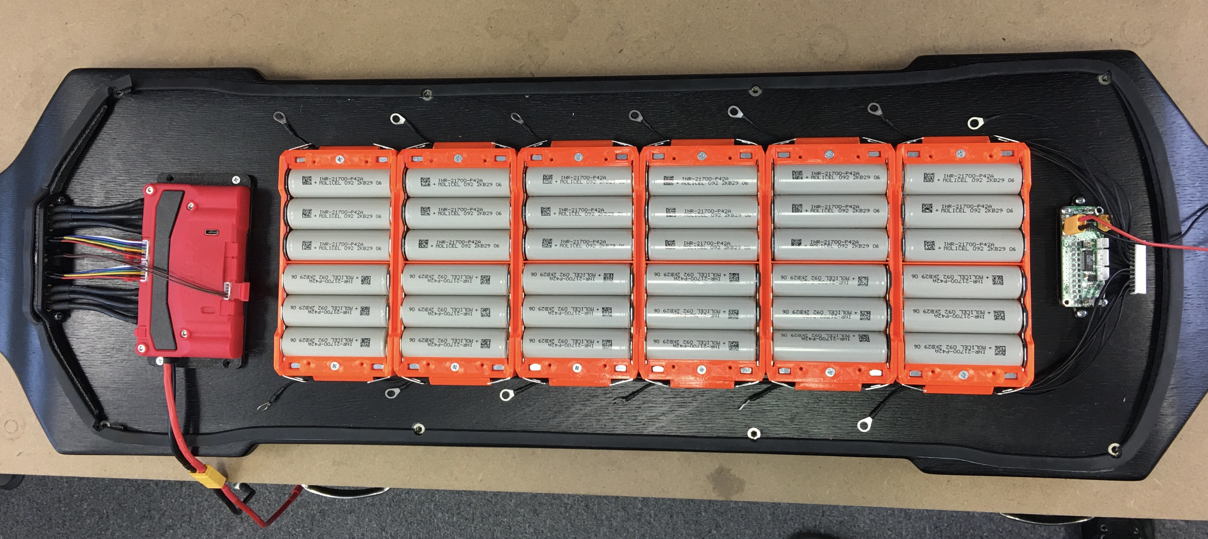

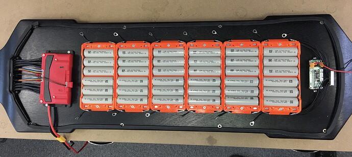

Lot of progress yesterday and today!

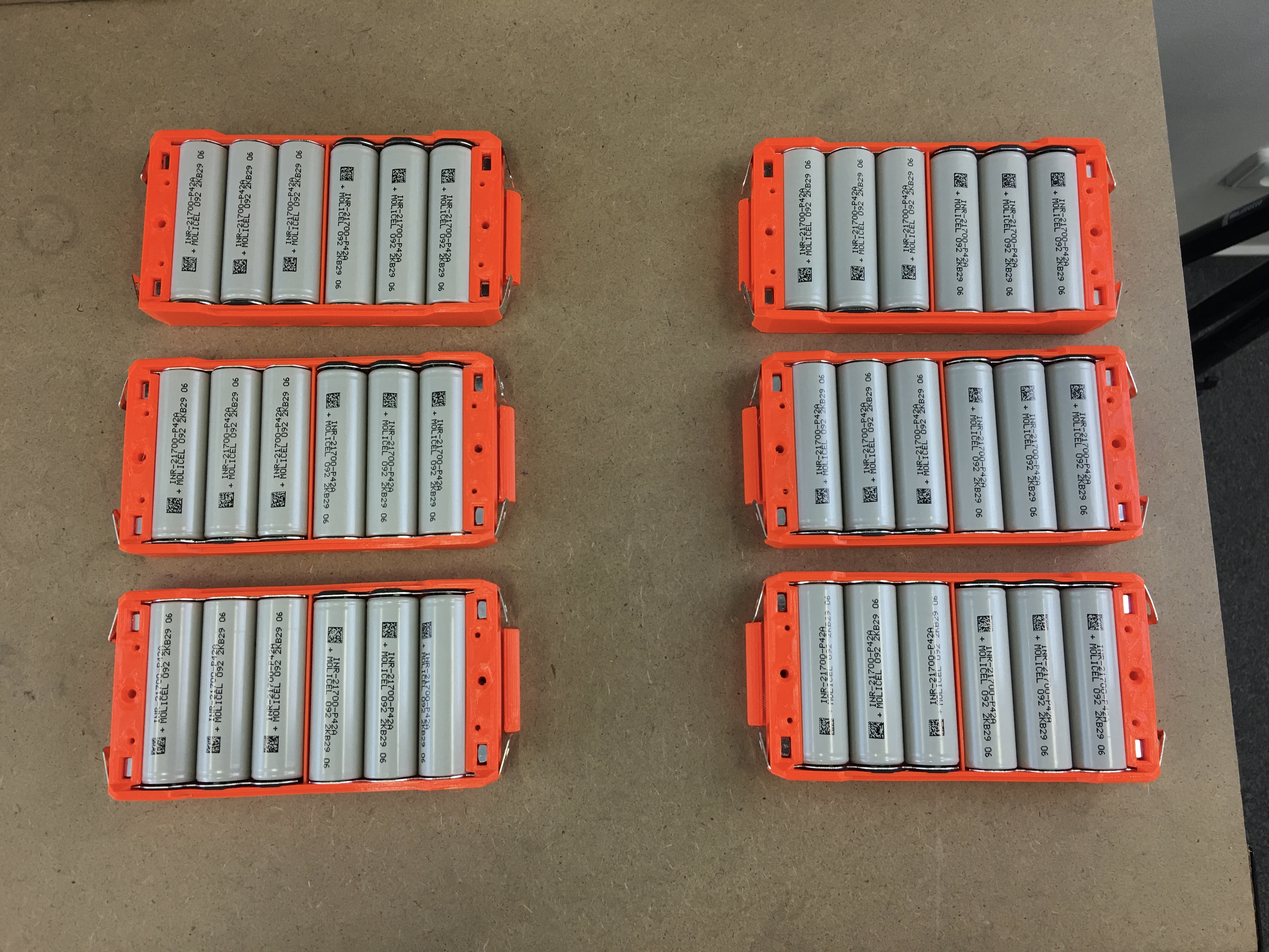

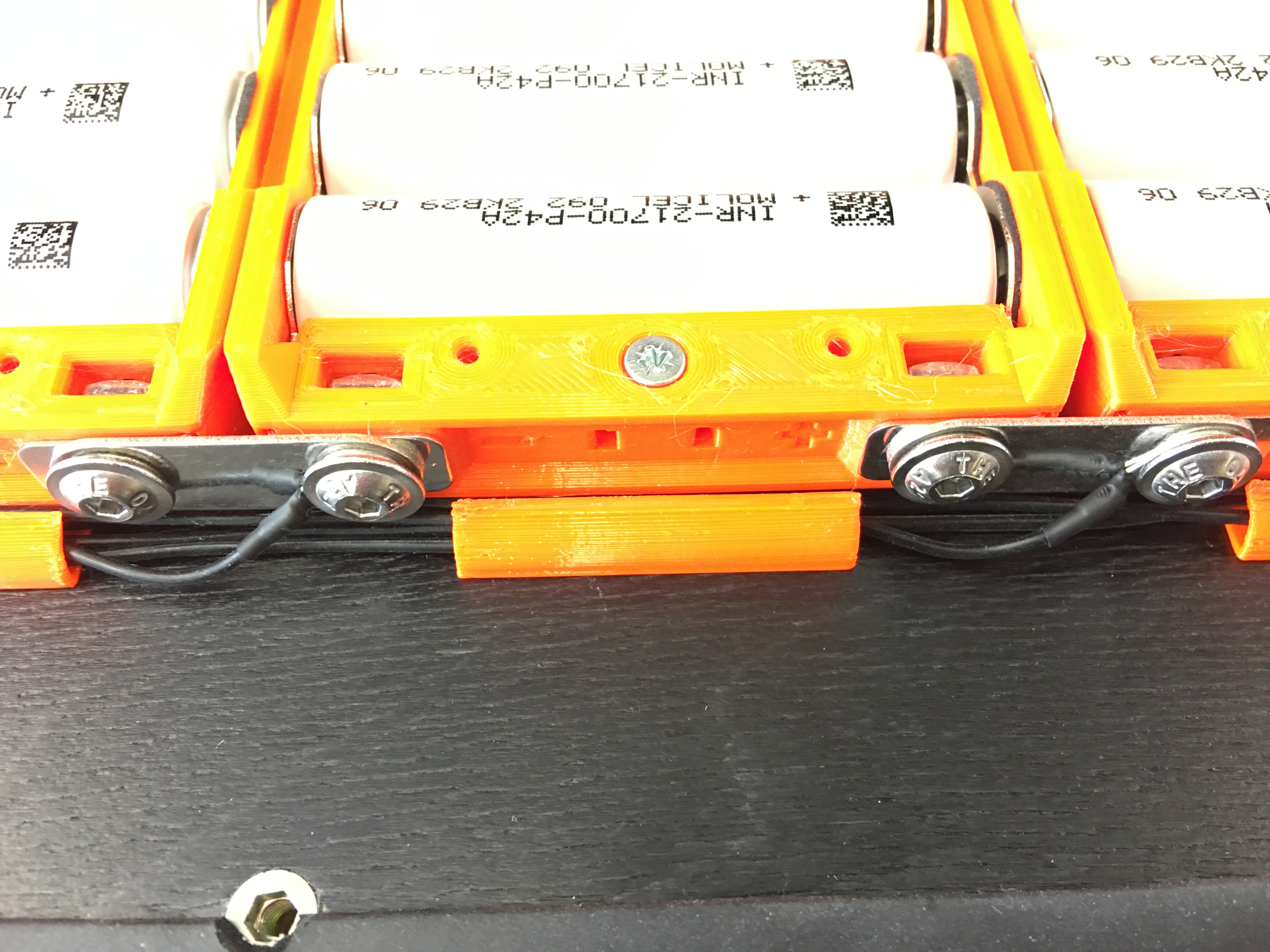

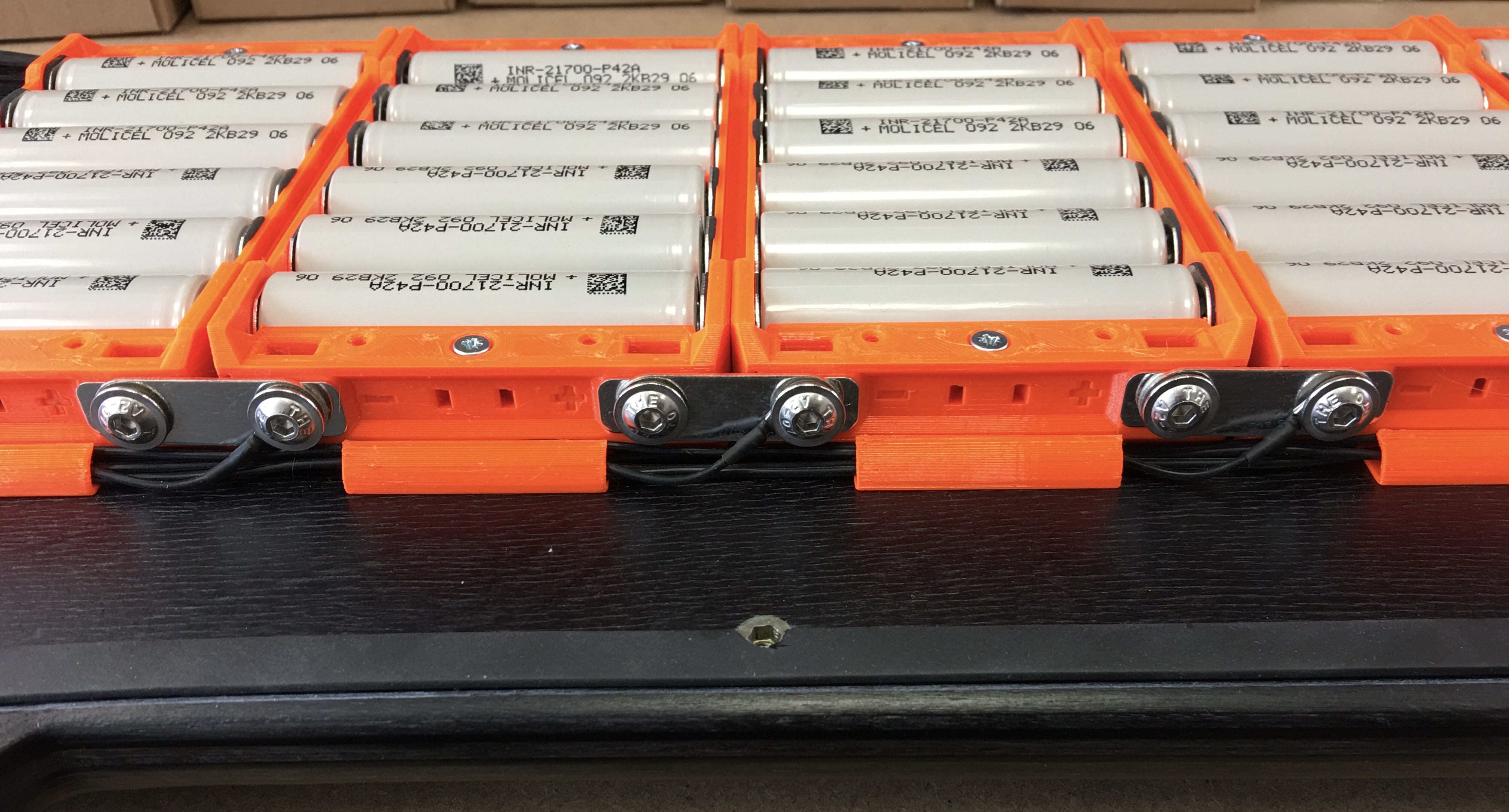

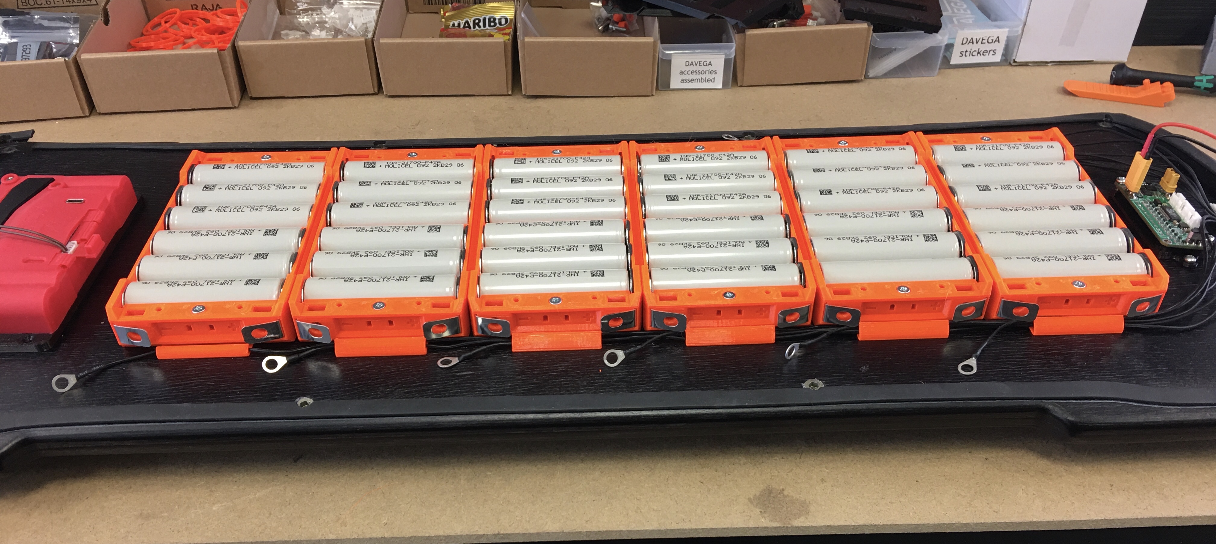

I finished the NESE battery pack, made the balance leads and installed the FlexiBMS.
Earlier I decided I would keep this build as clean as possible and won’t use any tape…
but… I really wanted to do a test ride today so I took some shortcuts. :slight_smile:
I then quickly threw in a PPM receiver and a good old UART Metr (so that I have some idea about the battery state or actually even about whether the board is on :)).
Installed the eLofty drive from my burnt down board. (I wasn’t sure if it would still work. It still works great!)

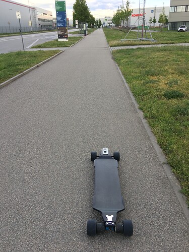

Aaaand… I took it for a spin.
No griptape, no DAVEGA, not even a charge port :laughing: but it worked! Here’s the log of my 7km test ride:
I didn’t do anything crazy of course. My primary goal was not to get injured (check) and not to put anything on fire (check). :sweat_smile:
Some first impressions:
  • I need some griptape. :slight_smile:
  • It’s loooong. Initially, I didn’t even stand drop-to-drop since that felt as a very very wide stance. I did give it a try later though and it wasn’t bad. I actually started liking it near the end of the test ride.
  • It’s very stable. With no grip tape and on shitty TKP trucks and with very loose bushings I still felt confident above 40 km/h. No problem at all.
  • I like it.
I’ll put on some lucid grip and try some other drives as well. Looking forward to do more testing.

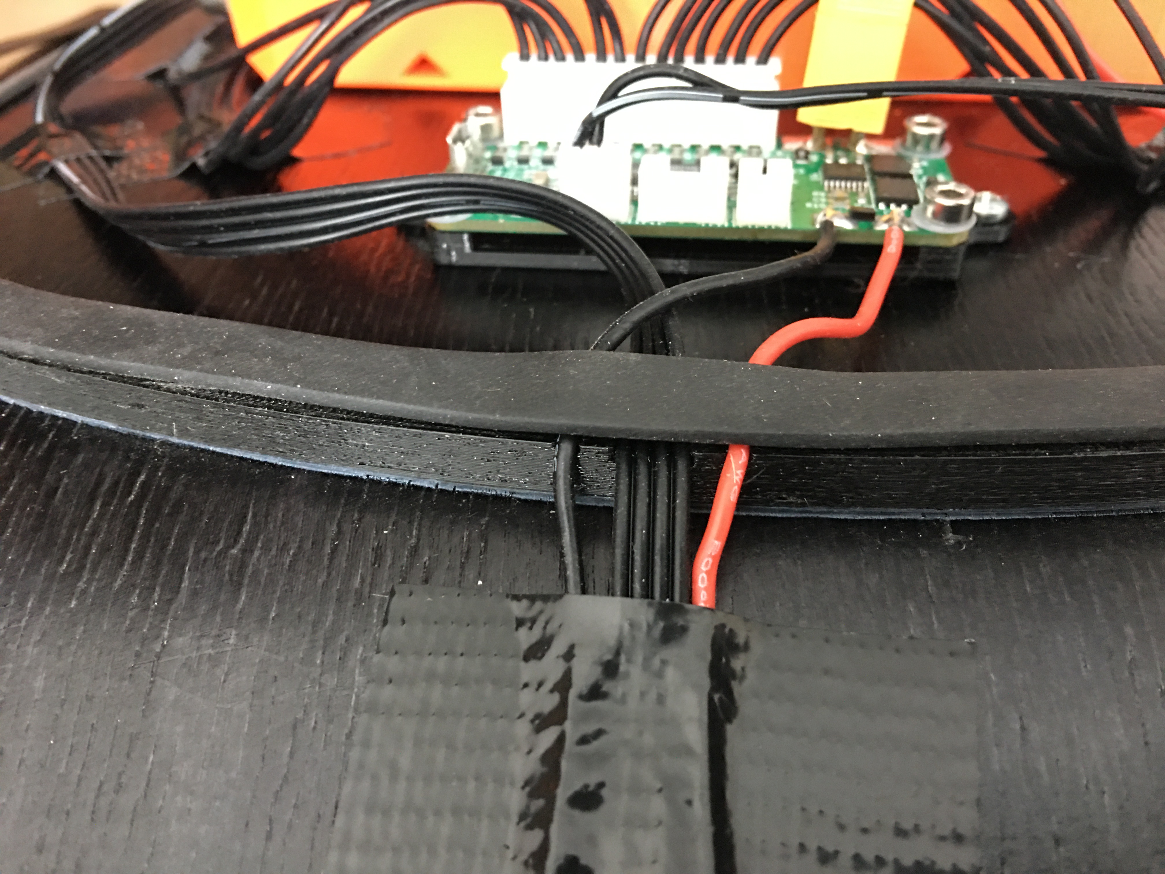

More progress. I installed a charge port, DAVEGA X, Metr Pro CAN (while I’m waiting for the Metr LTE) and I wired the CAN from the FlexiBMS.
Here’s how the cable are routed through the front filler part. (I know I said “no tape”. I’ll better myself. :slight_smile: )
I printed a thin riser to hold the charge connector and also to create a channel for the DAVEGA cable. I added a little hinged cover, which came out quite nicely.

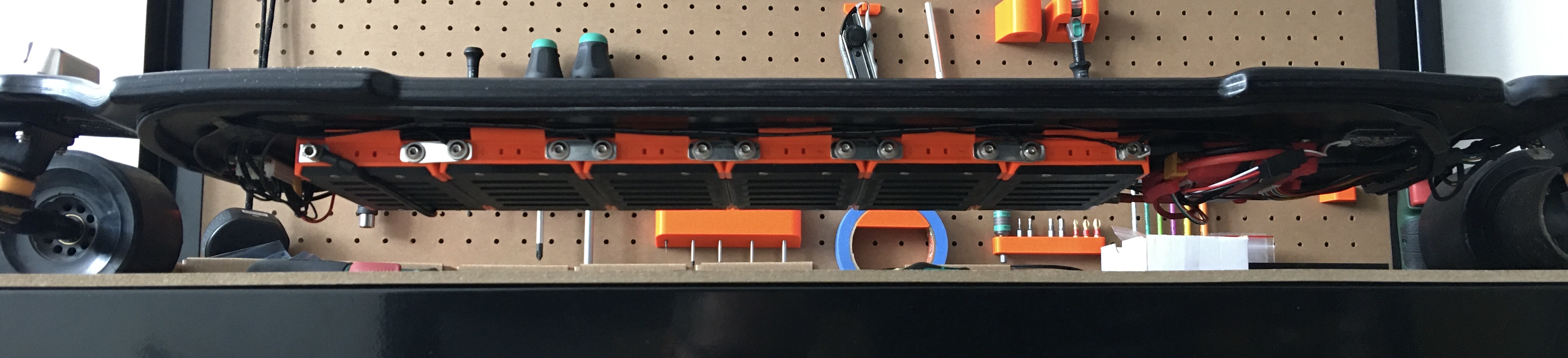

Everything is built into the deck. The enclosure is just a lid and doesn’t carry any weight. This is great for tinkering with the internals since I can open it and close it again very quickly and with no hassle.

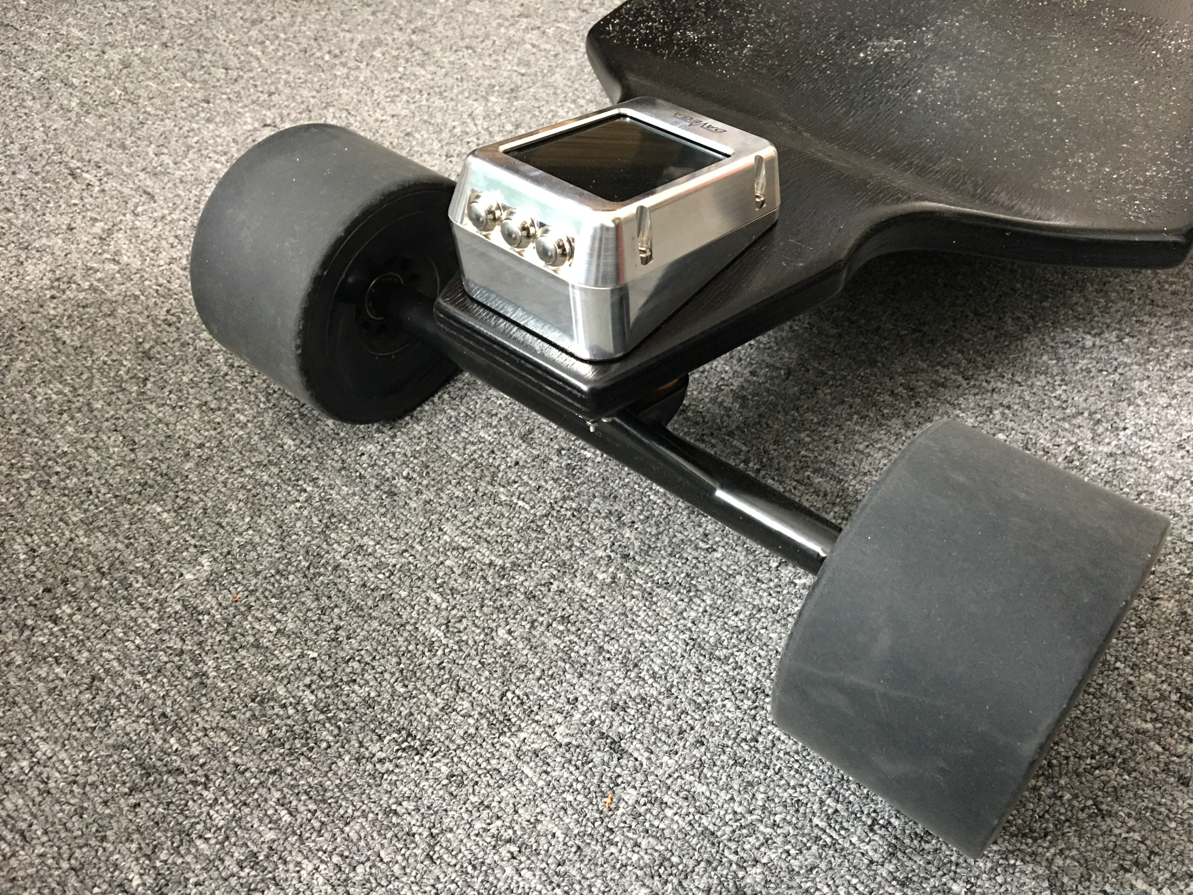

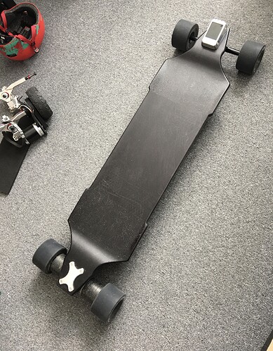

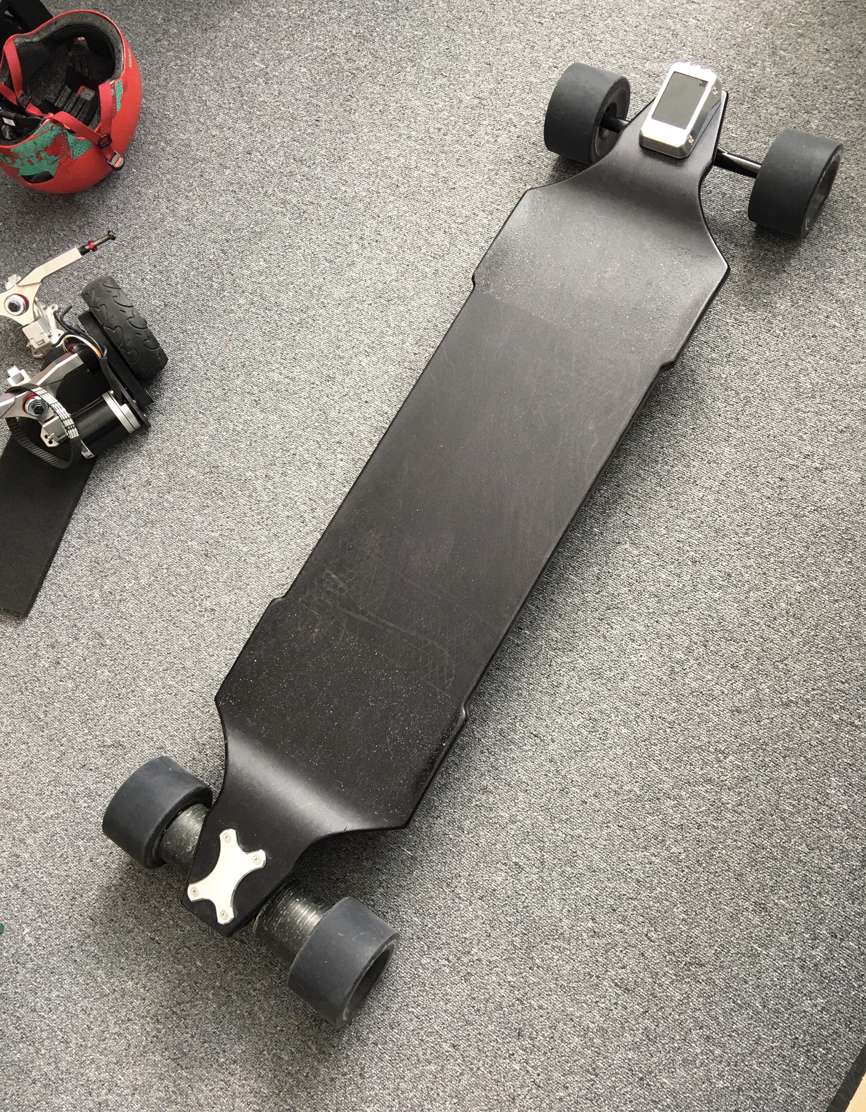

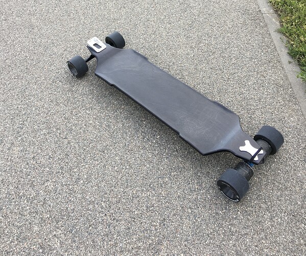

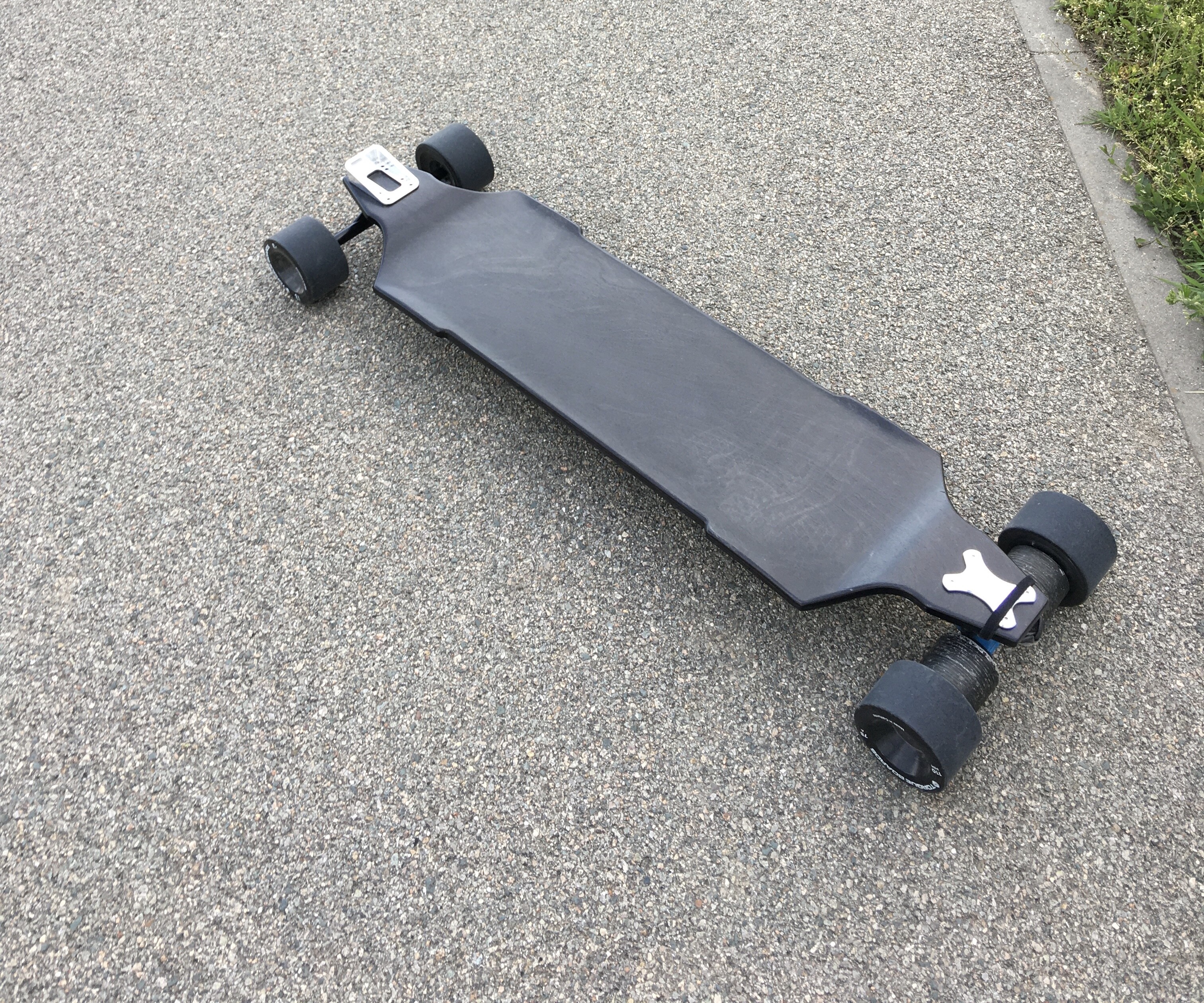

Some pics of the finished board. I’ll be testing RKP trucks with a belt drive soon (you can see it in the background on one the picture below).
I’m also testing the new DAVEGA angled baseplate. It’s rather meant to be reverse mounted on MTB decks so that it compensates the typical 30-35 degree tip angle to 15-20 degrees.
On a flat deck, it gives a 15 degree tilt towards the rider, which helps readability since it reduces the sky reflections. It looks a bit bulky though. I’m still deciding whether I like the look of it or not.
I have done another test ride today. I added some lucid grip since the last time which helped a lot. There’s nothing I dislike about the deck so far. It’s comfortable and easy to ride. The feel is very different from my 40" EVO that I use on daily basis. That’s mainly due to the much increased length which makes a lot of difference in the stance. I’m still getting used to it. It’s definitely not bad. I don’t miss the concave. I do like the deck.

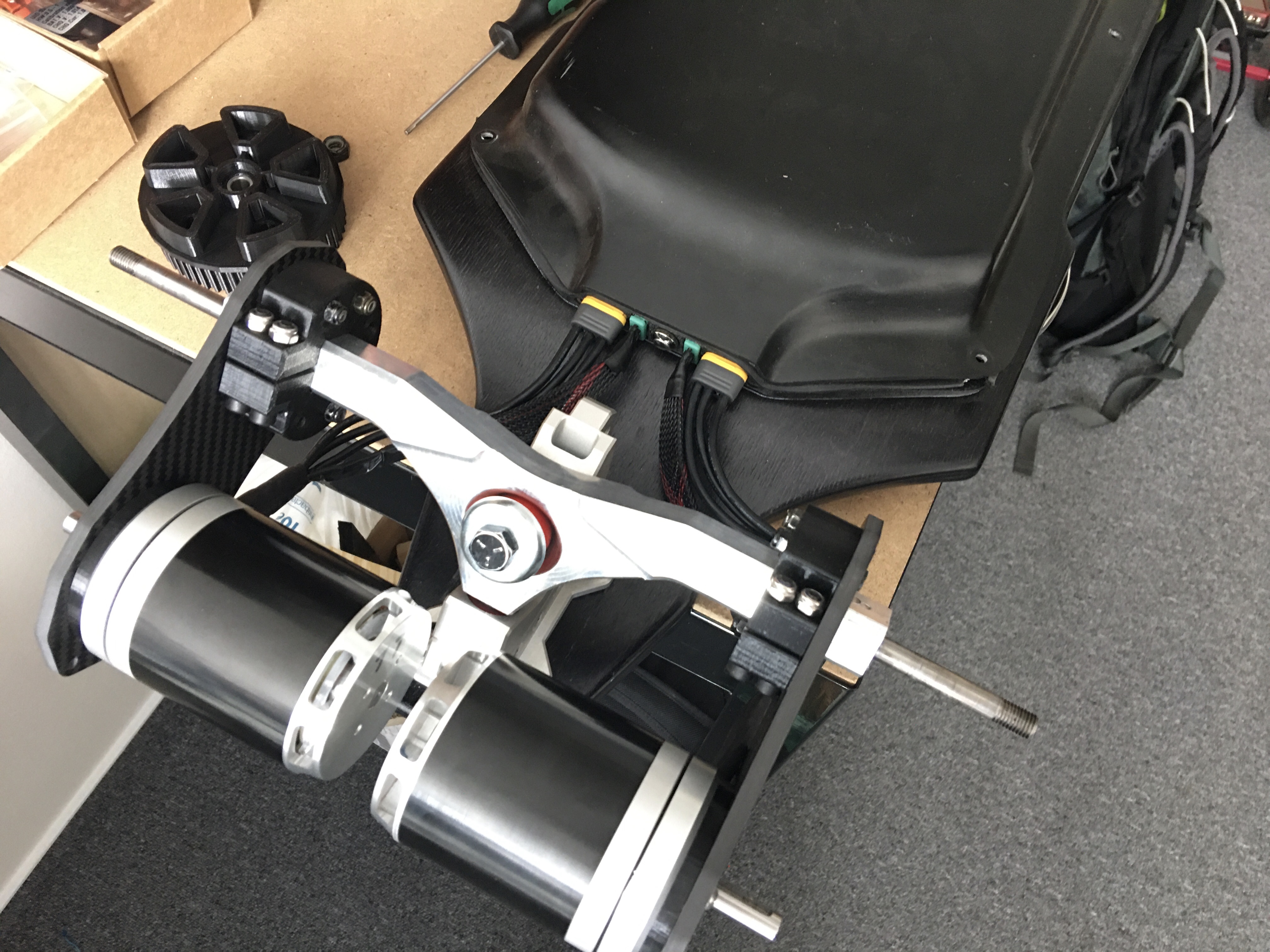

Testing a different drive. It was a lot of modelling and 3D printing to make it work. Clamps for the mounts; spacers between the mounts and motor cans. I also needed to customize a model for Evolve pulleys that I found on thingiverse to make them fit the axle. But, finally, everything fits and seems to be working well. I just need correct pivot cups for the trucks, which @Lobap promised to send me but he’s been MIA ever since.
