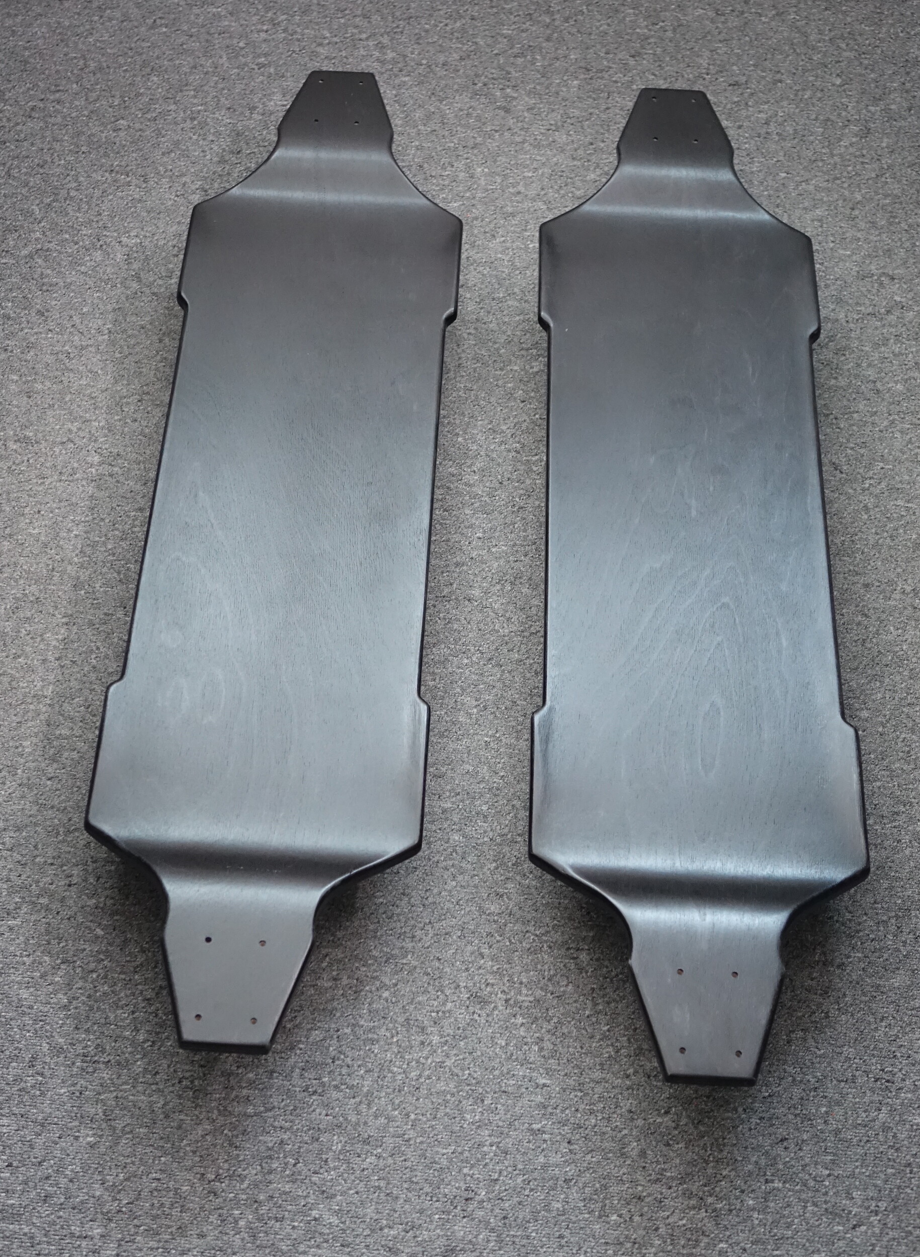

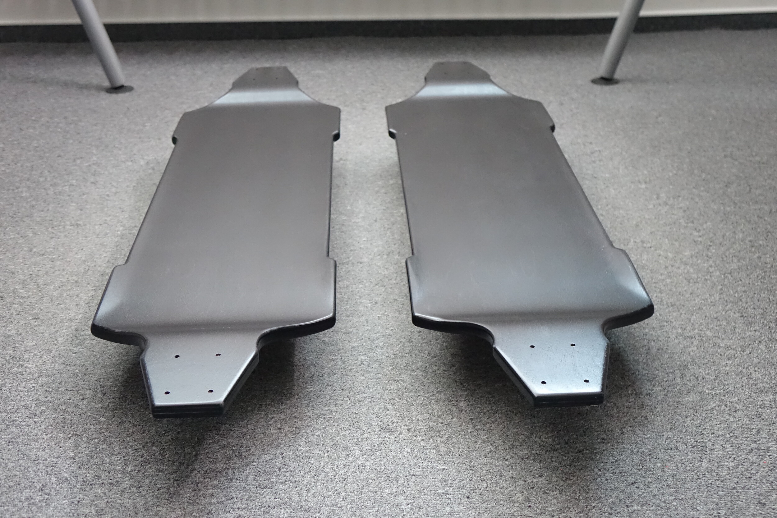

Two more decks came in with correctly drilled holes.
I have almost everything ready for making a build with this deck. I’ll start working on it soon™.

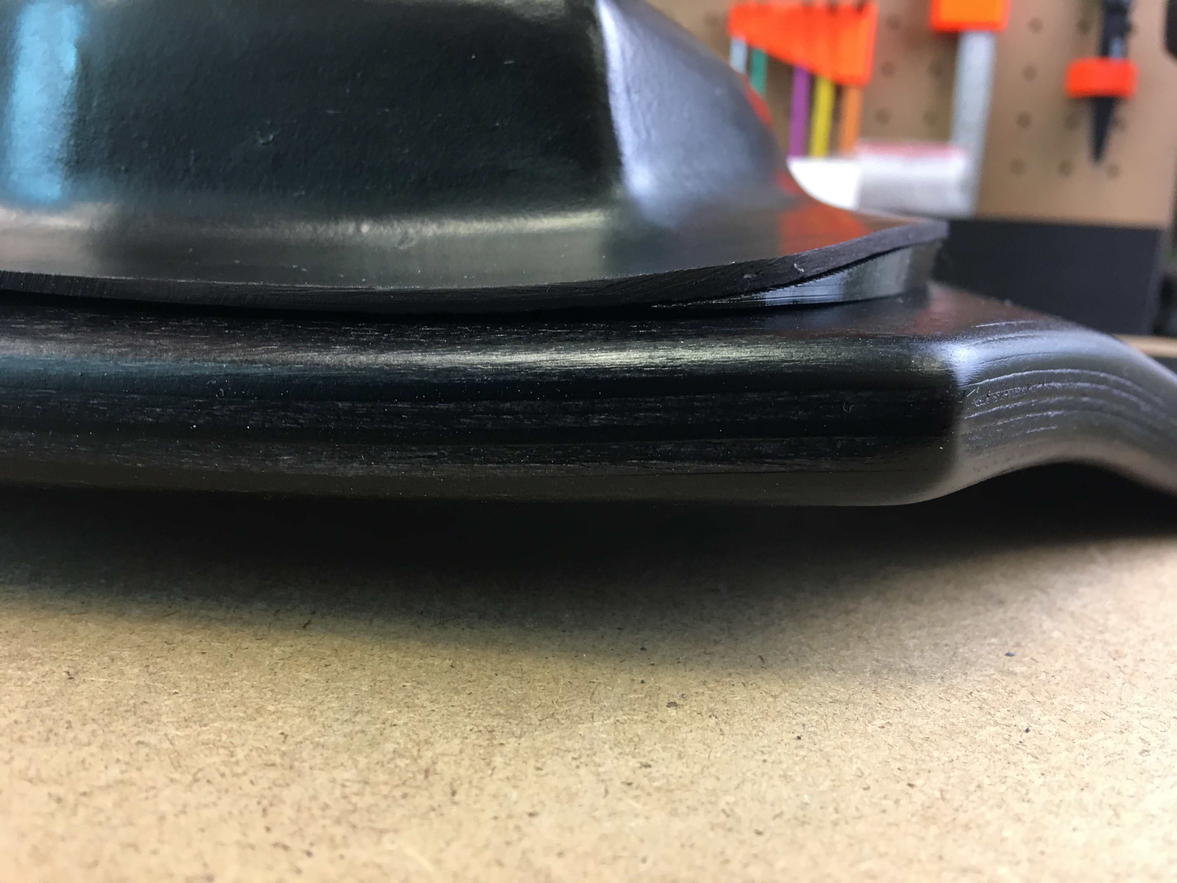

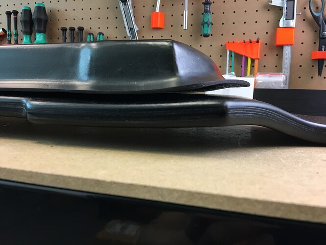

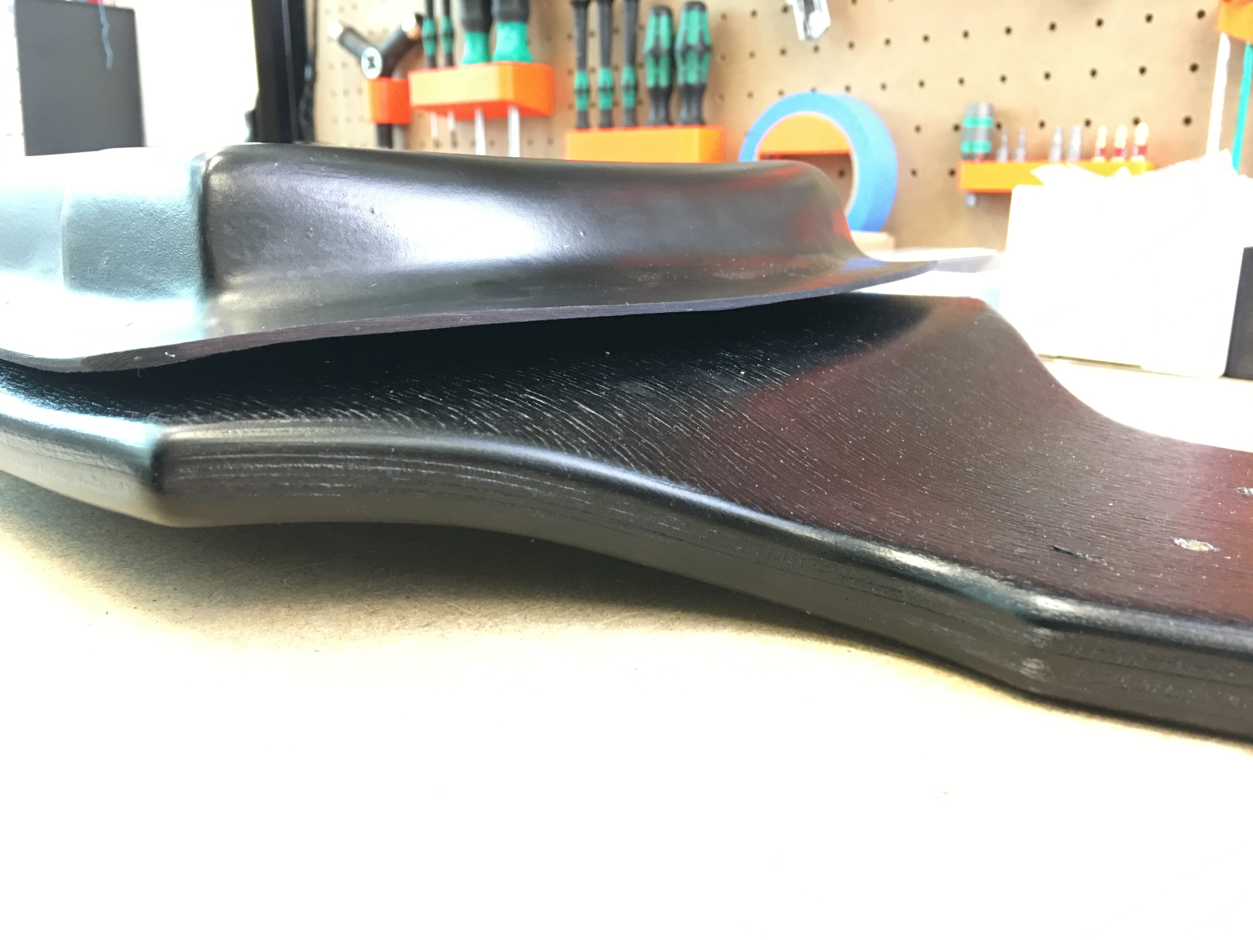

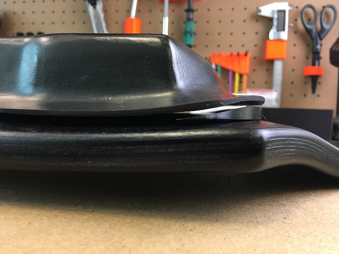

I also spent a little bit of time on the enclosure. As you might remember, Ben’s RE 44 enclosure fits the shape of the deck nicely but not the profile. There’s a gap at both ends:

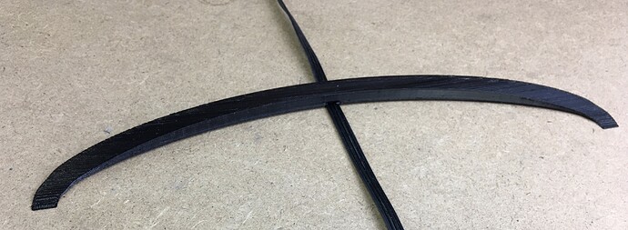

I modelled a piece to fill the gap and printed it from TPU. I only needed one test print. Either I’m getting good at this or I was very lucky. (I suppose the latter. :))
I added a little notch for a DAVEGA cable.

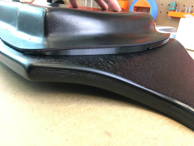

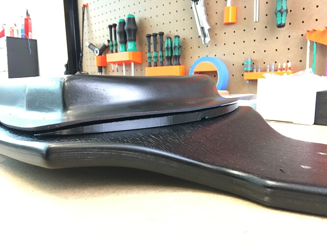

Here’s the fit without any pressure on the enclosure.

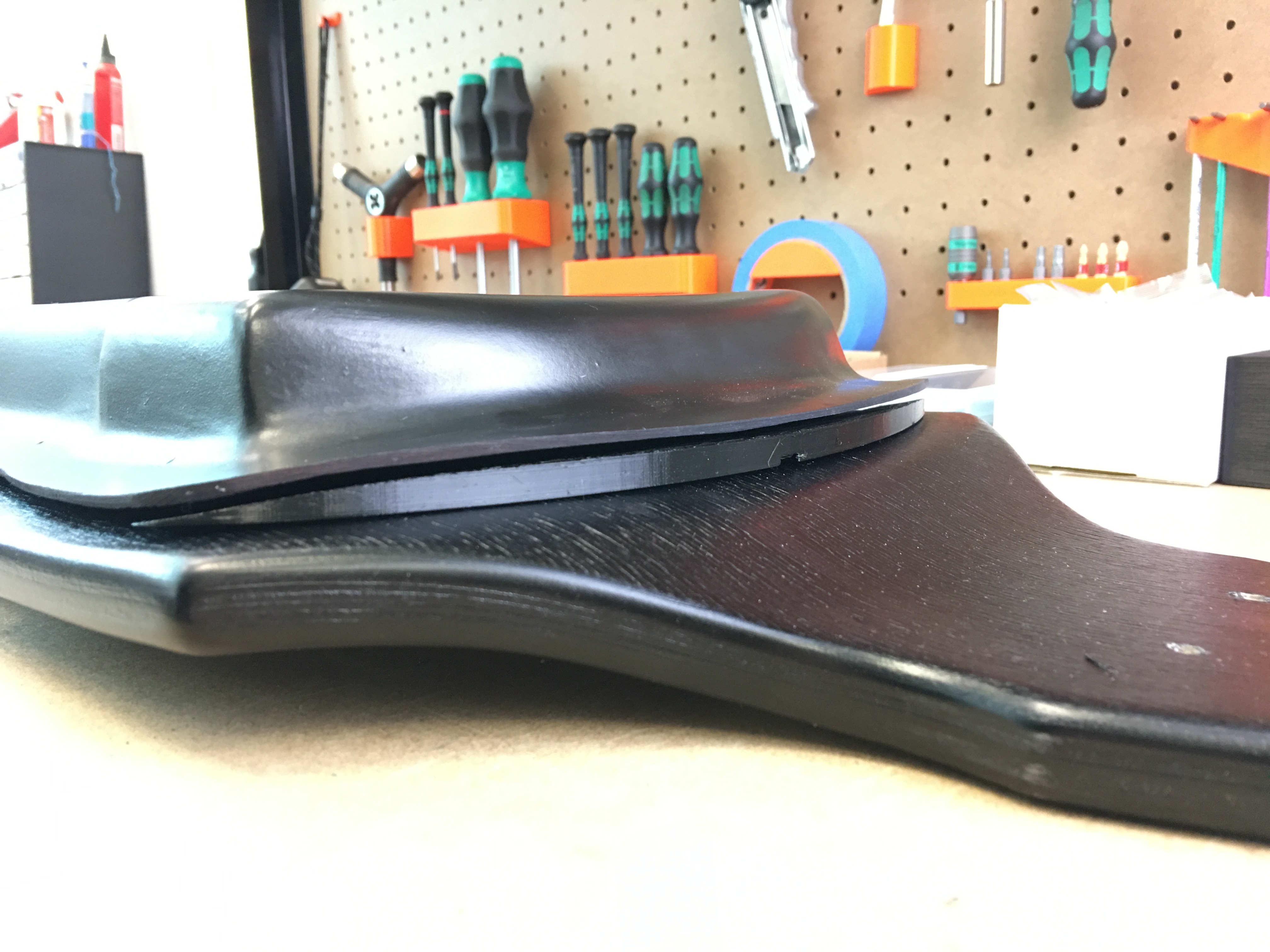

And here gently pressing it down with my left hand while taking the pictures with my right hand.
Looks pretty good. Now I need to do the same for the other side. That one has a cable outlet, which I plan to fill in but also add slots for MR60 connectors and potentially the charge port and on/off switch. Hopefully there’s enough space for everything. Then the enclosure will merely be a lid, with no holes in it and detaching it from the deck for servicing will be completely hassle free.
