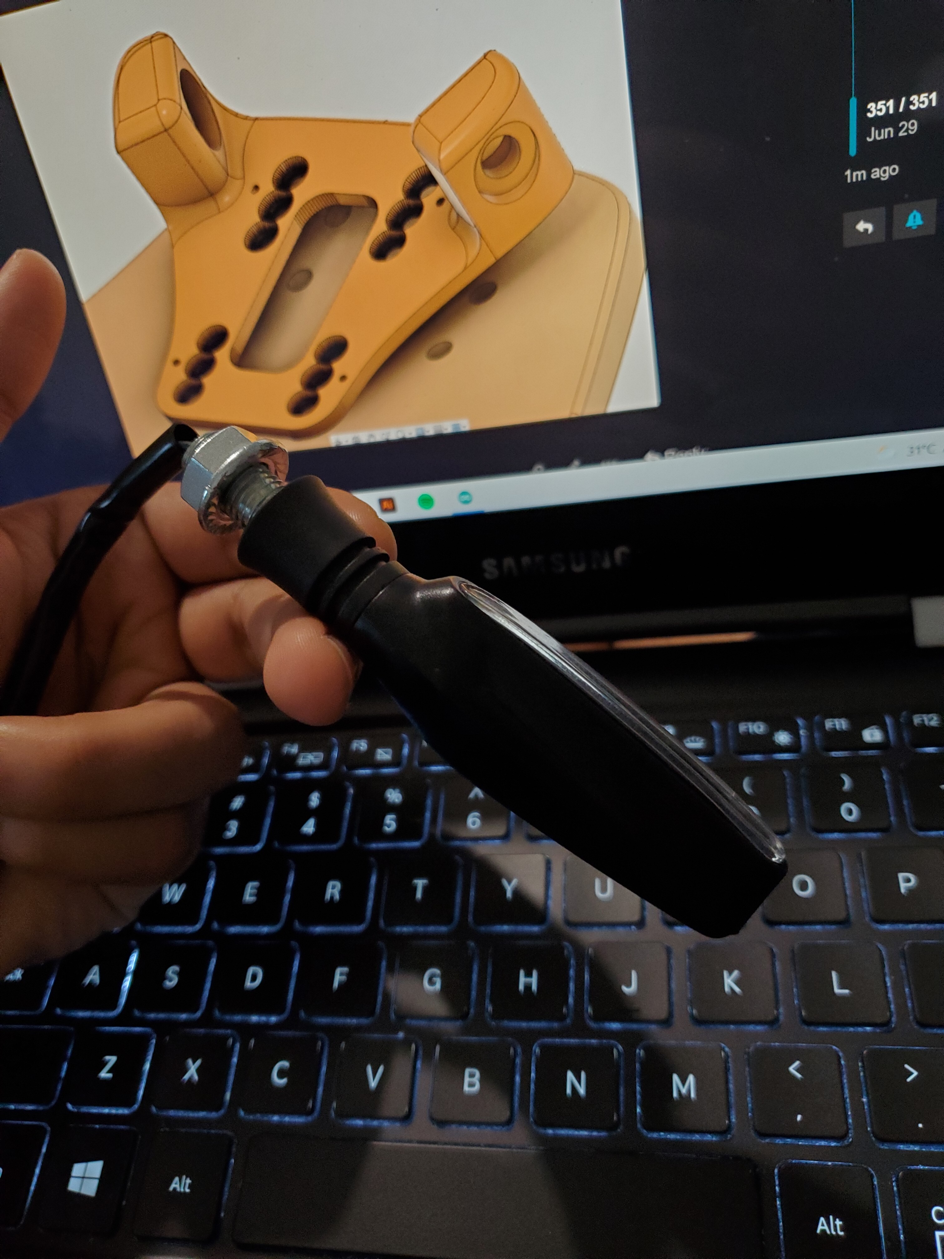

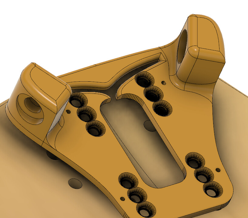

Heres the front turn signal mount so far. Not sure about wiring. Mostly done the headlight mount too.
What’s that black screwdriver handle looking thing in your hand there?
That’s the turn signal :rofl: it’s used in motorcycles
Hahaha that’s awesome man. How do you control it? Button on the remote?
Yes with this Bluetooth remote module connected with arduino. The light flashes as soon as you give it a 12v power source. I’ll use the arduino as a gate to control the 12v power to the light using an n channel mosfet (it’s like a switch).
Ohh right I remember seeing that in the earlier post. Holy shit man your board will have more electronics and buttons on the remote than anything I’ve ever seen lmao.
A true tony stark style build. Only thing missing is voice control

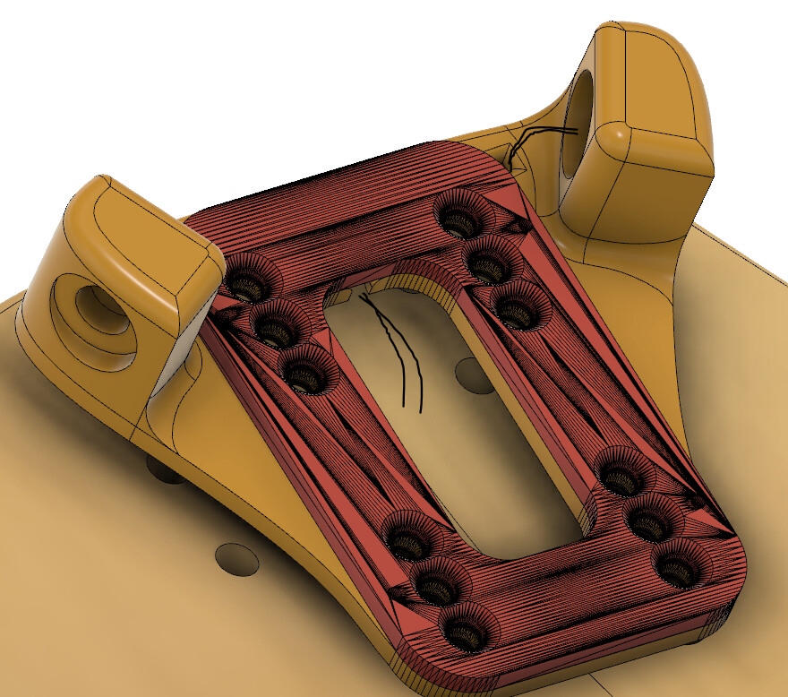

I made this little channel cut out for the turn signal wires. It will go under the davega and wire through a middle hole I will make in the deck for the davega.

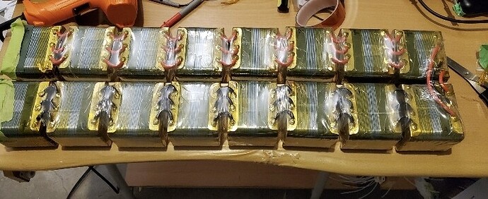

Wrapped
Bms tomorrow
