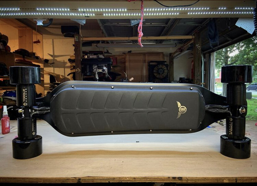

Hey guys, really liked this post and I figured you’d like to take a look at this beauty.
