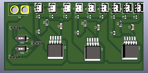

In the eternal effort to make upgrades to my board, I discovered that I would not be able to power the ESC fans I wanted to add, while also being able to power other stuff like any lights I wanted to add to the build. This set me out to learn how to design PCBs and solve this issue. And so, a few days later, I present version 0.1 of the VPU!
Its very obvious that this thing is very early in development, but I wanted to share it early and add functionality that will be useful to others, on a very space efficient board (which it currently itsn’t).
Features
  • 60V input using XT60, with 3 outputs at 3.3v, 5v and 12v each with 1A of power available.
  • All outputs fused
  • PWM splitter (1 receiver to 2 escs, 2 receivers to 1 esc)
  • More to come!
I’m looking for ideas on what else to add to this. While the board in its current state serves my purposes, I definitely would love to expand it further. While there is definitely options out there for powering things like lights (TTL) I wanted this product to be simpler whilst also being fairly cheap and small. My only aim for this is to keep it cheap which is why I will be assembling using JLC’s SMT assembly service.
The next step will be to tidy up board layout and make it more aesthetically pleasing and also ensure all traces are capable of carrying the current they require.
If anyone has any features they want added please let me know!

So If one fails it automatically switches to the backup? That’s sick!
Exactly. There is also dip switches to make the handover manual. Feature was designed for @b264 specifically, with it being bidirectional being very useful
That’s cool! Time to run 4 receivers @b264
very nice and definitely useful, I would go for 2-3A output capability
It would be nice to have one of the acc outputs dimmable from the pwm. Should be very easy to implement. And would make brake lights for something along to that serviceable
I definitely wanted to do something with those outputs and the PWM, but just couldn’t think of a specific use case. I’ll have a look into this
At a specific voltage? Each voltage is capable of 3A, but is split between the 3 outputs. if you wanted 3A@12v for example I could go down to 1 output and achieve this
yeah then in that case maybe higher overall amp output, so could run 5v addressable LEDs and 12v head/tail lights

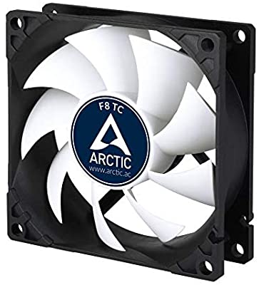

I’m always amazed at how many technologies other industries have that just don’t quite have an implementation in esk8.
Here’s a temperature controlled case fan:
a smaller version with your power unit would be golden.
Or, have a port on your unit that regulates voltage depending on a temperature probe? Good for peltiers and external fans
So I have a couple 30mm raspberry pi fans I wanted to add to my build, which is the original aim of this project. Maybe like a 60mm fan to make it worth while, but it could totally be controlled by a thermistor. Will look into it

I can integrate smart load switches that shut down the output when the output current limit is exceeded.

Does the LM2576 have a current limiter? That’s what I’m using here, want to make sure my component choice is sound.
