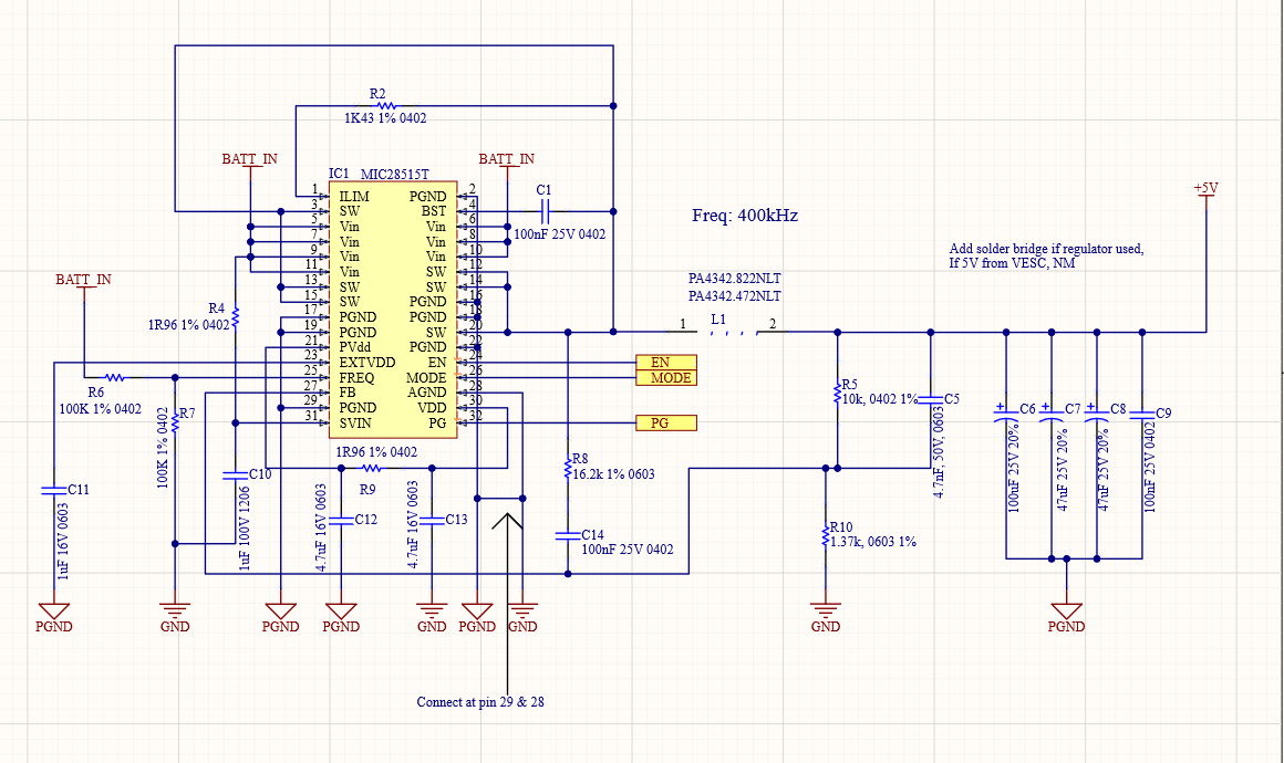

I have a design I can share with a decent buck converter I found that takes up to 75V. Never really finnished the design but maybe you can :slight_smile: (it has control for lights as well ;))

This is the converter part.
I havn’t tested it in a lab or anything, but it looks promising and can handle 5A output.
This is close to the refrence design in the datasheet, but I chose a better inductor to be far away from any saturation.

there’s a tiny ferrite bead that the OP thought would be a suitable inductor.

The schematic I provided goes up to 100V with 1A output. The design fits in a form factor the size of your thumb.

Have you tested your the design you posted? Is it stable, thinking both no load and full load
Yes, it’s literally in my test ESC and it worked in some antispark prototypes.
