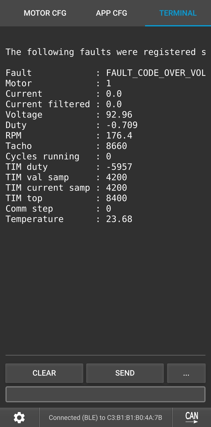

Well thats not good. Actual battery voltage was 79.5V.
I forgot but I will lower the voltage max like you said before.
(This is on a Onewheel with poor construction causing odd behavior)
Did this happen during regen? Says that no current was being drawn at the time of the fault.
Not sure 100% but I think I was just riding around grass getting wheelslips and stuff. Riding quite mellow, I think it was more of an anomaly than a clear issue.
