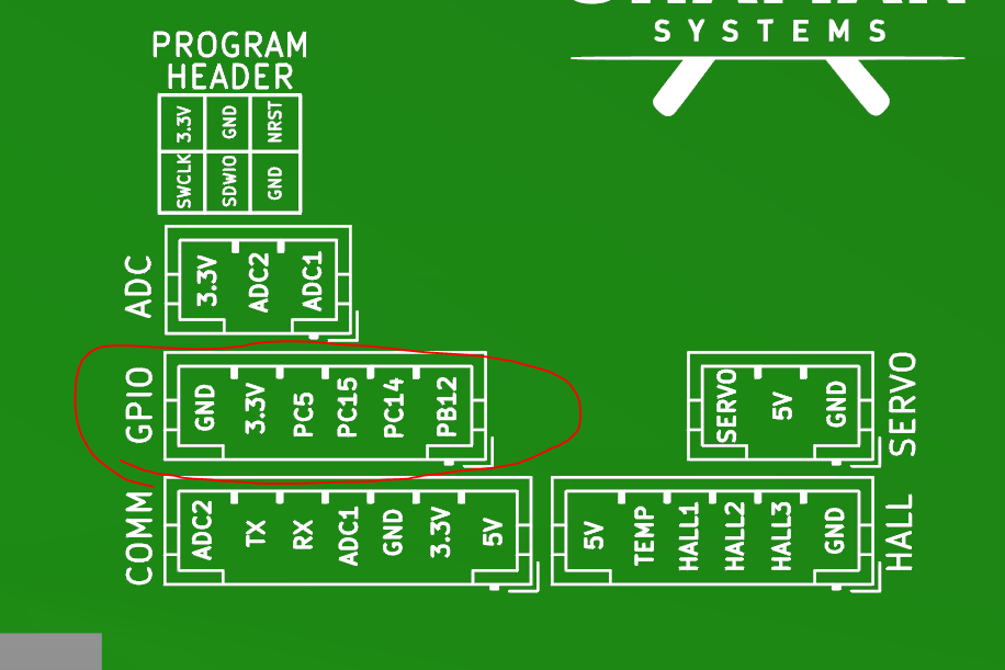

@shaman. What is GPIOB 7 mapped to on the little focer pins?

That’s the fault signal for the red LED.
The Spare GPIO connector is there to access the spare GPIO pins for whatever you want! Use these.
