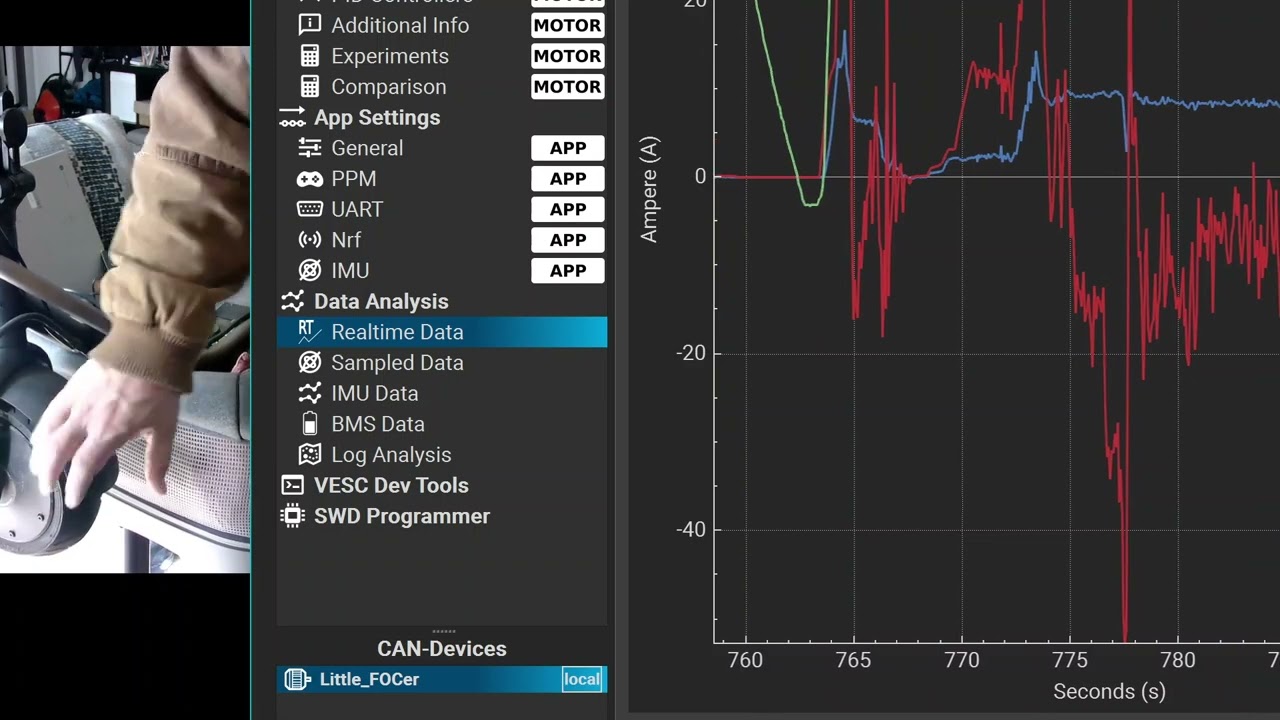

New Firmware. Field weakening from 21,000 RPM boosted REV hub motor, to 45,000 RPM (erpm) after Field weakening. Now need to go try this out on the street and see if I can blow some shit up
EDIT>. i didnt’ screen record well… My bad
I have a onewheel hub motor id love to try running with a foccer with field weakening on.
I don’t believe balance app + field weakening on vesc play together at all.
Ok. Field weakening was a non issue
Can’t get metr to connect to this vesc. Not sure what I’m doing wrong. So can’t get you real time data etc.
I do know I was front hub only and hit 33mph vs 29 with dual motors
Can going to use a second vesc and get the rear motor going and see if I can’t hit 40mph. On a boosted rev 12s

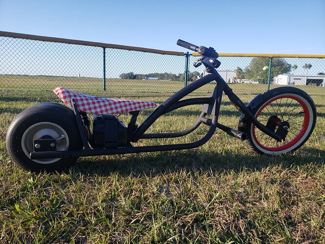

Definitely not a self balancing vehicle. I’m using a onewheel hub motor as a rear wheel for a mini chopper.
Holy shit that’s cool lol
