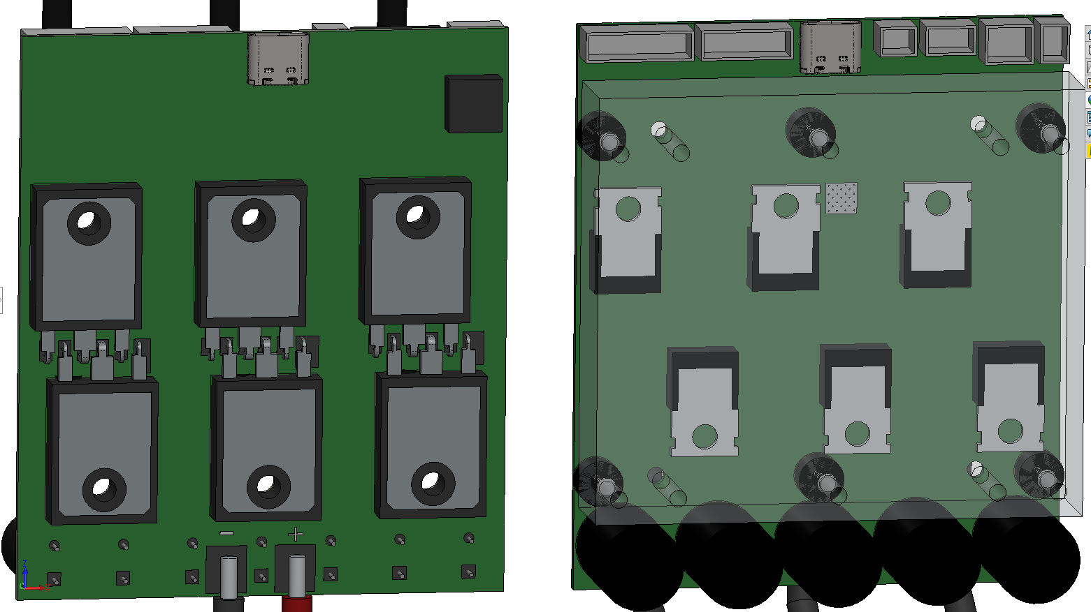

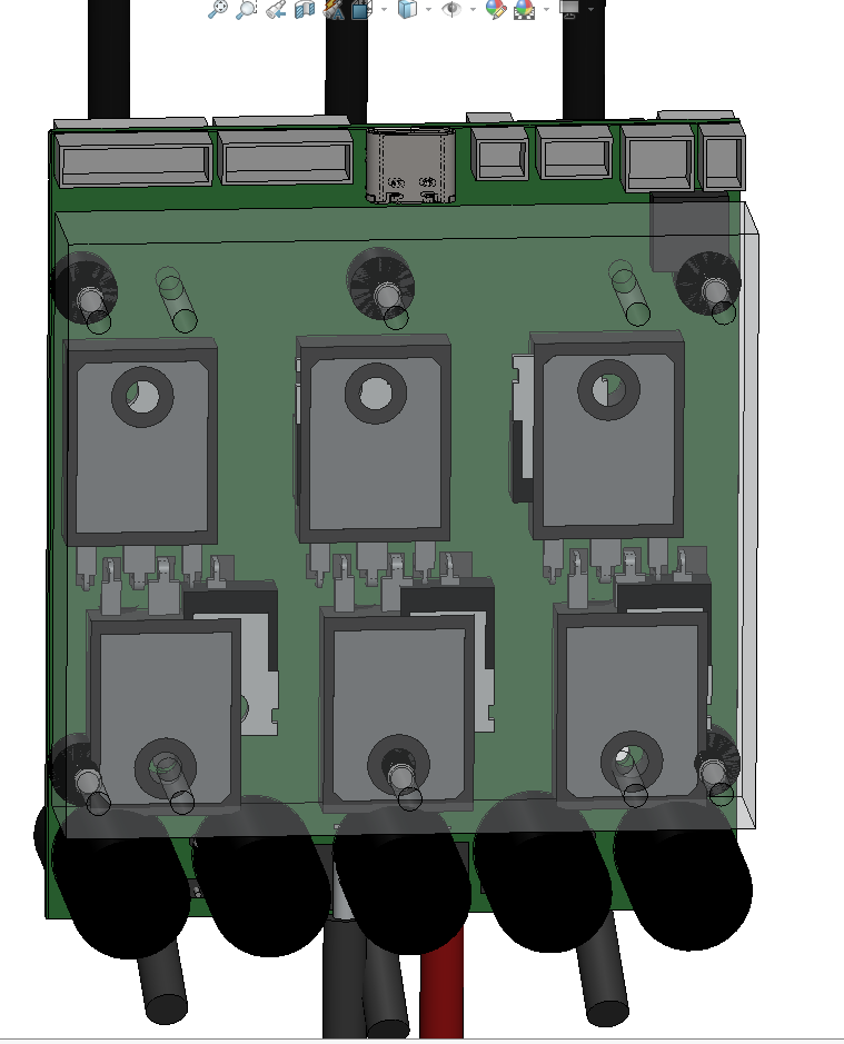

I updated the specs of the first post for the V3. You’re thermal management has to be on point though to get these current numbers reliably.
V3 FOCer OW export step.STEP (3.4 MB)

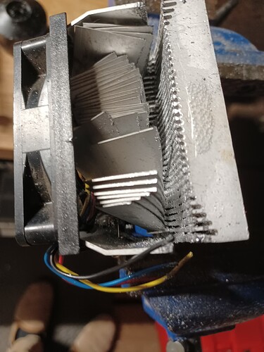

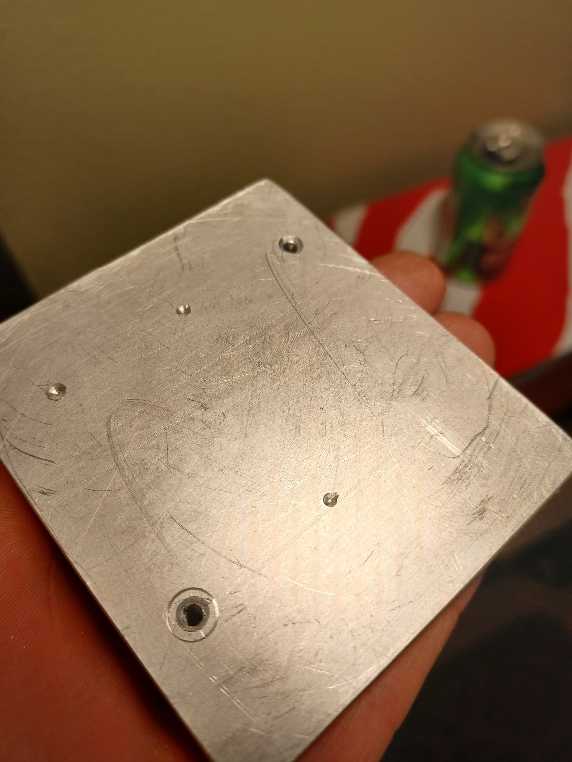

Anyone following this cut more off. You want flat on all sides.

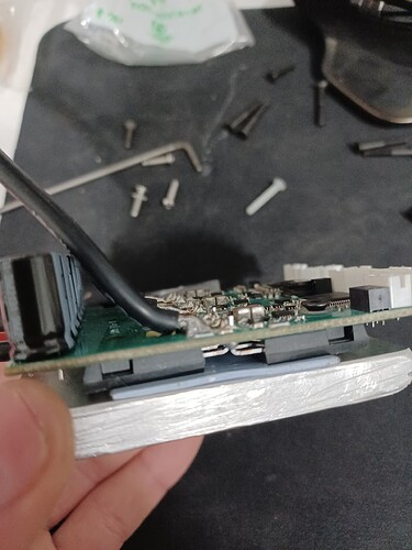

I think I did this right.
My concerns about metal dust getting on the ESC may or maybe not warranted.
Any input?
I’m thinking you’ll need the thermal pad, or pads, to reach out past the ends of the FETs. With the mounting holes practically off the pads you aren’t pulling the FETs straight down onto the pad and sink, you’re torquing them at an angle. This reduces the pressure on the pad at the end away from the screw hole and increases the thermal resistance of the pad (increasing the FET temp).
I’d also recommend using standard round or pan head screws. Those flat head screws are pushing out sideways as much as they are pulling the board down. This stresses the board and lowers your clamping pressure.
Screw down all six FETs evenly too.
Yep things I should fix before even bench testing makes sense.
I will cut the small thermal pad I got to make it cover all fets completely.
Hardware store only had this kind. I could take the recommended screws off a dead esc but they were a tad short. Is the little nylon washer really not solving that issue though? it is hard to see there. I thicker one would seem to me to make these countersunk screws act as button heads.
Perhaps, but standard screws would be the best…no wondering. :slightly_smiling_face:
