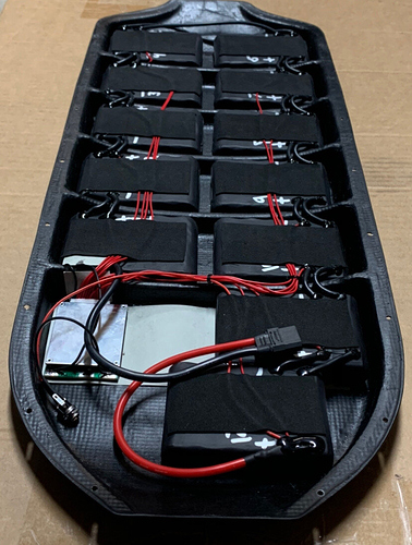

what cell layoff are you doing with the proto?
12S4P Molicel P42A, two of the p groups are split across four compartments so i can get 10 cells across four compartments and 8 cells across the fifth.
Should be fun. Plenty of room for the wiring though, Lacroix made sure of that. The challenge will be making it nice and neat.
most people go with 12s5p, but i know it’s a tight fit. Just wanted to see what others are doing before doing it to mine.

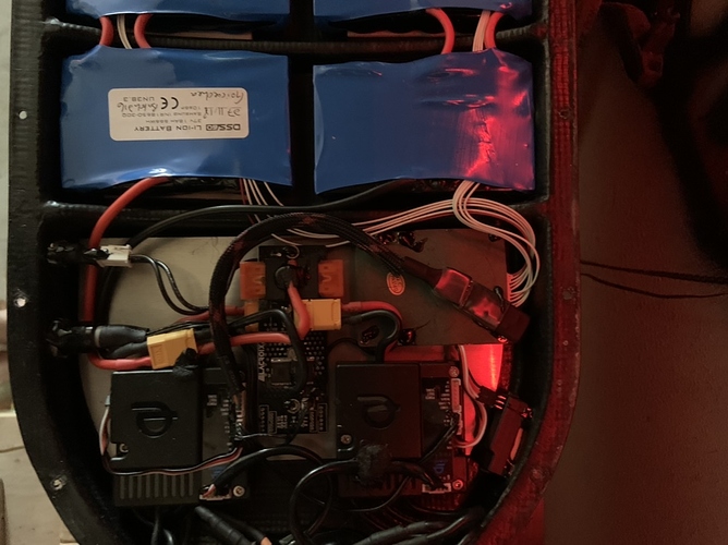

This is the 10S6P 30Q variant of the prototipo. I don’t see how there’s room for 60 21700 cells in here unless they are ditching the mounting plate for the ESCs and eswitch and just cramming things wherever they fit.
Holy hell.
so where does all this stuff go? lol
If anyone here has done this upgrade, i’d love to see the component layout in the ESC compartment.
@Chibatterysystems was lurking yesterday :call_me_hand::arrow_up:
Maybe he might have more pics
Thanks for tagging him. I was about to edit my post to do just that.
Right now i’m stalking his website. Lots of goodness there.
How’s the purple flux coming along?
Building two of them. One’s mine, ones the customer’s. got the decks yesterday, trying to get hold of the man who does the hydro dipping. He lives out in trump country so he may not have the best reception.
But those 12S8P 40T groups i posted above are going into them, trying to finish up the paper and tape on four packs today.
My riding mate just bought this for his prototipo last week.
Get him to drop the enclosure and take pics, i want to see all the things.
