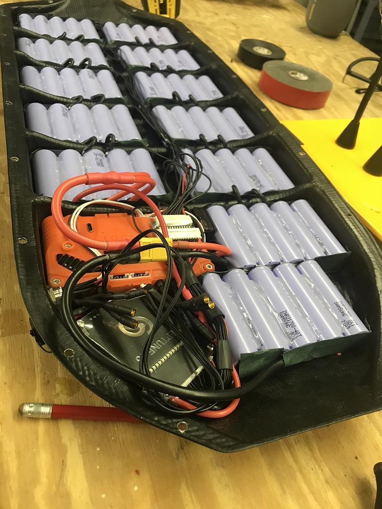

Can a unity sit on top of the BMS? Idk dimensions
This is a photo from @NingNing’s Space cowboy (I know it’s different but ehhh it’s close enough)
Actually nah there doesn’t seem to be any room :joy:
THAT’s what i was looking for. I think that unity could probably squeeze on top of that BMS fine but i’d have some fishpaper between them for sure.
This one was one hyperion made I think @longhairedboy
That is how Chi does it as well.

Just beautiful. Wow that’s a tight fit.

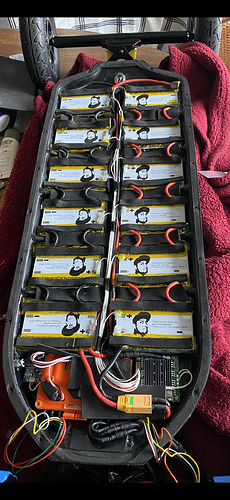

FrannyPack™ layout with a unity.
It gets super tight in that enclosure! You obviously have to go with single ESCs

yeah i see that now. My desire for symmetry was getting in the way of how it has to work. That’s really clever laying it out like that.
I’m managed to get a 12S4P P42A in there without getting into the ESC compartment but I had to split two of the pgroups in half.
Wth man. Why is my blanket under your enclosure :rofl:
I’m more surprised that it doesn’t have a print of your face on it to match the PCBs.
I didn’t do that. It was Fucken Andrew Lmao
Admit it thou. Those are some handsome pcbs right there
I mean i kind of want to buy them and i never even use PCBs. They look so friendly!
