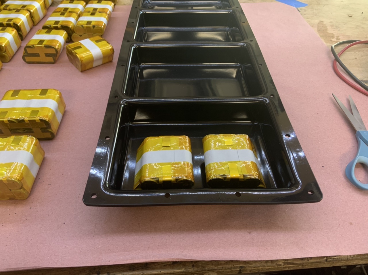

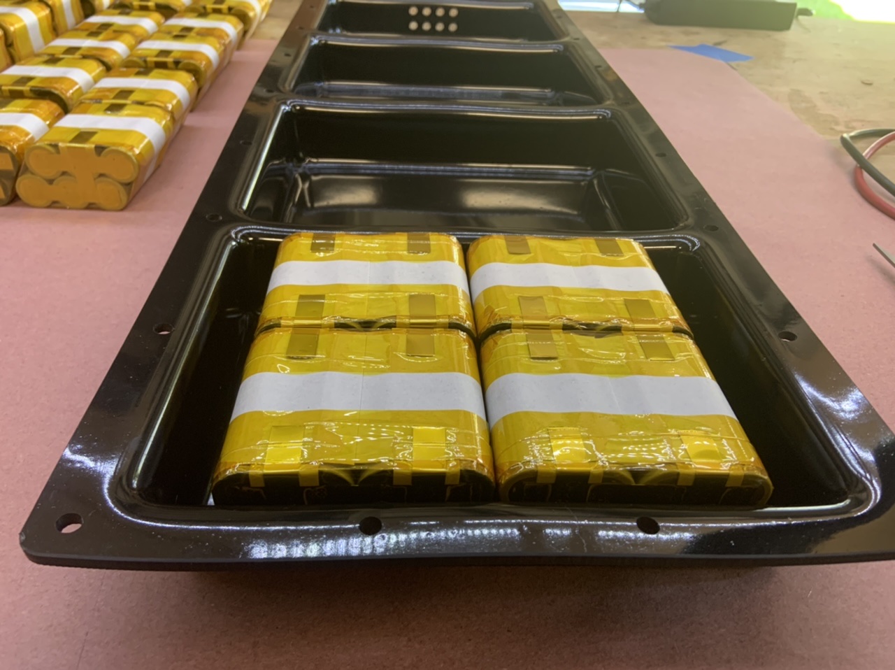

Even for a battery as large as a 12s8p?
I’d recommend some of that rubber on a double stack 21700:
Probably even on the trapezoidal stack 8P which should also fit. This is a trapezoidal 6P:
That rubber: https://www.amazon.com/dp/B00P5VEQ3G/ref=cm_sw_r_cp_apa_i_vDpCFb7638RJ2

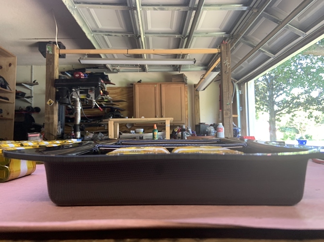

I’m probably going to glue it to the enclosure lip so i can trim it nice and then also use the foam gasket in conjunction with it.
they widened it enough and deepened it but not quite deep enough.
wait a minute… weren’t the larger enclosures on the DIY Edition variant supposed to come with a blacked out deck? or am i imagining that? I’m starting to wonder if i was sent the old enclosure because this is how a trap stack fit in it and my decks had the ice cream on them.
Probably yes, i think only since batch 2 those diy changes happened.
Is there any chance someone could squeeze a 12s12p 21700 in there with a gasket and the Vesc mounted externally?
Only if you wanted a 60lb board :rofl:
Works for me!
On the diy deck/enclosure, each of the 4 sections can fit 36qt 21700’s or 44qt 18650’s. In 4 compartments that 144 21700 cells or perfectly 12S12P. but the layout will be a bit of a pain, you’d need to do 3P groups per section so you’ll have to split groups. The easier use of 144 cells would be 16S9P imo.
